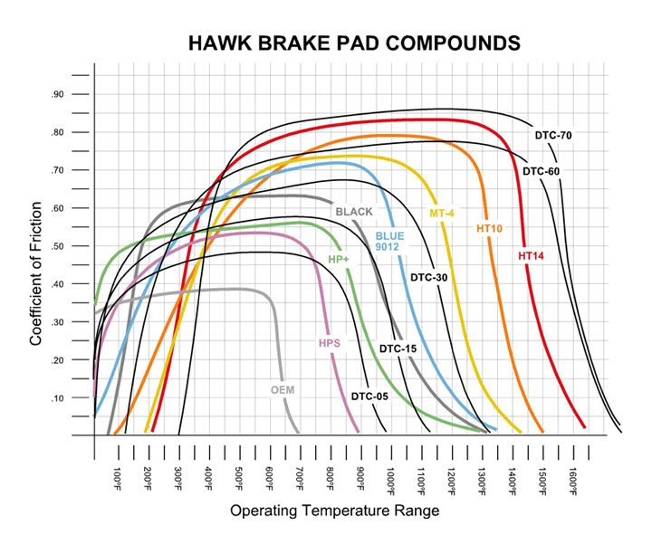

GARDRB Posted September 16, 2025 Posted September 16, 2025 19 hours ago, Rhyscar said: Well I’m limited to Wilwood fitment pads… so hoping cheap ones won’t be too shit? This is based on the fact I’m going to struggle to find a pad that does road driving/sprints and track action. Also I don’t have brake ducts sorted yet, and im looking at going to bigger disc, so unkeen to invest in a $400 pad that’s may be obsolete once I get my setup refined a bit more dads run hawks forever in his ae82 with this brake setup and they work great with no cooling, but absolutely rubbish as a road pad. Kayne Barrie told me he could get me a really good Hawk for my Wilwoods, but I'm not sure if it's a race or road pad. I assume it was a road pad based on the context of the conversation Quote

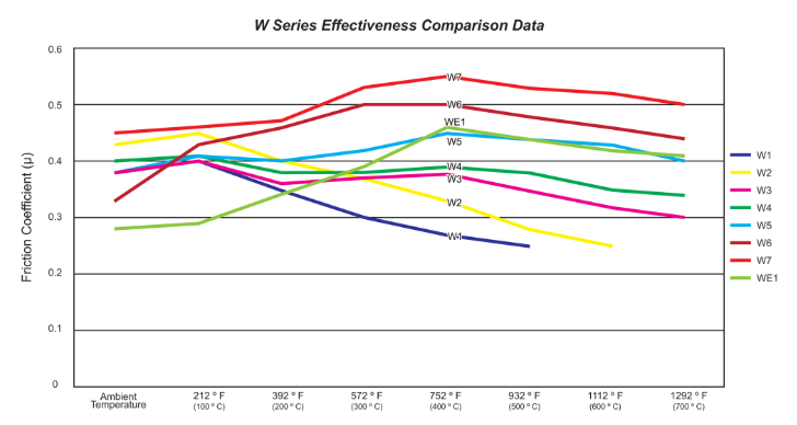

Rhyscar Posted September 16, 2025 Author Posted September 16, 2025 2 hours ago, Truenotch said: I'm running WinMax W1S all round in my Legacy and they're awesome. I can't cook them on the Coronet Peak downhill, they were great at Teretonga and they work like normal pads for regular driving. You could probably go for W2s. Oh man just took a look and the info provided by HPR on winmax is amazing at helping select right compound. Looks like W3 would be an ideal starting option, with W5 a good track option. https://paddonrallysport.co.nz/find-your-brakes/ 2 Quote

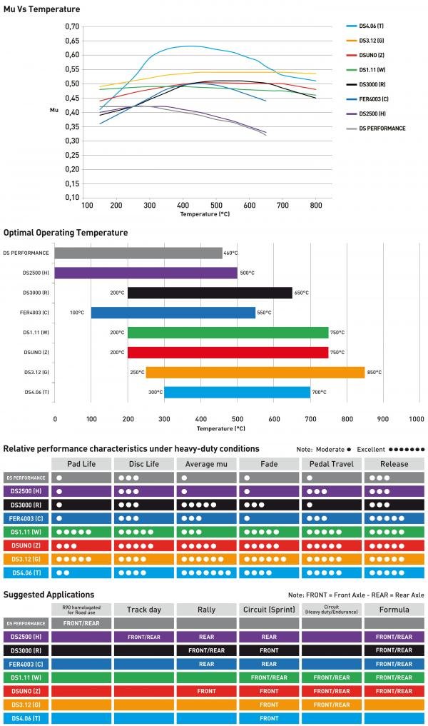

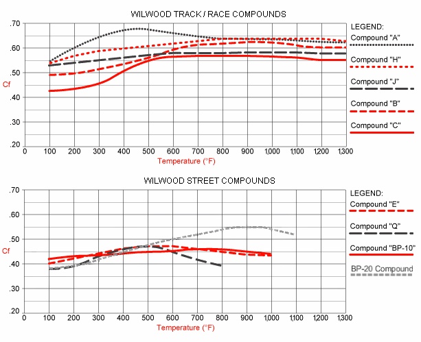

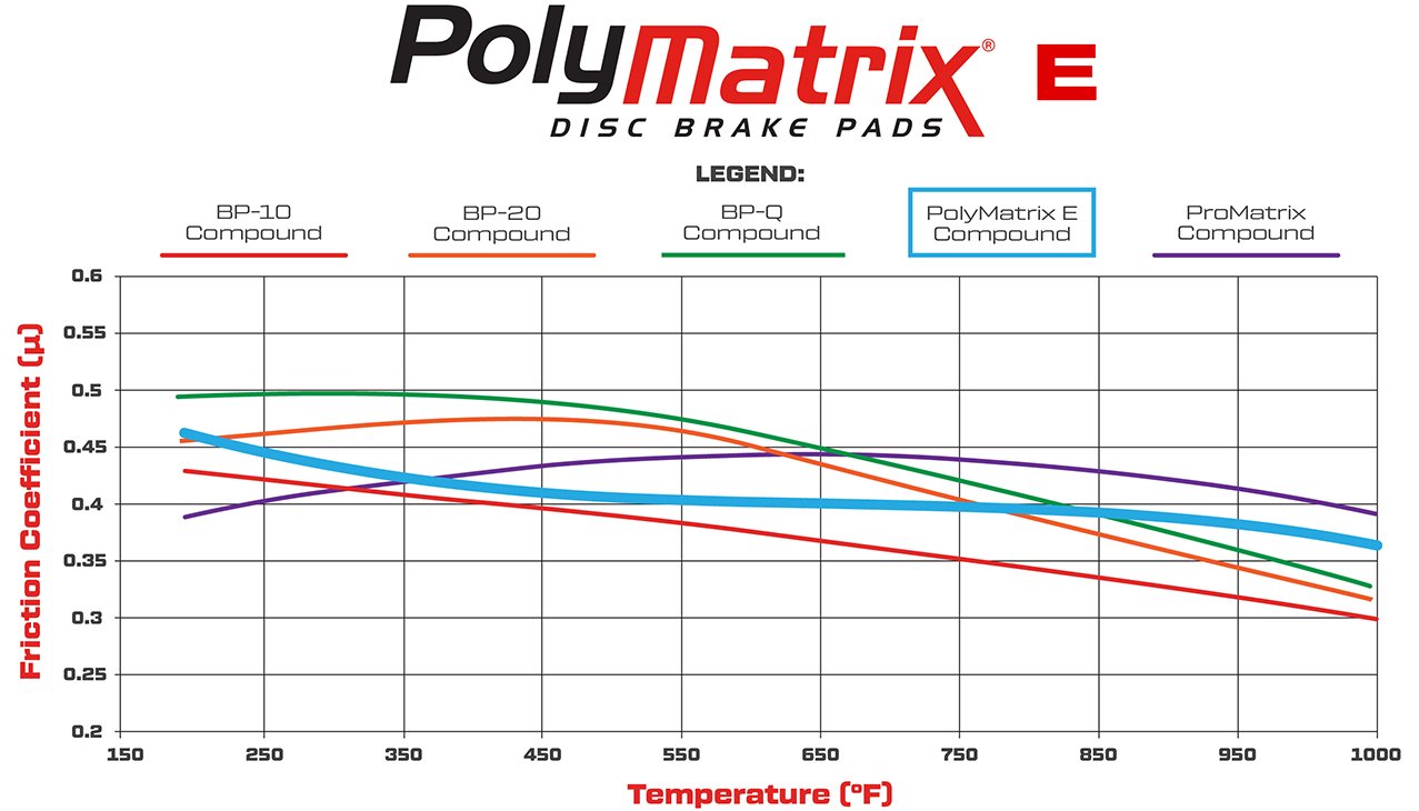

Hyperblade Posted September 16, 2025 Posted September 16, 2025 1 hour ago, Rhyscar said: Oh man just took a look and the info provided by HPR on winmax is amazing at helping select right compound. Looks like W3 would be an ideal starting option, with W5 a good track option. https://paddonrallysport.co.nz/find-your-brakes/ So many people don't understand brake pads and just go off one temperature number, those graphs are so useful to working out how they behave!. Most brands have them it's just a matter of hunting around. Wilwood Ferodo I run W5 front and W3 rear on the starlet, originally ran W6 on front but because of trying to sort out overheating dropped to W5 which didn't help, so I probably should go back up to W6 again. I've had no issues with them and they work well when in the right temperature range. 1 Quote

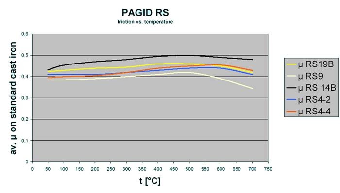

mjrstar Posted September 16, 2025 Posted September 16, 2025 I'm a bit of a fan of the not particularly well known carbotech, I run an xp8 which is OK from cold, and I find works well when hot. I'm doing short hillclimbs so it's not like multiple laps at a track, with max run time of a bit over 5 minutes, you can use them for limited street use, but I wouldn't commute on them daily. I've had more aggressive pads with greater thermal gradient which I found worse when trying to apply the brake right up to the grip threshold of the tyre. (Endless) I've heard a lot of people talk about how flat the curve is on the pagid pads so it'd be one id consider. You kind of need to consider how agressive the pad is vs you level of booster, and pedal effort as there is no point in have super high coefficient of friction if there is not a wide window of pedal pressure modulation available for different situations. The inverse also applies, you Dont want a sore leg from having to apply 100kg's of pedal force to get your car to stop either. 3 Quote

mjrstar Posted September 17, 2025 Posted September 17, 2025 On 16/09/2025 at 13:28, GARDRB said: Kayne Barrie told me he could get me a really good Hawk for my Wilwoods, but I'm not sure if it's a race or road pad. I assume it was a road pad based on the context of the conversation One thing with certain hawk pads they can be very sparky, which is cool I guess if you want to put on a show, but less cool if you care about the finish on your wheels. Hawk do have some pretty potent compounds if that's your thing. 1 Quote
Honda Ass Dragger Posted September 17, 2025 Posted September 17, 2025 Winmax pads are brilliant, the Alcons I have on the Civic came with Hawks - but they were way to aggressive for street driving so I ordered a set of Winmax W3 via PRS and so they they have been great been nearly 3 years and not showing any huge signs of usage work great on street and at track so far 2 Quote
Rhyscar Posted September 17, 2025 Author Posted September 17, 2025 5 hours ago, mjrstar said: One thing with certain hawk pads they can be very sparky This is actually a valid concern for doing sprints/targa etc. Starting a bushfire would not be a fun experience! Thanks for all the experience offered, I'll have a chat to PRS and get some for the wilwoods and Lexus. I've heard good things, just haven't used Winmax yet. 1 Quote
