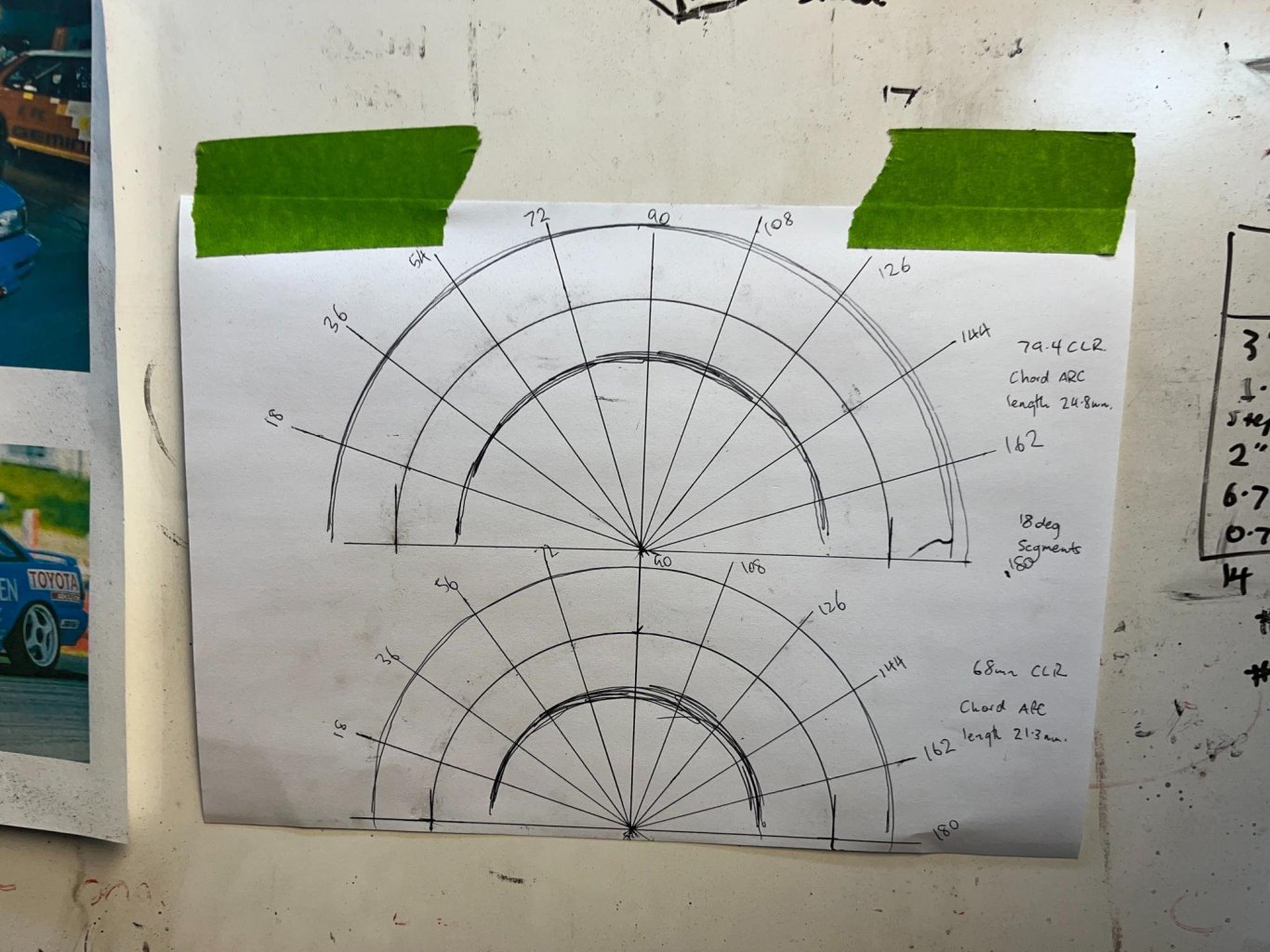

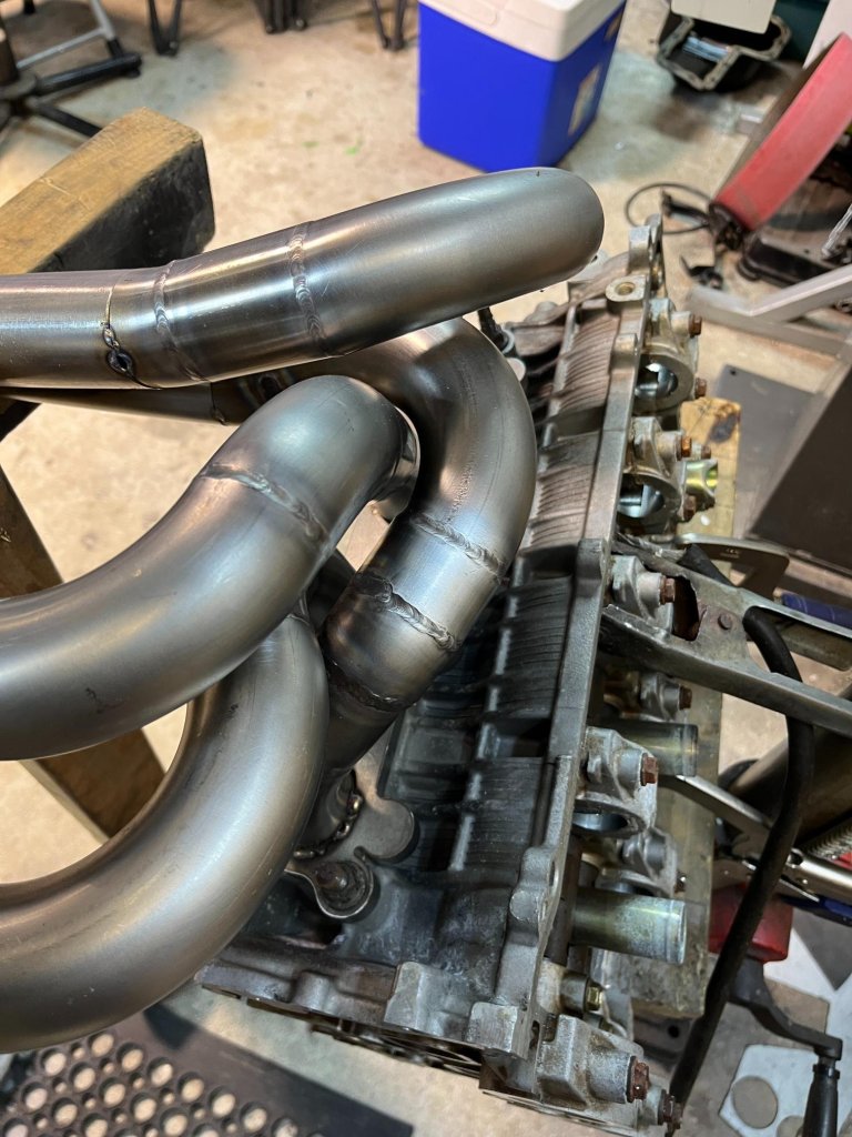

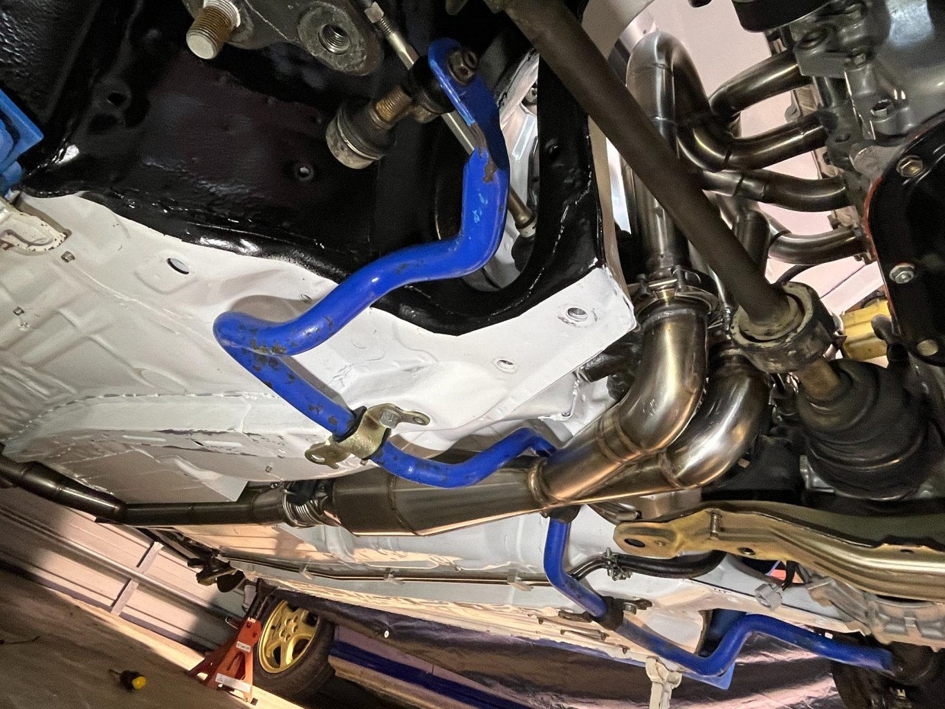

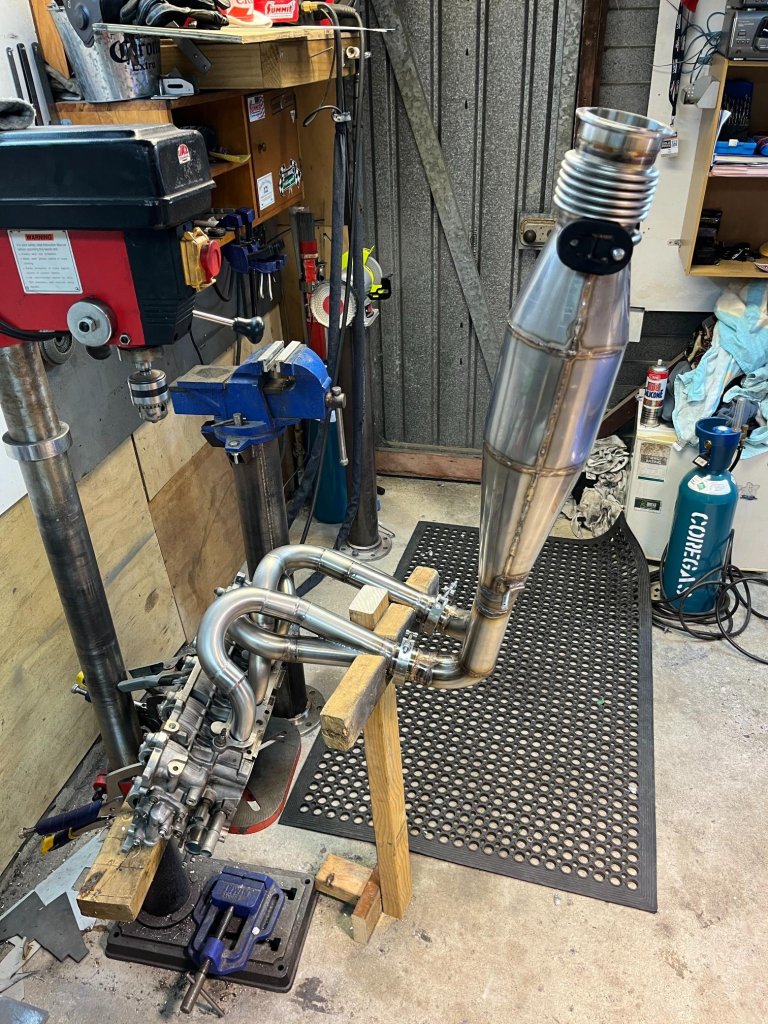

I’ve worked on afew cnc tube benders in the past. You are limited with them to do longer radius bends Depending on which die you have and also not being able to do compound bends and also distance between bends usually needs to have a small straight between them.
great for making exhausts though!
Yeah this is exactly what I’ve found. They need silly gaps >100mm between bends to re-clamp before the next bend.
So I’ll do it the old fashioned way.
On a twist of fate I’ve also found the tube I have is different centre line radius to my kinex blocks. This is helpful for fitment but makes my primary lengths out as a 180deg bend is like 80% the volume of the larger CLR.
Im planning to use my daughter’s sandpit sand as a measurement of volume to double check everything before I weld…

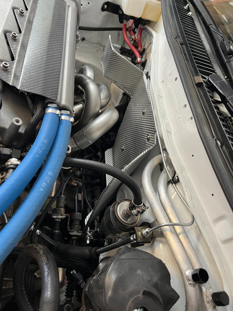

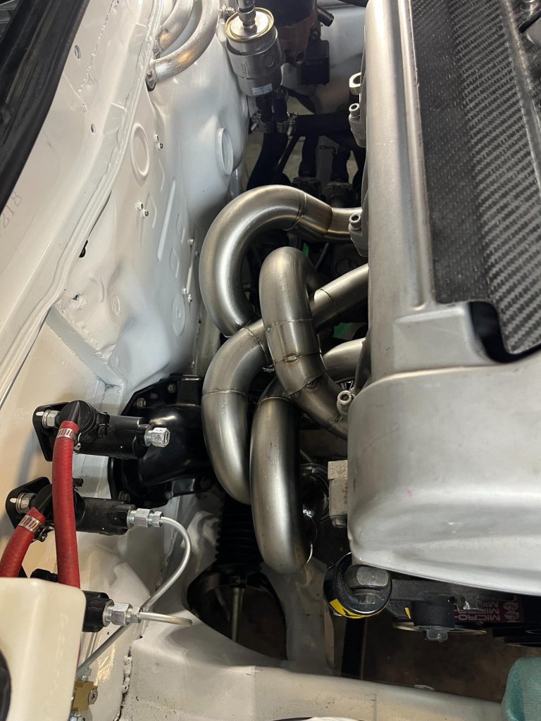

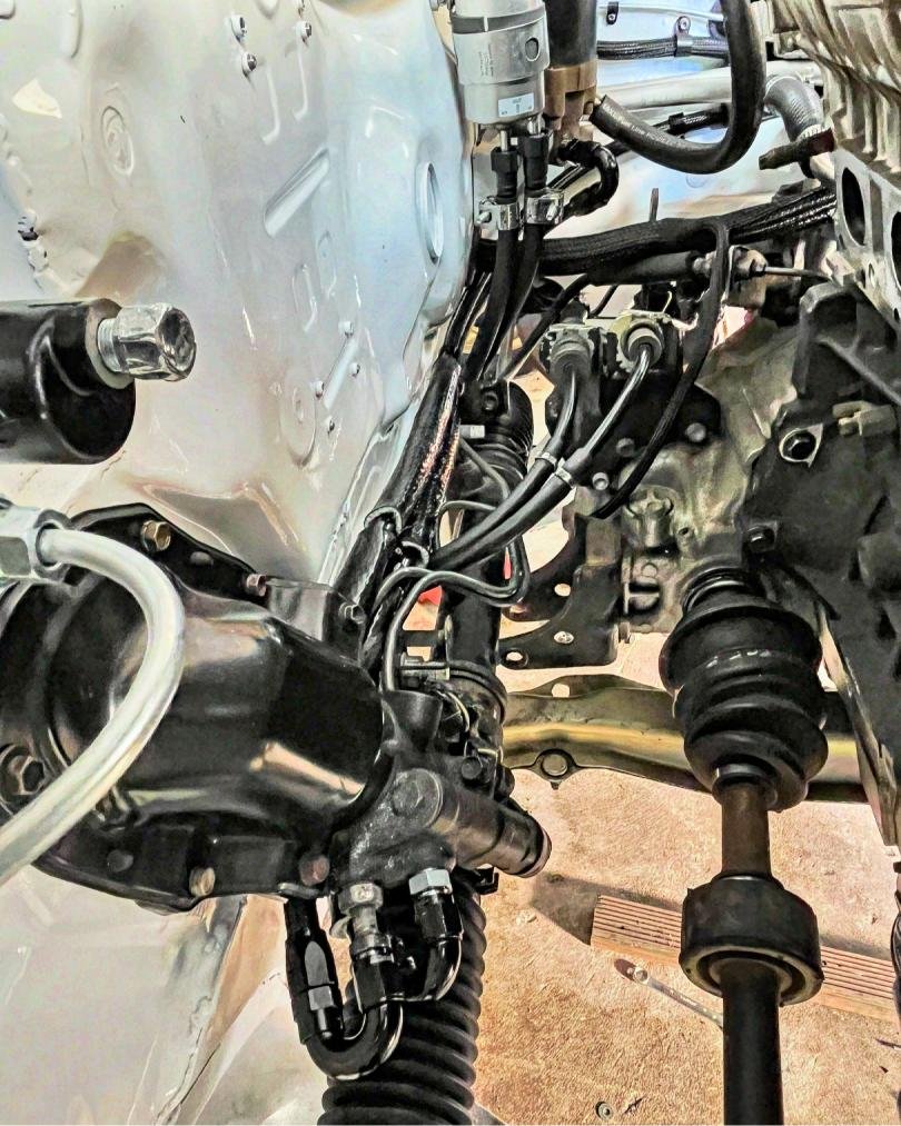

Before the headers went back in, I wanted to get the powersteering lines sorted as they are almost impossible to reach with everything in place.

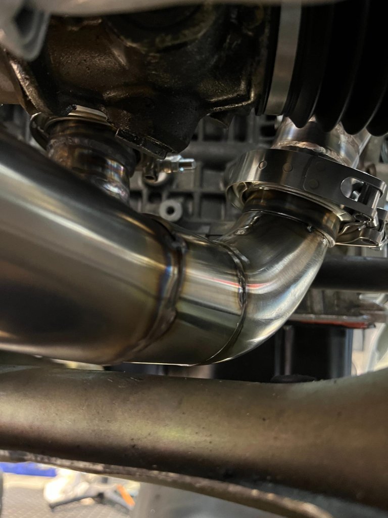

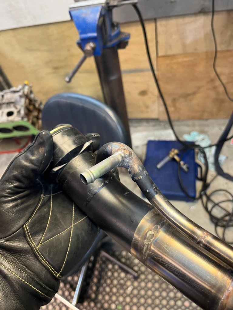

I'm using a SW20 MR2 electric powersteering pump. Hose shop couldn't re-purpose my factory fittings into a new hardlines so had to go braided. Have seen a few racecars using this setup and seem to be reliable. As it turns out getting aftermarket fittings to suit this and the rack is a complete pain in the arse! But got there eventually. But for the rack return fitting, I ended up having to weld an AN fitting onto the factory fitting to make it work.

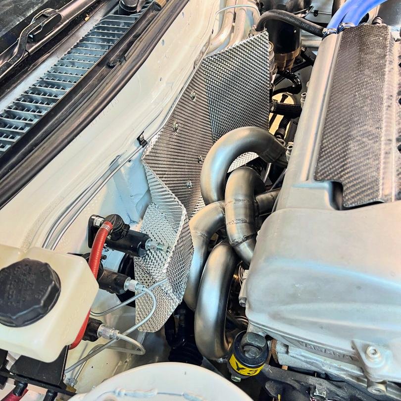

Running 200 series teflon-lined hose for high pressure (apparently these run at 700psi). Mounted some p-clips on a small ledge then double-clamped the return hose. Applied copious amounts of heat shielding to try deflect exhaust heat.
Very happy with how the routing worked out. Turns out there is the perfect amount of space behind the steering shaft for lines to run.
Last job is to mount the power steering cooler to complete the system. I always had PS boiling issues with this car. Maybe driven too hard, maybe rack has always been shit? Dunno but going over the top to try solve it.

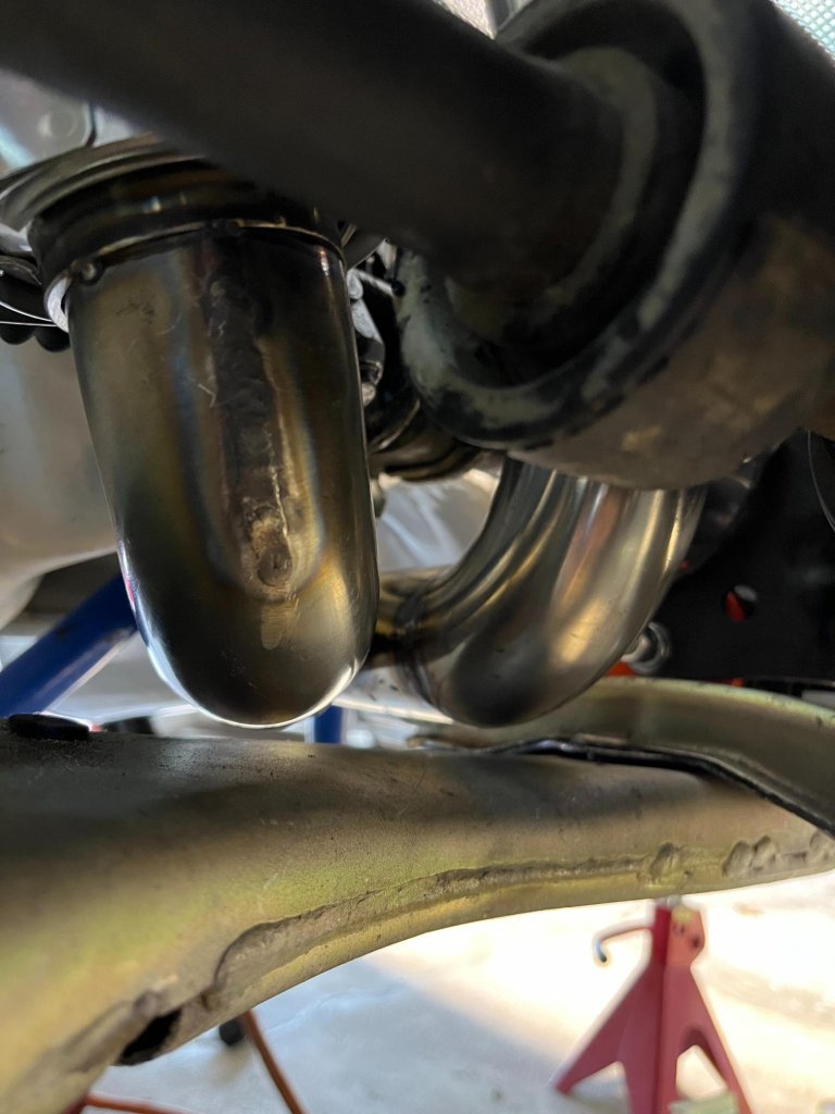

@shrike yeah that is the plan eventually as the roll centre on this car is HORRIFIC at this ride height… but that will need to wait for another day as getting custom subframes and geometry is a massive exercise with lvvta. (And not one I want to tackle at this stage)

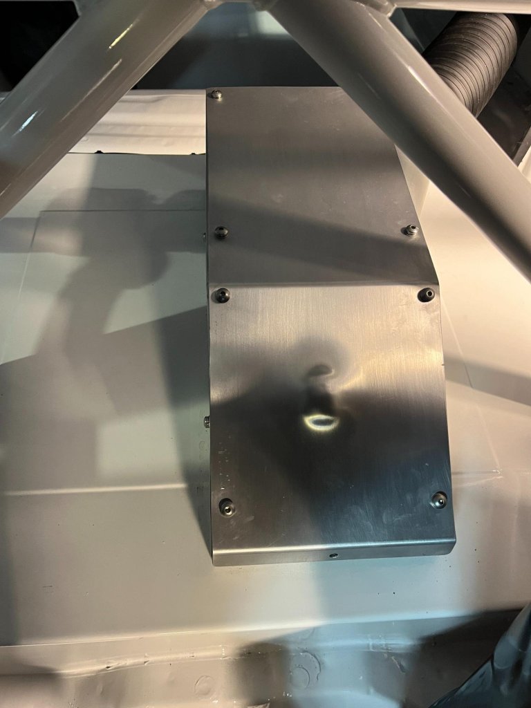

I considered a dent, but again from cert perspective doing it properly is the right thing to do. It’s only another 4-5hrs to sort it out properly so may as well be 100% happy with the solution.
