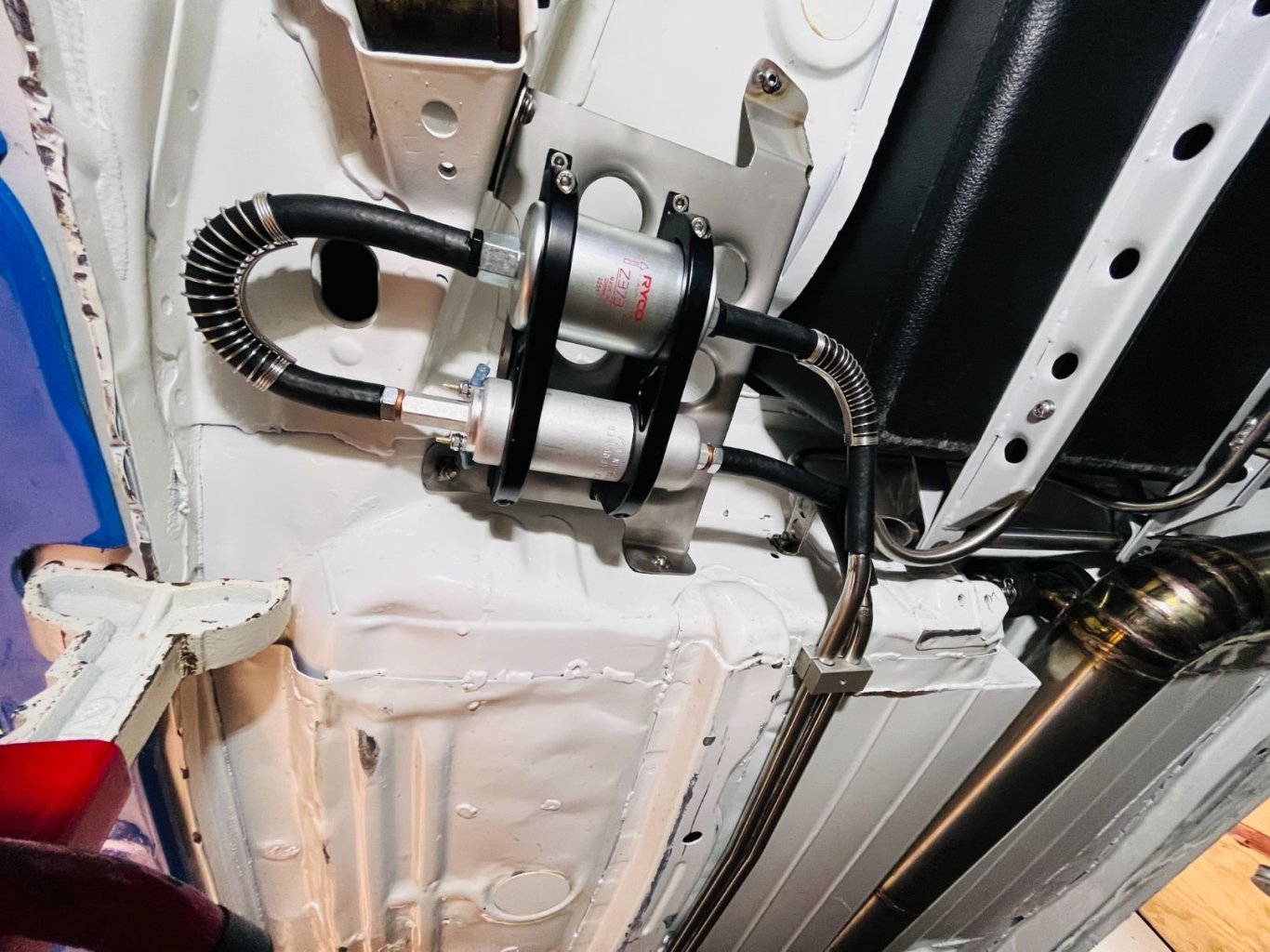

though i would suggest you consider clamping them to AN fittings if the intention is that they are to be "regularly" removed. this comes from my experience in aviation but really youd probably be fine with both options, just give it a think/price up the fittings.
this is a super cool car btw, havnt commented much/at all but been following, keep it up
edit - i just went back to look at the pump rig, that one serrated hose tail, if the hose is sized correctly should be very hard (sometimes ive had to cut them off) to remove even unclamped, just another thing to add the mix. the black single flare style one will be less grippy with tradeoffs in security ect.
Ah interesting. What’s the advantage of AN style hose barbs? To be honest I struggled to find anything that matched the thread on the fuel pump and fuel filter so just got what I could.
I still do need to add a couple of unicoils on the bends so it doesn’t go soft and crush over time. I used super high quality fuel hose which was a lot more flexible but still a little nervous about it.
https://www.repco.com.au/parts-service/cooling/hoses-radiator-heater/unicoil-hose-spring-19mm-uc34091/p/A9635372
Yeah the stainless hose barns are super hard to get off. Everything is either 1/2” or 1/4” which makes it super easy.
Thanks man, appreciate the support and info. It’s good to share ideas and get input. Sometimes I worry I overthink these solutions
its not so much the benefit of the AN barbs, they are basically the same.
the benefit would come from having an AN b-nut and flare fittings, which have be undone with basic tools.
you have the exact parts on your fuel tank so i expect the following will be telling you how to suck eggs, but ill post it anyway incase its just a cant see the forrest for the trees moment. im guilt of that alot.
you would install the hoses/fittings like this
Buy Fuel System Components at KLG Auto Online Store
and there should be some adapters like this to go from whatever the pump and filter threads are to the AN standard, which would look like this or thereabouts.
400lph Inline High Flow Fuel Pump | AEM 50-1005
there are a few different options for the hose fitting from just a basic hose tail to a more involved self crimping/clamping system, but that often requires a special hose, they are really good but ive not personally used those systems. (speedflow is a common one)
AF403-04 - 90 DEG PUSH LOCK END -4AN200 Series Aluminium 60 degree Hose End | SpeedflowDirect - Speedflow Hose  & Fittings Online
Ah yes I understand you now. I actually stayed away from AN and braided hoses for cost and pain in arse factor. Hence the stainless hardlines and rubber hoses to join.

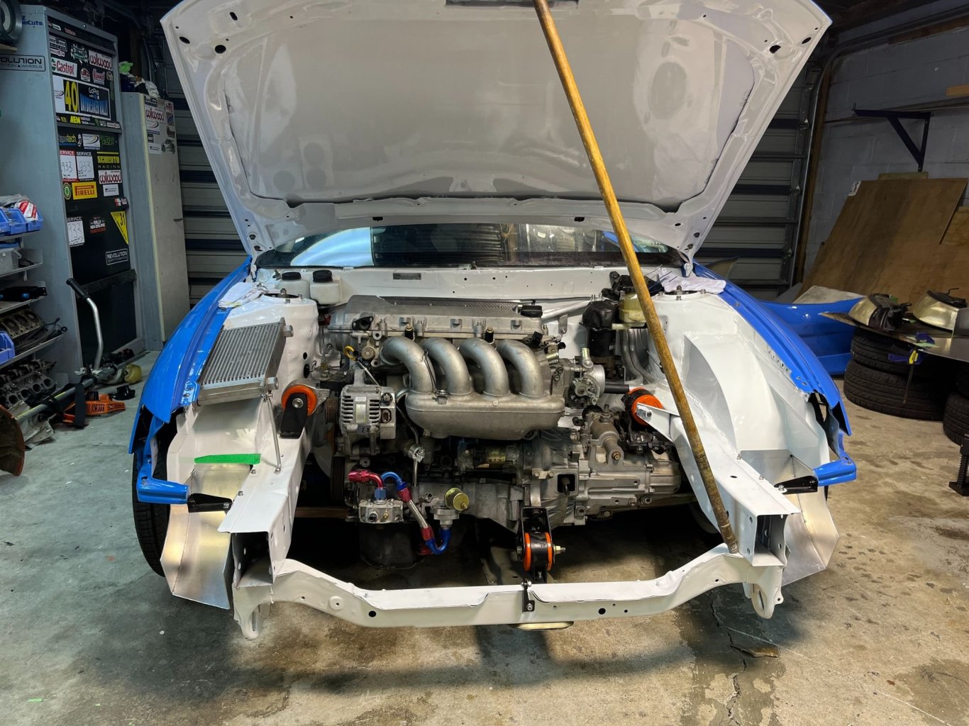

Engine back in the hole. Had to fight the polly bushes to fit properly but got there in the end. Added a HD exedy clutch and gave flywheel a skim when it all went back together.
Decided not to run the ITB's to start with as I don't want to cut the bonnet and I need to cut/shut the CNC manifold to make it fit under bonnet. All achievable, but a big mission so not wanting to slow myself down.
Got a few electrical parts to start fabbing mounts/buttons, fan shroud etc. I'm excited to be getting things moving.
Kinda dig the front off look. Got a massive pile of parts to go to powdercoaters so once thats done then lights etc will go on for good.

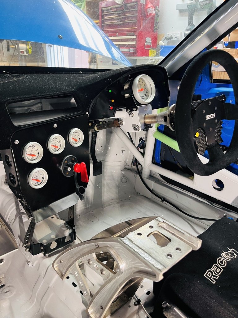

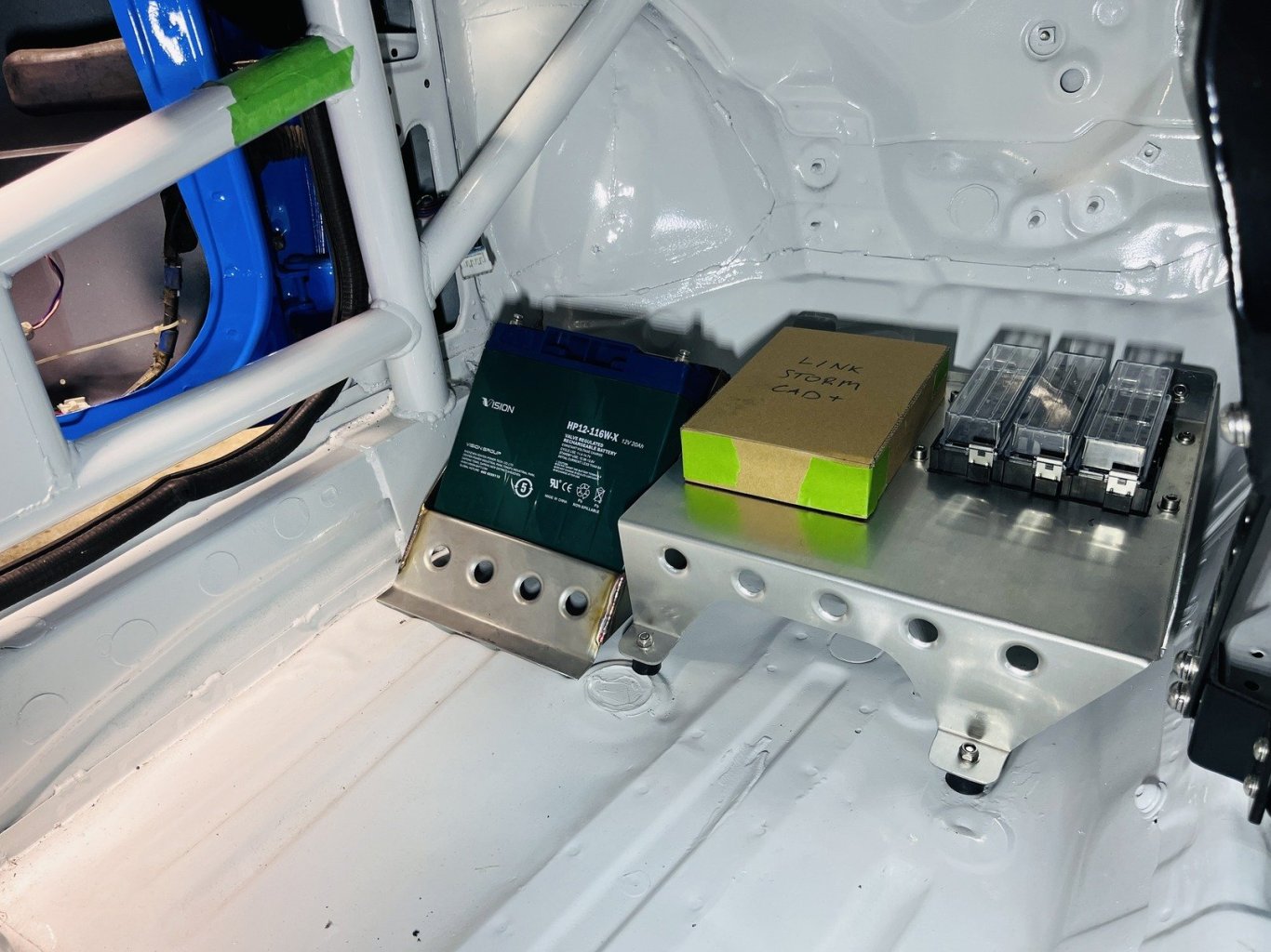

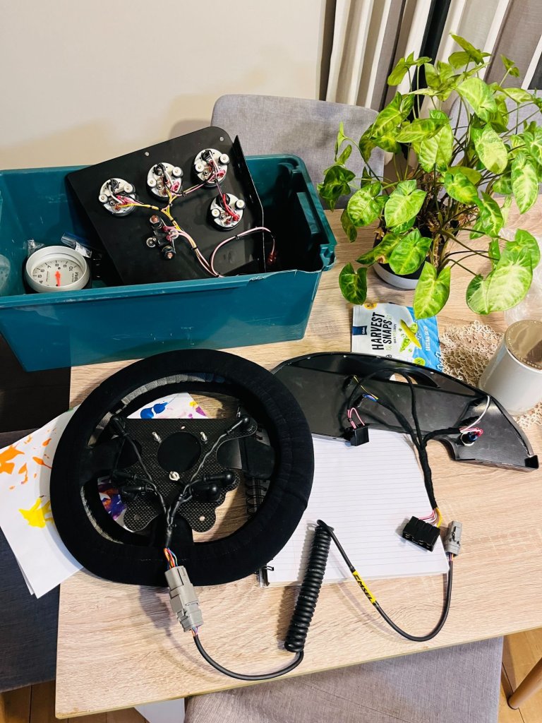

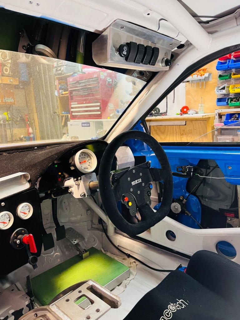

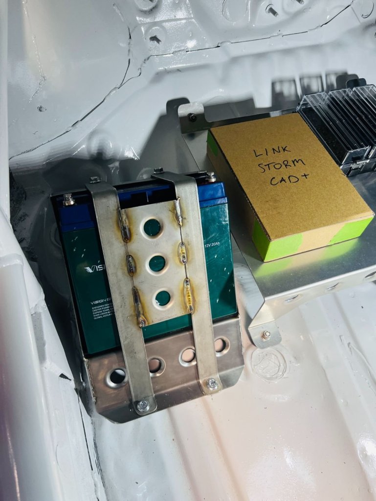

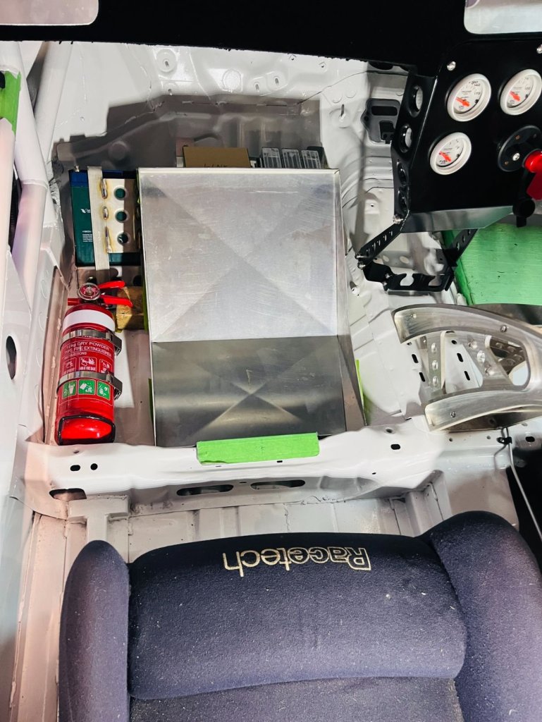

Due for a bit of an update here. Finished off battery mount, passenger footplate and switch panel. Drew is making headway on the chassis harness too.
Switch panel design is quite neat and includes all the start/stop and major controls for the car, with the rest on the steering wheel. Racked my brain for ages to figure out how to mount without lots of fasteners. Made some little tabs that slot into a receiving plate. Should make it easy to pull apart/troubleshoot in the future if needed.
IMG_5248.thumb.jpg.51d8491b7463e0ed984c3800512a7834.jpgIMG_5254.thumb.jpg.42b96aa6f9e1e750a9d256ad510fb552.jpg

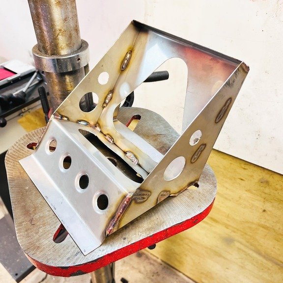

Welded up a co-drivers footrest. Came out nice. Need to resist putting my feet on it and scratching it until it's powdercoated though!
Also, how good does the fuel pump setup look with unicoils to support the rubber hose? A++

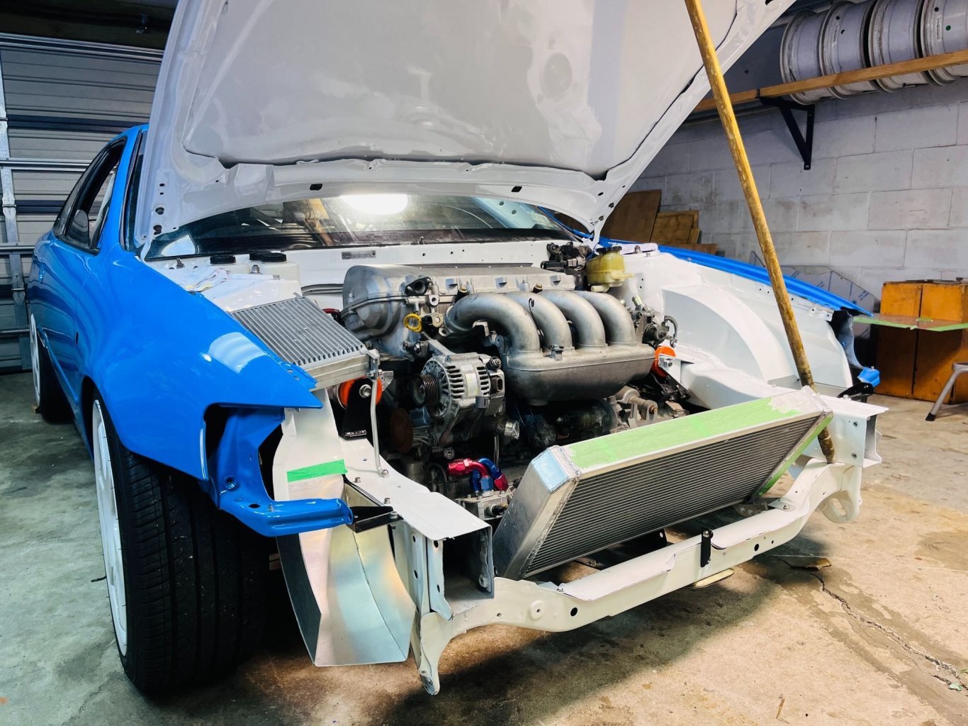

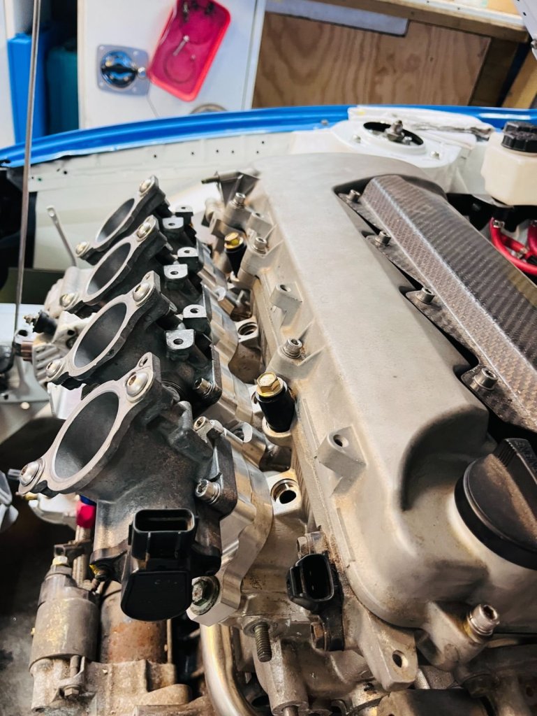

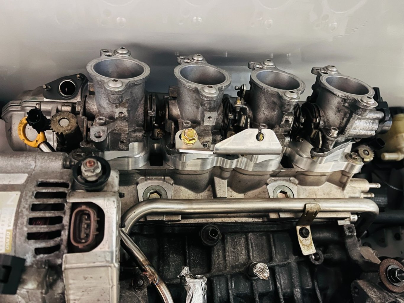

ITB's have made a comeback into the project plan as I've quite easily solved a couple of the headaches they were giving me. I'm quite happy about this because induction noises are great.
SQ-engineering do a pull-down throttle bracket that relocates the pulley to use one of the TB shafts rather than sitting on top; Freeing up space for the fuel rail.

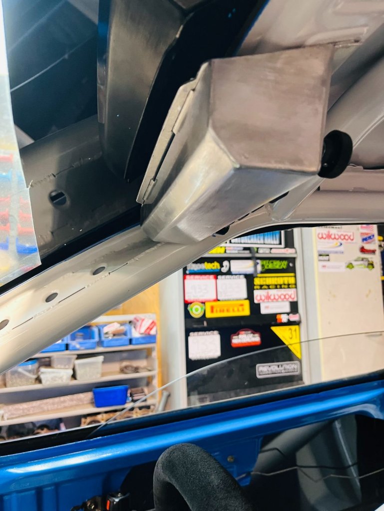

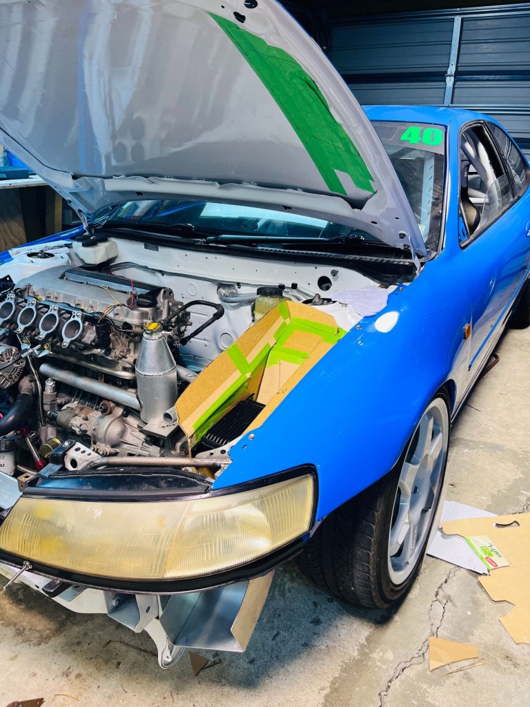

So clearance to the bonnet is very tight. I've adjusted the drivers side mount (with a grinder) to lower the engine another 6-8mm or so. I'll also skim some mm off the manifold on a angle to pick up a bit more clearance. Despite this, I will need to custom print some funky-shaped trumpets to make it work with no bonnet mods.
Here's my clearance for the fuel rail. Still working out an exact plan here but seems achievable.

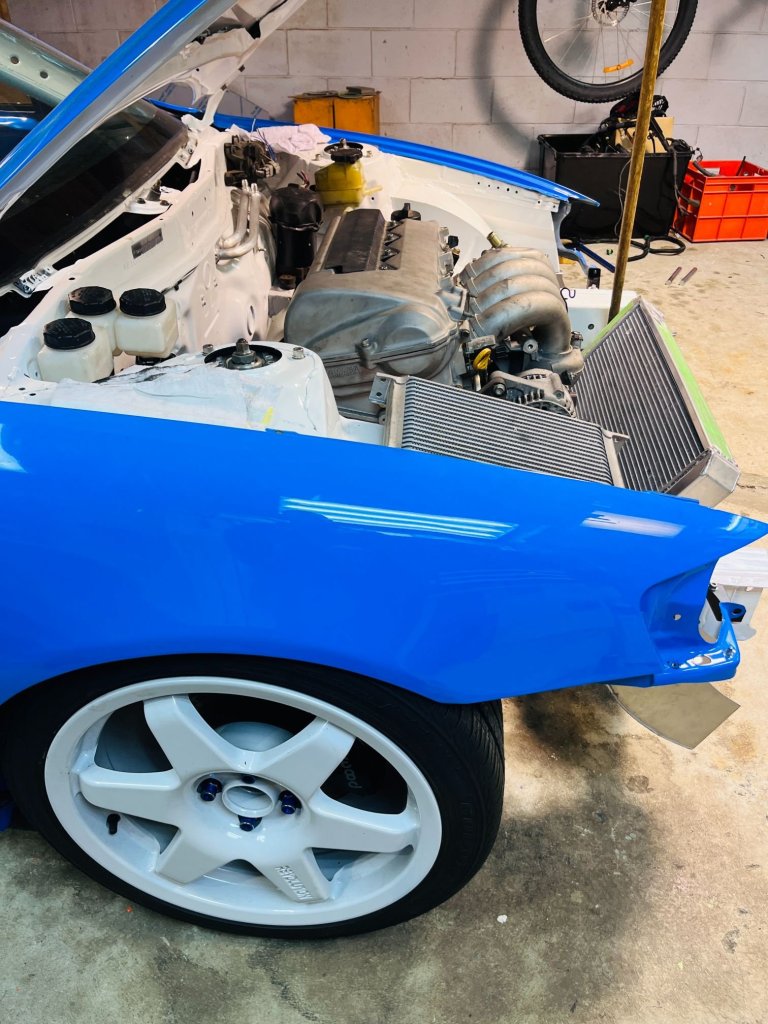

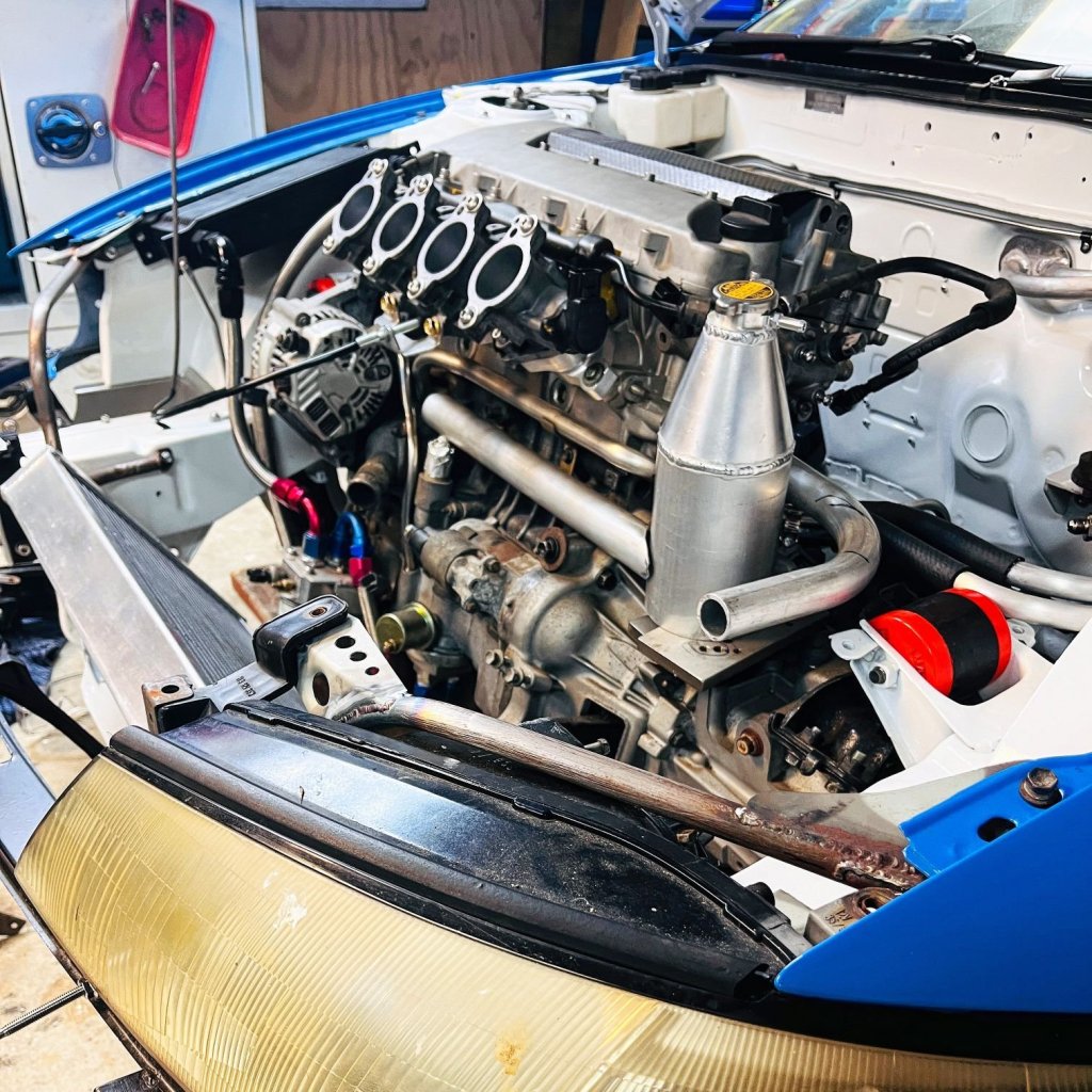

Next on the list is sorting out the engine cooling system. The 2zz cooling system works the opposite way than I thought, which is a bit of a mind-fuck with a dual-pass radiator. Anyone have experience or handy diagrams for a dual-pass radiator? I'm assuming Hot in the top and cold out the bottom like normal? How to bleed/prevent air bubbles has me a bit stumped as my swirl pot/fill point will be on the hot side (right side as it comes out of the head).
I've also got a massive list of fabrication jobs all required to mount the radiator fans...
