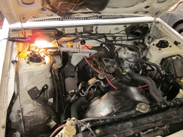

so the exhaust is going to be a massive pain in the arse to make.
check the picture of the turbo (further up the page) and notice the angle that the exhaust exits the turbo.........
now have a look at pics of my engine bay.
the exit off the turbo is heading for my brake booster/reservoir. it is going to be very tight in there.
