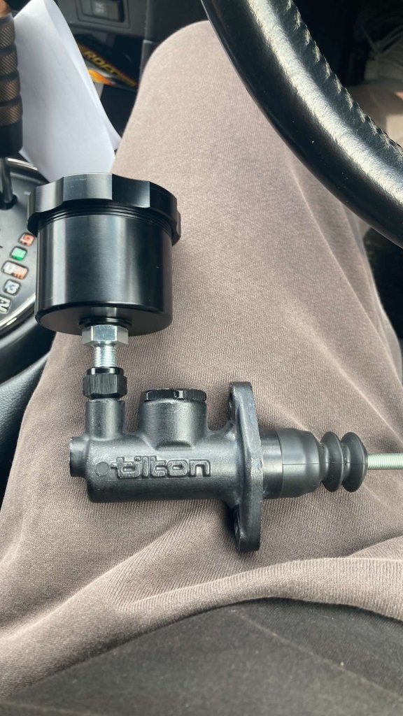

14 hours ago, GARDRB said:
So I went and got an adapter to screw it into the AN3 front port instead of the AN4 rear port
458245227_1516892745600145_7788126614376991520_n.thumb.jpeg.c0e0c4e20e30e1bc83bbe8133044766f.jpeg
Both those rear ports are outlets only the front port in an inlet
Yeah good point, I misread the instructions, it didn't make sense to me that that could be an inlet, must have been their use of "rear" on what I would consider to be the front of the cylinder because it's facing forward. Back to the drawing board.
