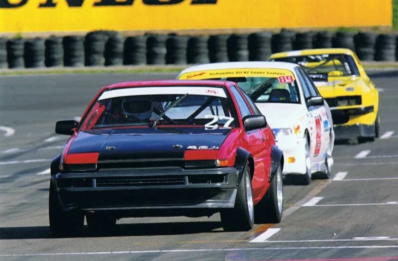

Found some pics that dad took of the car in the 90's at the onekawa st sprints in Napier.

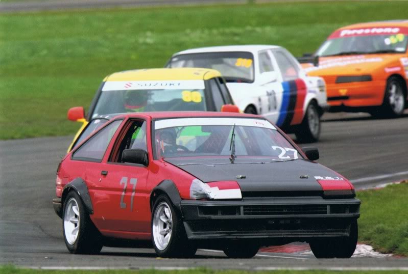

Had a trackday in the weekend, it was good fun. Track was dry but slippery, and the drifters didn't make it any easier.
Pics:

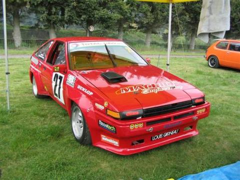

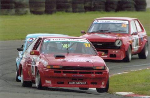

Got sent some pics of my car and scanned them in. Theres a few from last years rounds and some from round 2 this year.
This ones going in the Log book:
