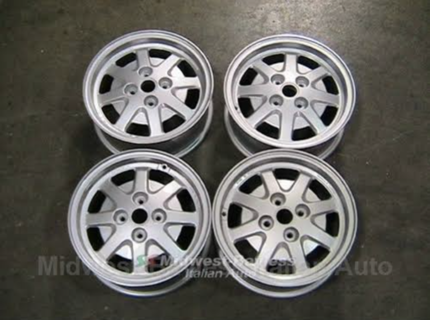

Alfashark Posted May 27, 2024 Posted May 27, 2024 Probably thin on the ground now, but 33s had a nice simple 14" pepper pot alloy, with Series 3 QVs having a 14" with "spokes" and larger teardrop shaped slots. Quote
ThePog Posted May 27, 2024 Posted May 27, 2024 6 minutes ago, Alfashark said: Probably thin on the ground now, but 33s had a nice simple 14" pepper pot alloy, with Series 3 QVs having a 14" with "spokes" and larger teardrop shaped slots. I thought these were what the Maserati ones were at first glance, not quite as sexy without the dish and I think the offset is problematic. A chap just down the road has some of these; But again the offset isnt great... Quote

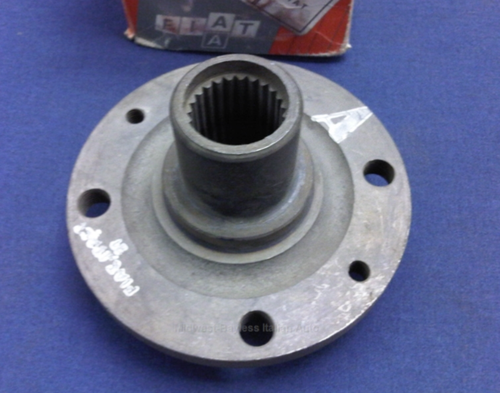

shrike Posted May 27, 2024 Posted May 27, 2024 31 minutes ago, ThePog said: Yea the options should be way better, bit so much dicking around to get to the point where 4x100's would bolt on. I am guessing that certing it would be on the cards... Altho if I was going that path there would be a few other things to get signed off a well.... Depends how you do it and if anyone would notice I guess My Ae111 5x114.3 conversation uses all factory toyota parts that bolt on so looks factory (well it would if it didn't have massive brakes etc) What do the factory drive flanges/ wheel flanges look like? Quote
ThePog Posted May 27, 2024 Posted May 27, 2024 7 hours ago, shrike said: Depends how you do it and if anyone would notice I guess My Ae111 5x114.3 conversation uses all factory toyota parts that bolt on so looks factory (well it would if it didn't have massive brakes etc) What do the factory drive flanges/ wheel flanges look like? Thats the rear, the front has a spindle rather than a splined hole but the flange detail is identical. Those holes are tapped M12x1.5, I wonder if they were converted to a press in stud if the bigger hole 1mm outboard would clean up all the threads. Looks like a bigger hole further out might get a bit close to the edge of the flange tho... Quote
shrike Posted May 27, 2024 Posted May 27, 2024 3 hours ago, ThePog said: Thats the rear, the front has a spindle rather than a splined hole but the flange detail is identical. Those holes are tapped M12x1.5, I wonder if they were converted to a press in stud if the bigger hole 1mm outboard would clean up all the threads. Looks like a bigger hole further out might get a bit close to the edge of the flange tho... Yeah not much meat to work with, you could always mark out where 4x100 would locate and see if its doable Adding more material would be tricky and potentially obvious Whats the spline count inner and outer bearing diameter With the Ae111 I could swap to Rav4 as the bearing inner diameter was the same and the rear Im using bolt on bearings with the drive flange from a highlander (FWD was Camry from memory) Just wondering if there is another car that might work Quote
ThePog Posted May 27, 2024 Posted May 27, 2024 21 minutes ago, shrike said: Yeah not much meat to work with, you could always mark out where 4x100 would locate and see if its doable Adding more material would be tricky and potentially obvious Whats the spline count inner and outer bearing diameter With the Ae111 I could swap to Rav4 as the bearing inner diameter was the same and the rear Im using bolt on bearings with the drive flange from a highlander (FWD was Camry from memory) Just wondering if there is another car that might work There is a dedicated X1/9 forum that has been going for a long time, there is a lot of discussion of the problem and no one has mentioned such a possibility. Modding the hubs would be a cert issue, and I would wrap it up along with a whole lot of other mods if I went that way. If that is the case then some bolt on adapters is probably a better bet, 20mm thick gets me into FWD offset territory. Quote
