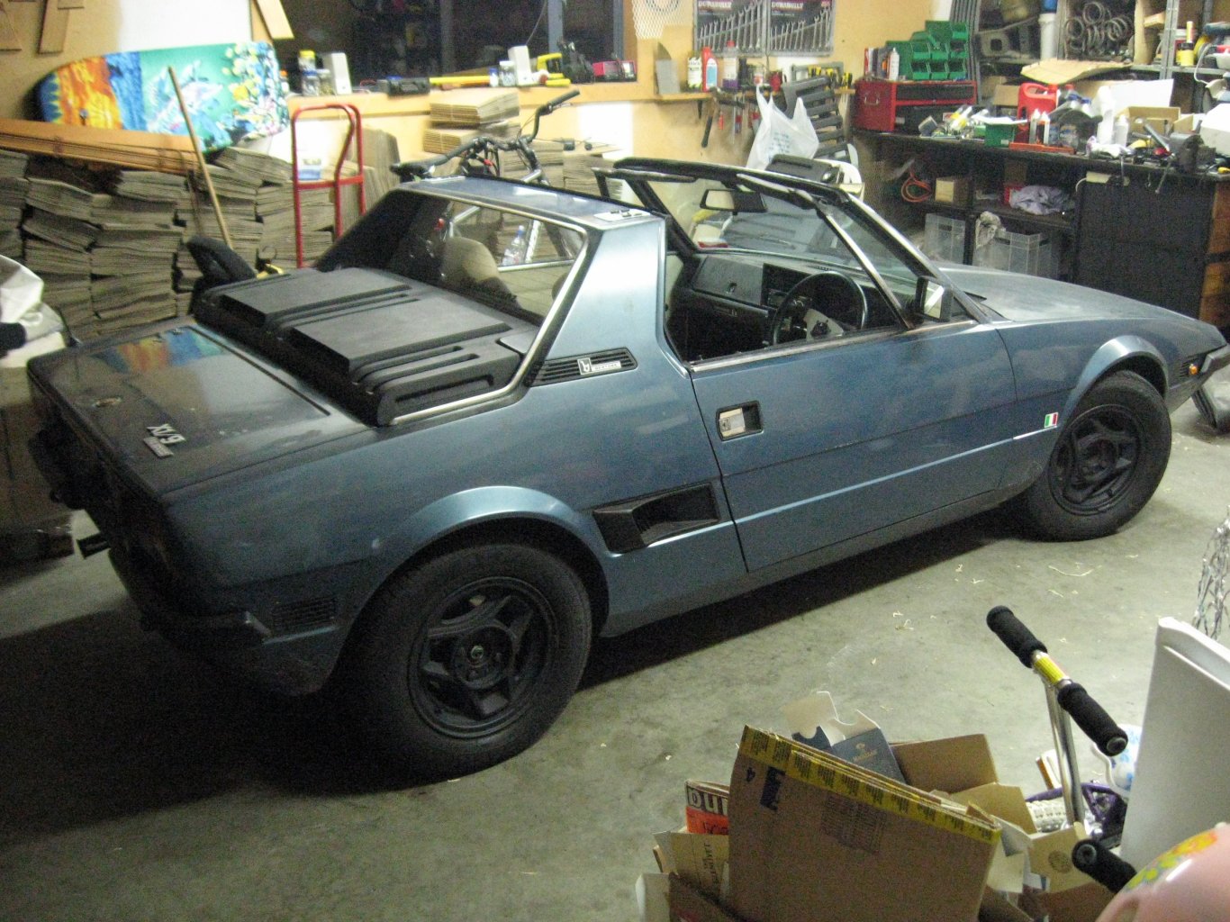

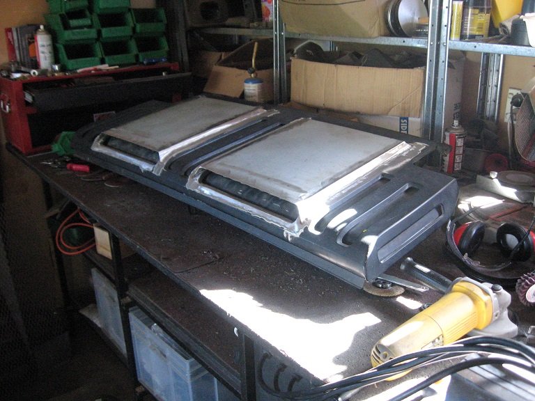

Picked up another engine cover yesterday, hacked and welded today. I had already cut half the height out of the pods as it looked so arse. I fully welded the bitches on so then had to spend some considerable time grinding and smoothing the welds back, I may still need to smear a bit of poo down the joints to make it look a smidge better. Bit of barbeque paint and will be done then.
  • Replies 192
Put that shit on, but first I checked the temp of the airbox, which fluctuated between 50 and 55 degrees. I swapped the covers and checked it, and it fluctuated between 50 and 55 degrees. A worthwhile result....
I will hack more out of the inner skin though, and it did cool down a lot quicker....

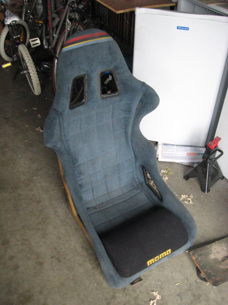

Borrowed a kevlar race seat off a mate for the up and coming track day, so I don't get a sore elbow from bracing myself going around the bends... it came out of a Peugeot race car that was raced by Peter Brock at bathurst, so I will be channeling the awesome obviously.
It took about half an hour to mount rails to it as the rail spacing in the car is 350mm, and the bolt hole spacing on the seat was 345mm so I simply had to ****cough**** ......sorry what was I saying?
I had ripped some rails from the seat of a Fiat 850 sport that I helped chop up a couple of weeks ago, as these turned out to be the same profile as the X's, this meant I didn't have to find a set of impossible to find X seats and cut them up to get the rails...
Looks pretty awesome in place, and is low enough for my helmet to clear the hoop thing behind my head - which is good as I have terrible trouble keeping my helmet from banging shit.... :wink:

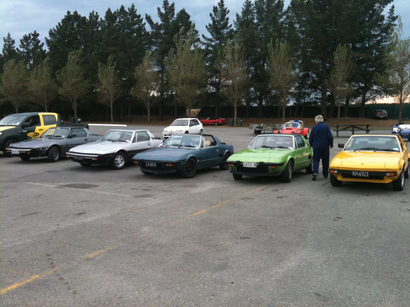

Just finished track day, was awesome fun. I had emailed as many people in the X1/9 Register a couple of weeks ago to see if I could get a good turnout of X1/9's - it worked alright, at one point there were 7 parked up.... not all were racing but there were at least 5 that did;
I only lasted for the morning session unfortunately as quite a lot of oil started to get blown out of the crank seal :rolleyes:
This coated the pulleys and cambelt so i thought it best to call it a day...
Up till then it was going really well, discovered that the best method at the hairpin was full noise sideways 8) . Scared myself with a couple of tankslappers too. Didn't get to see how fast I could get down the straight as I only ran the morning short courses...

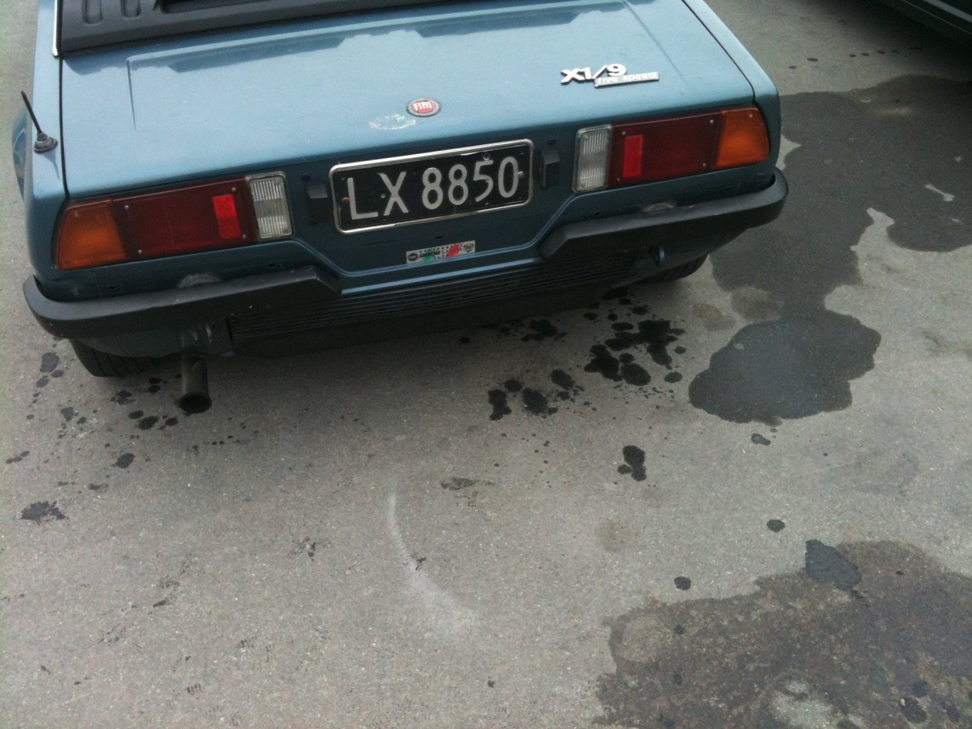

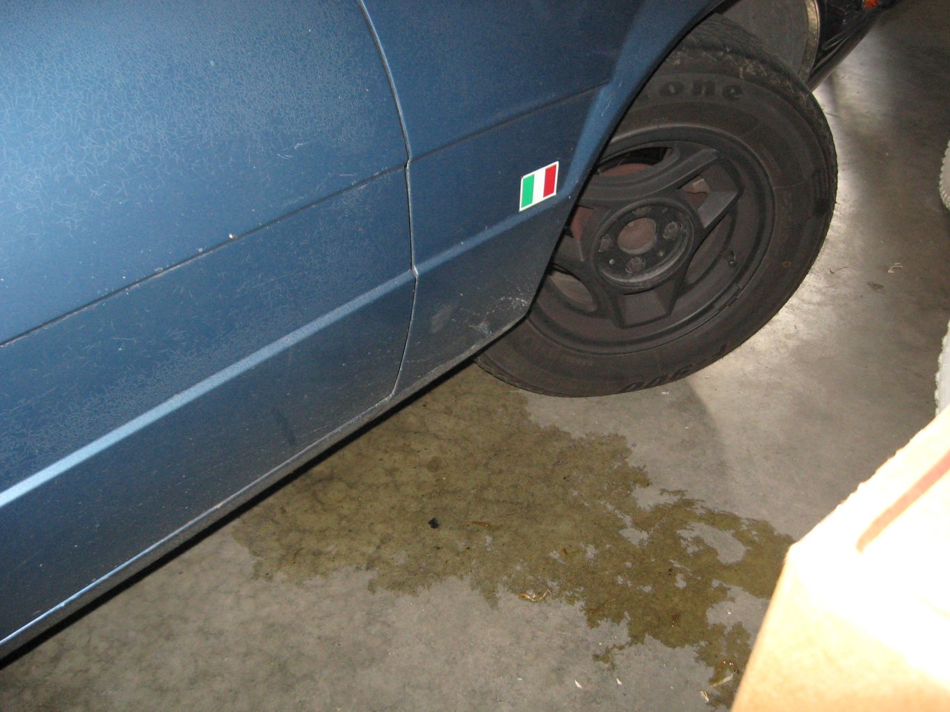

Went out to the garage to the garage to clear this;
And found this;
And I always though the engine was in the back...?
Turns out the steering rack has about a litre of oil in it, and when a rack boot splits it pisses out onto the floor. Going to get it fixed this week and replaced with grease. Grease wont fall out I am guessing....

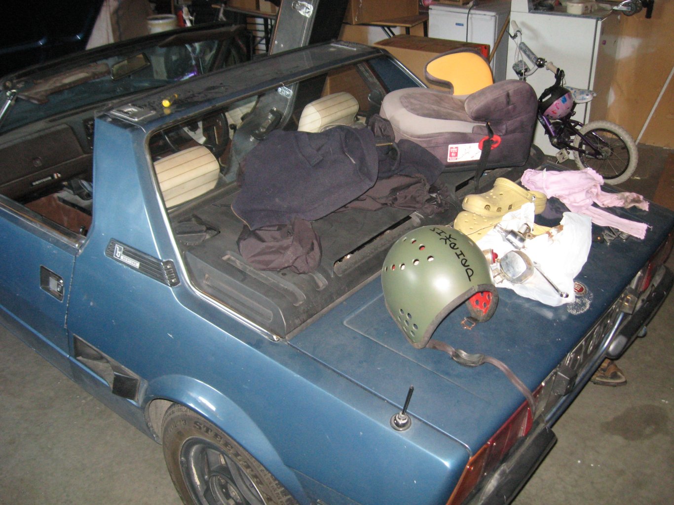

So there is another track day coming up with the Canterbury Fiat Lancia club. Last year I used a kevlar race seat which was good and supportive but this wasn't low enough to let me have the roof on while wearing a helmet which sucks quite badly. I have been looking around for a year for something that will do the trick, including looking at getting one of my existing seats modified to be lower and more supportive, but it was all difficult and/or expensive. So i though fuck that, why don't I just build one, then I can make sure it is as low as possible within the space that I have. Not too worried about the legalities as I will probably never use it on the road, and I can make it suit my awesomely chunky arse as well.
Still got a couple of bits to tack on yet - extra bracing between the hip and shoulders, and probably a couple of bits by the thigh. I will no doubt pull out of shape a bit when it gets fully welded, but as I have done it all pretty much by eye then meh. Initial indications are that I will have a spare 50mm or so above my helmet so yay.
Not sure whether to tack in some thin steel for the actual seaty bit, or pop rivet some ally sheet. Probly just velcro some padding straight on to whatever that ends up being.

Track day on Saturday so I thought I would actually try to finish my seat, this is today's effort;
It is really quite comfy and my helmet fits too...
Will cut belt holes etc tonight hopefully then find something to line them with. Then I need to find some padding, probably foam held down with duct tape for max rang spec.

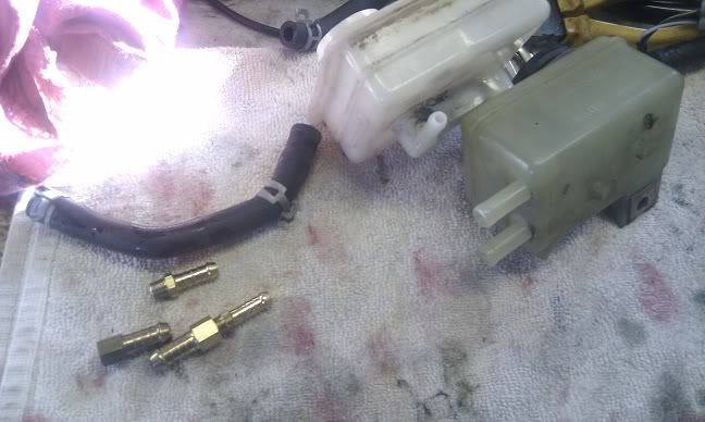

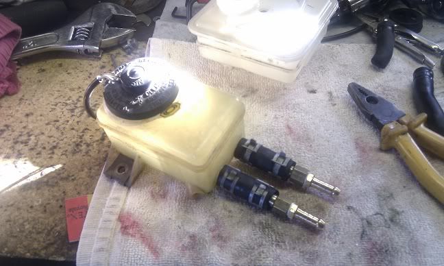

Also my brake reservoir cracked and pissed fluid everywhere, have to find another out of something else as these are not available anymore, apparently BMW 540/740 ones can be modded to fit - anyone got one?

So I have found a pretty good replacement for the brake reservoir on the X - off a 1992 Toyota Estima. The outlet tubes are a size too big so need reducers to work, but for $25 all up I am pretty happy with the result. At least I now have one car that is actually fucking driveable if I need it.
