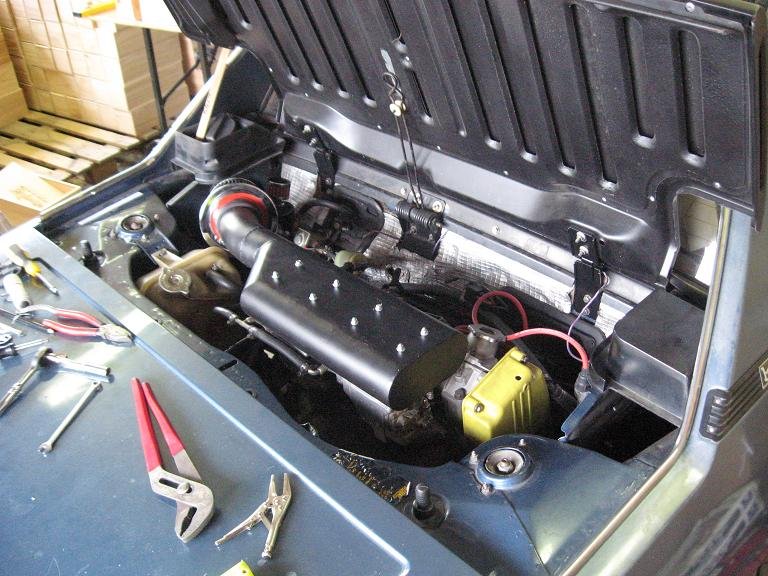

Well she is all up and running now, and I have driven her for all of half an hour or so without leaking petrol or melting a piston.

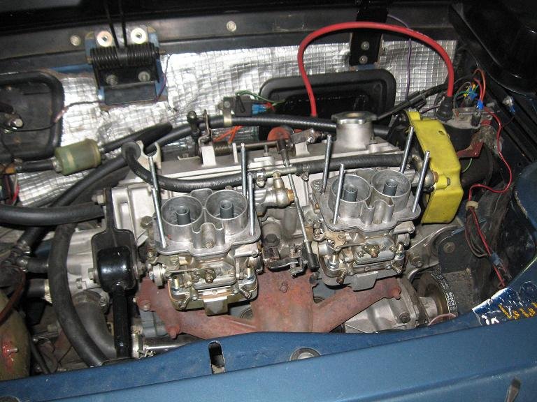

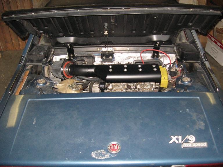

This is what the airbox looks like, although it is now black and the ridiculous pod filter actually seals at the mounting point due to the power of RTV :?
There should be no significant CFM restriction with this setup.....

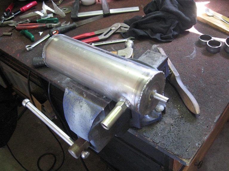

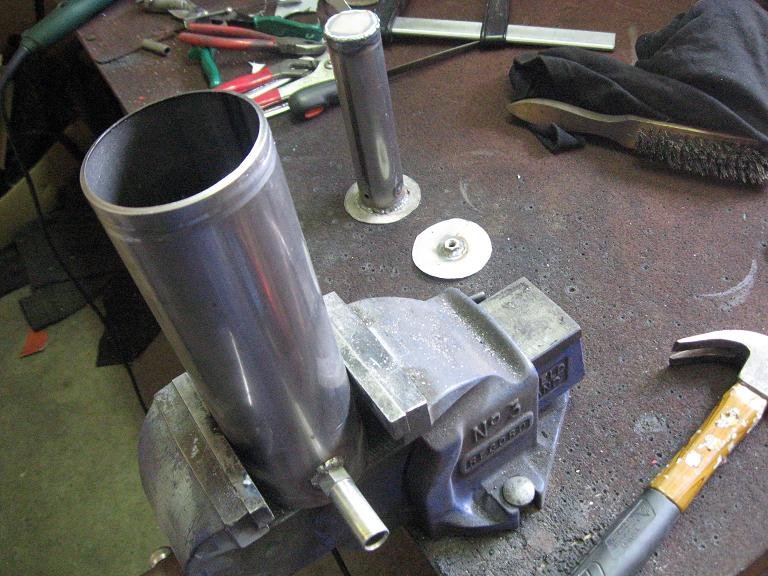

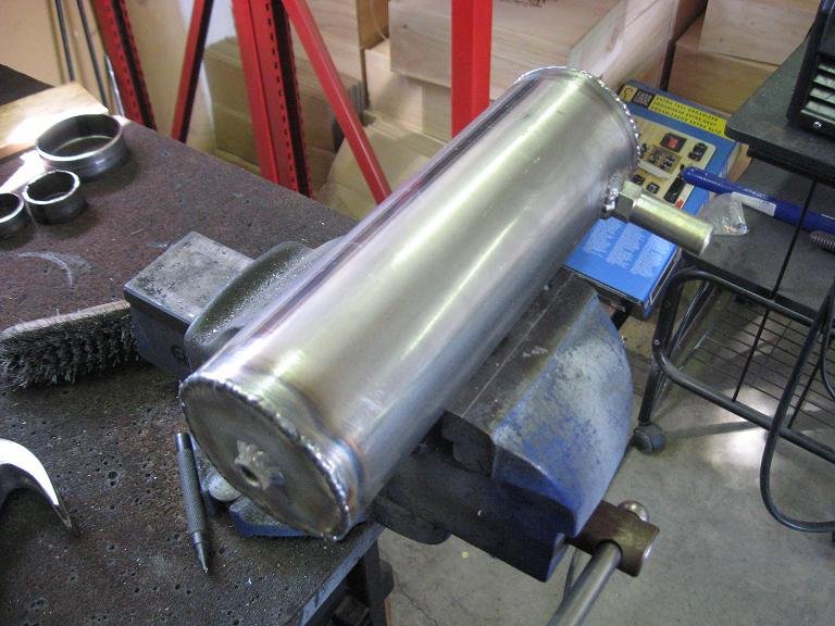

DIYCatchCanoutofrandombitsyoufindinyourgarage Time!

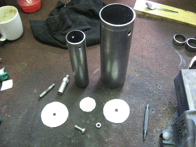

The bits I found;
Tube - random leftover exhaust tubing. This isn't as thick as it looks, it is just the way it looks after my Topmaq 2" pipe cutter (that has been slightly modded to cut 3" pipe) has been at it..

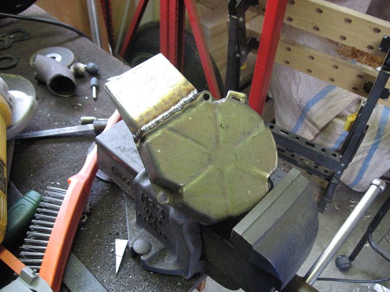

The endcaps are made from computer case (which also saw use in the dizzy inspection plate mods), the smaller tube is from the fuel pickup from a Lada stationwagon, the larger tube is the dipstick guide from the original X1/9 engine.
I did have to get some stainless steel wool that is packed down the bottom between the two tubes, but my wife bought that while she was shopping, so effectively free :wink:
O and I did buy a wee air filter thingy off trademe for $8.75 to stick on the top.
Weldy weldy weldy...
I also found some Festo push in right angle fittings so will fit those up with a bit of clear tube if I can find some....

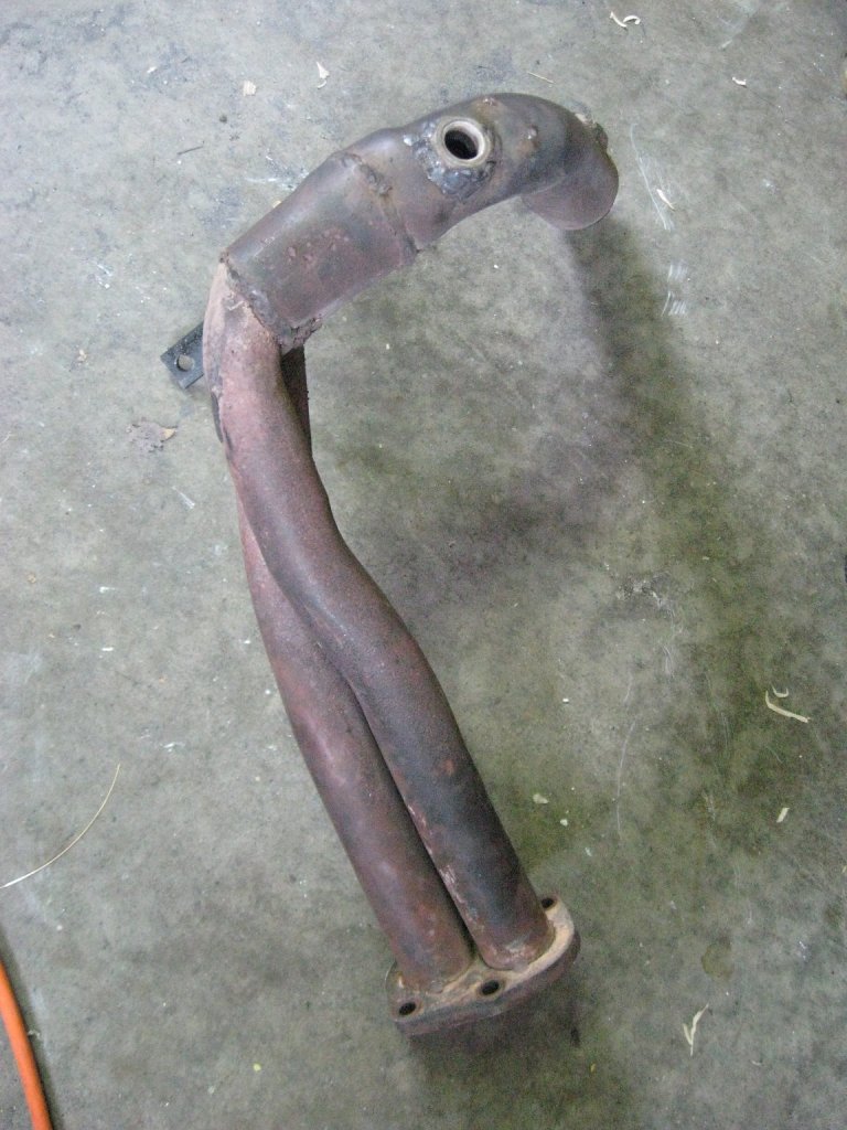

Have been messing around with header design.....
Not 100% sure on the clearance to the waterpump, but overall it is not too far off. Primary size is 35.1mm/1.6mm wall section as the ports are 31mm ish. Pipe length is 1020mm.
It has been an effort making sure that the bends are the standard prebent section sizes from Autobend...
Can someone tell me whereabouts at the collector the primary is considered to finish?

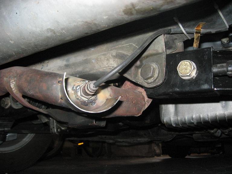

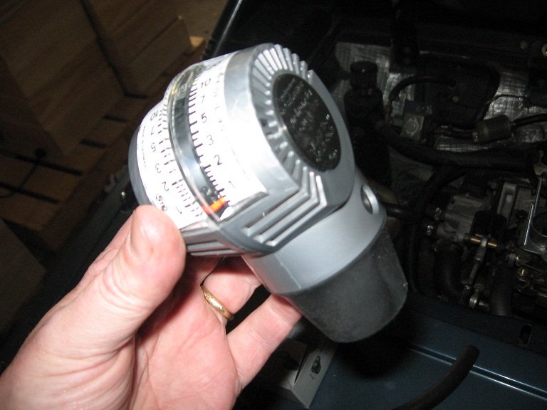

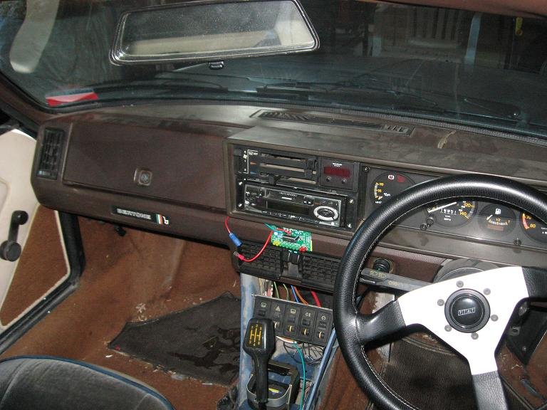

So for shits and giggles I though I would fit an o2 sensor to vizzle the stoichiometricizzle.
17 μlarge got me a jaycar kit which even someone as deeply electrically retarded as me could slap together in a trice as there are only 4 things on it. It took longer to figure out the values of the resistors than the entire length of the rest of the project.
A Toyota Vitz o2 sensor and a friendly supplier who gave me two M18 metric fine half nuts sealed the deal;
And the prize for the roughest ever fuel air indicator mounting goes to;
Well that would be me then.
Result? - I had no real baseline to judge it from, other than the pot was wound fully anticlockwise to get it out of the yellow and into the green, so it is probably running rich on average. However, it is remarkably consistent under all load conditions, and making it do it's flat spot dying/coughing/farting thing didn't really affect the ratio, so it is hard to say it it is caused by leaning out or getting too rich.
As this was the point of the episode, it is probably been a waste of time...
mmmm pretty lights though.

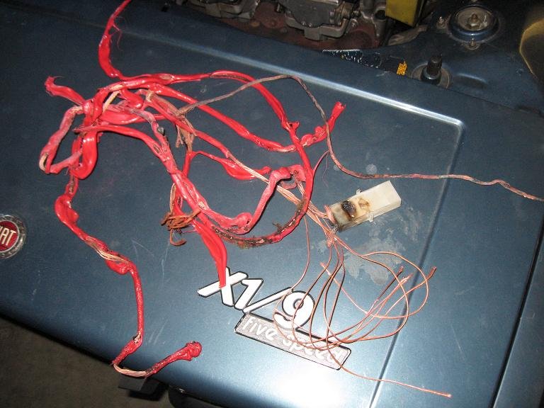

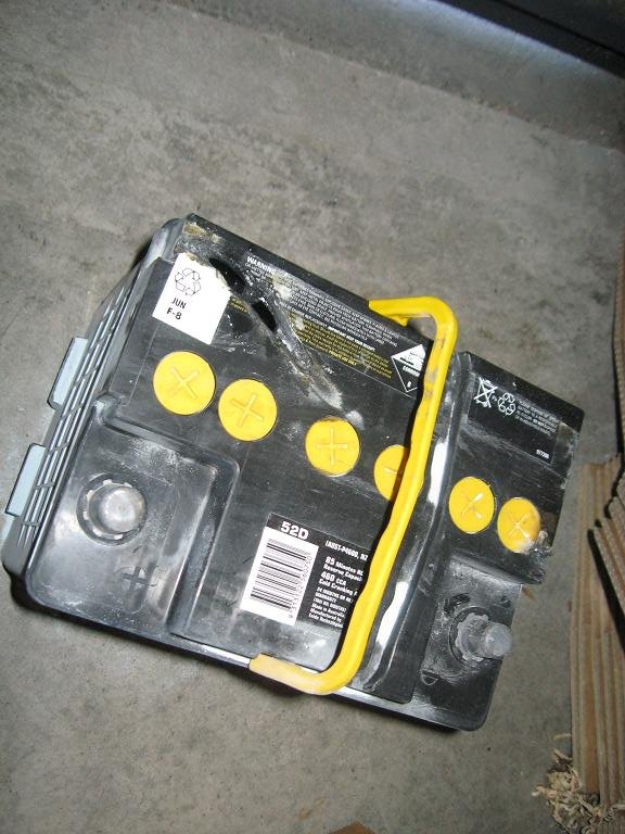

Unfortunately on the 4th lap of driver training the car managed to set itself on fire! The extra charging circuit wire had shorted on the back of the alternator and set fire to mostly everything between the alternator and the battery - there was a truly exciting 30 seconds while we jumped out and put it all out + tore the main supply wire off the battery!
I have no pics of the aftermath as I got Nick to tow me home (behind Brian's Integrale, this was not the perfect tow car as it is a bit laggy below 3000 revs... :shock: )
Things looked pretty bad mostly as everything was coated with fire extinguisher. After I got it home I had a better look;
This is the remains of the power wire and the main supply junction
This is the near new and now decidedly second hand battery
These photos are after the fact as I ripped everything out, vacuumed all the extinguisher powder, whipped down to Ripco for a new battery/terminal/wire/etc, rewired it all from the battery to the fusebox and created a new junction. I then checked everything still worked, which fortunately it did, and drove back out to Ruapuna.
There were a few disbelieving looks from some of the boys who had inspected the damage when I had towed it back off the track :D

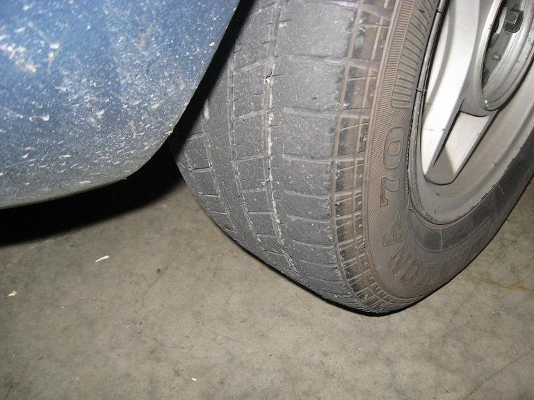

From that point on things went pretty well - I explored the outer limits of road tyre adhesion (and beyond those limits at the hairpin - but we won't discuss that any further), and tried to crack the ton on the main straight - which I did manage after a good run round the last bend, but I nearly had brown trousers before I made it around the bend at the end of the straight!
Bit hard to tell, but this was once a warrantable tyre that probably isn't anymore :lol:

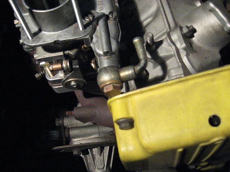

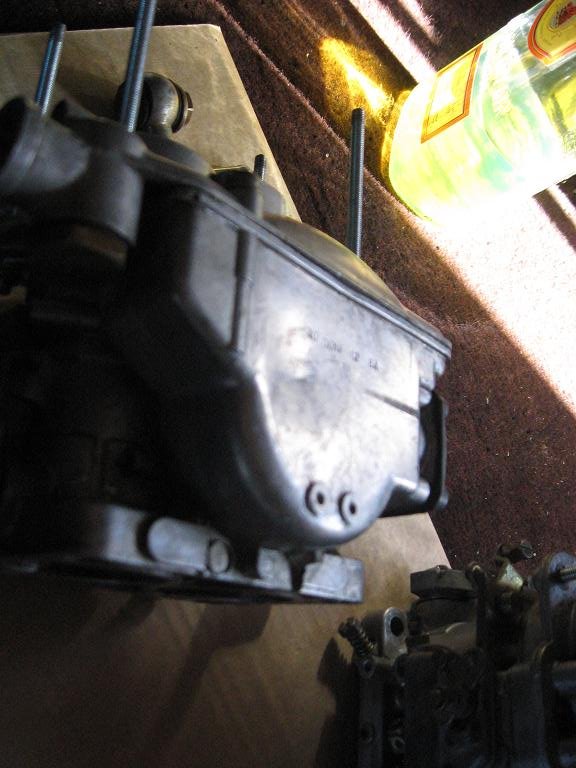

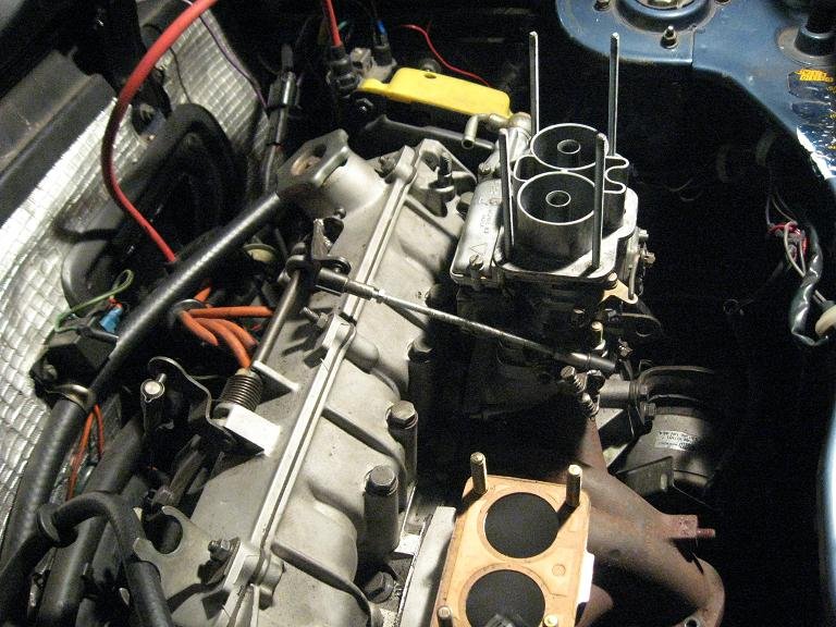

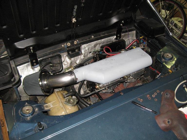

2. I have been meaning to spin the carbs around so the bowls are facing the front as I have found the car flooding itself coming to a stop on steep downward inclines. I knowledgeable man told me so, but I didn't think it would matter but it does.

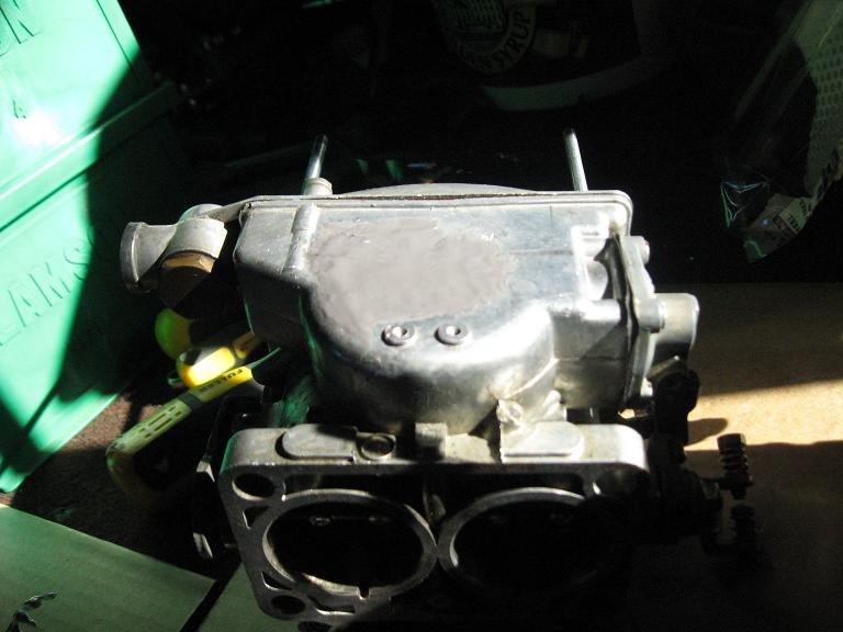

3. I have also noticed that one of the carbs has been seeping petrol out of a wee ding on the float bowl - I knew the ding was there when I installed them, but it is obviously more cracked than I expected. The best option to fix it seems to be a metal filled 2pot epoxy, as I wasn't that keen to break out the gas axe and have a go at soldering it up :mrgreen:
So time to crack on, going to have to hack up my stylish airbox to make it fit when the carbs are moved unfortunately.
A customary position now.....
A crap shot of the ding, damn these point and shoot cameras...
metal filled 2 pot epoxy applied;
What with it being a balmy 4 degrees in my garage, the epoxy wasn't looking like setting anytime this century, so the carb is now sitting in a high place in the kitchen with a woodburner going full tilt, should be sweet by tomorrow.
Might give it a cleanup to knock off the bigger lumps then do a pressure test - will be interesting...

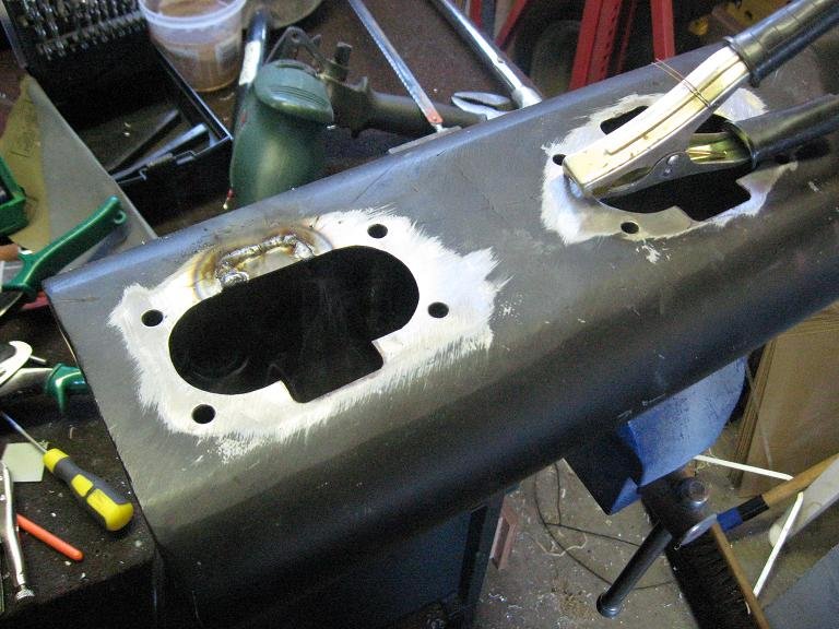

One minor issue during the swap around - pretty close to the cambelt cover etc, solved in 5 mins with a file...
Spent a lot of time fiddling with the linkage - I had to dick around cutting and welding the interconnect to make sure the actuator rod was clear of the accelerator pump. I also wanted a little more pedal travel, but this made it hard to get it past the fuel line, which made the fuel line to close to the frigging airbox etc etc, but I got there in the end;
Also needed to mod the airbox cutouts;
A lick of paint on the fixed box + some better box to carb gaskets and all was good;

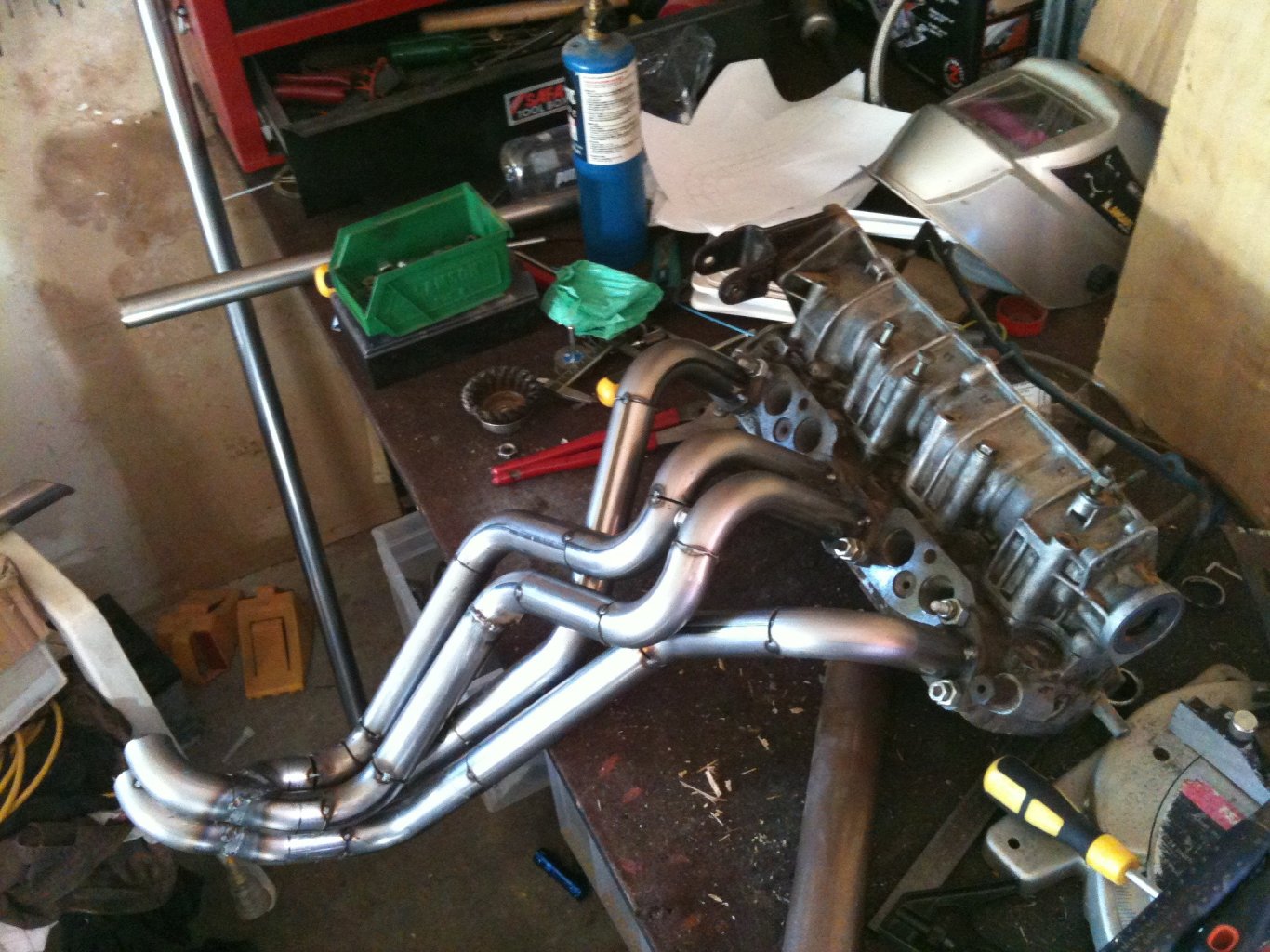

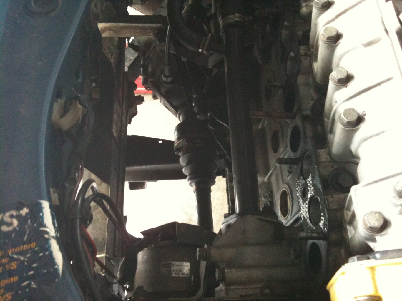

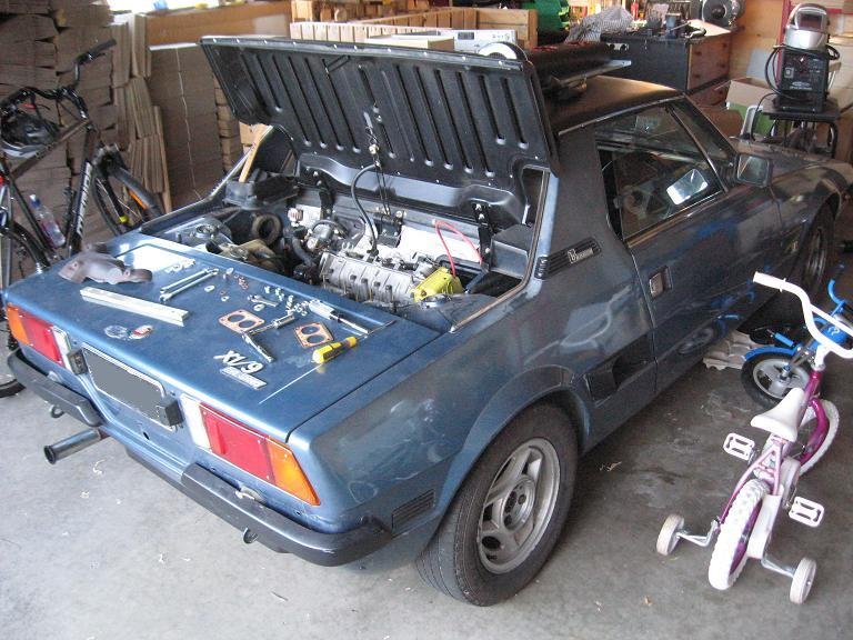

Anyway I have a few spare days over chrimble so I thought i would actually build the headers instead of just wanking on about them, so I started yesterday. I had already bought the prebends from Autobend and the flanges from RE automotive in Taranaki, he is a good boy to deal with and pretty cheap.
Insert headers here....
One pipe
Two pipe
Three Pipe
Four
Except I only got the first two sorted so far.... :(
There will be more in the next couple of days no doubt.

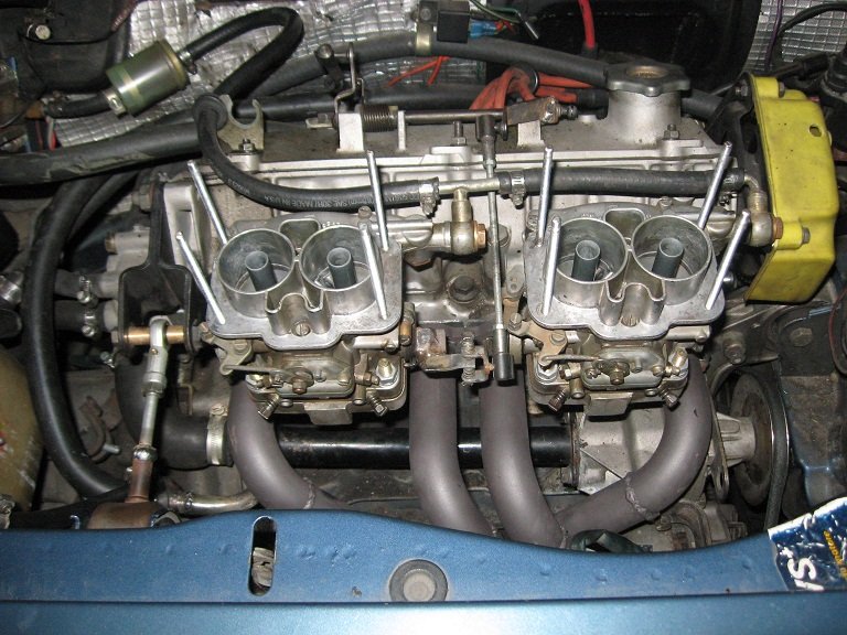

Heres 3 pipe that I just cranked out;

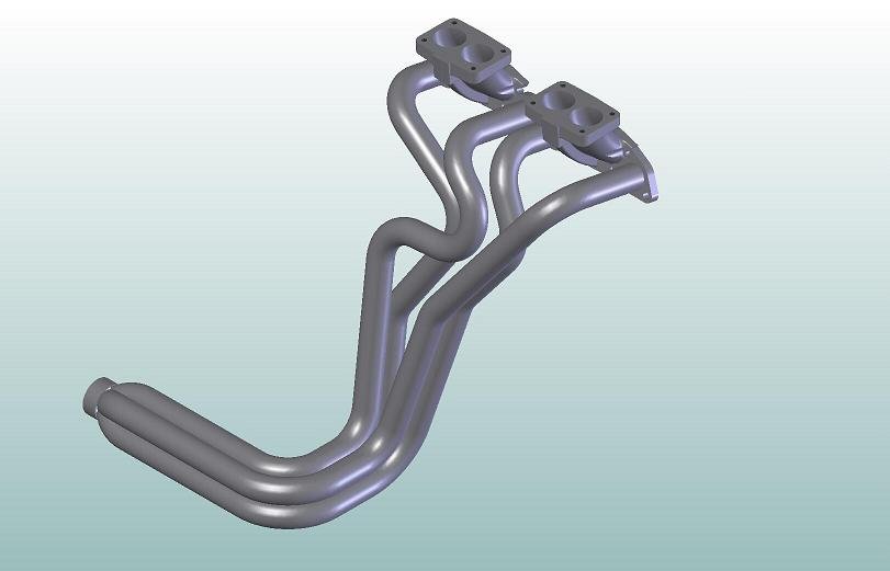

And here is the 4 - 2 collector that I made a couple of months ago in mega hi rez/clarity phonecam version;
Have not yet tacked the pipes in place, they are just sitting there making sure the CAD was right and that the pipes will not be burning shit in the bay. Will need to tweak the heater outlet somewhat, it is sitting a bit close to number 4.

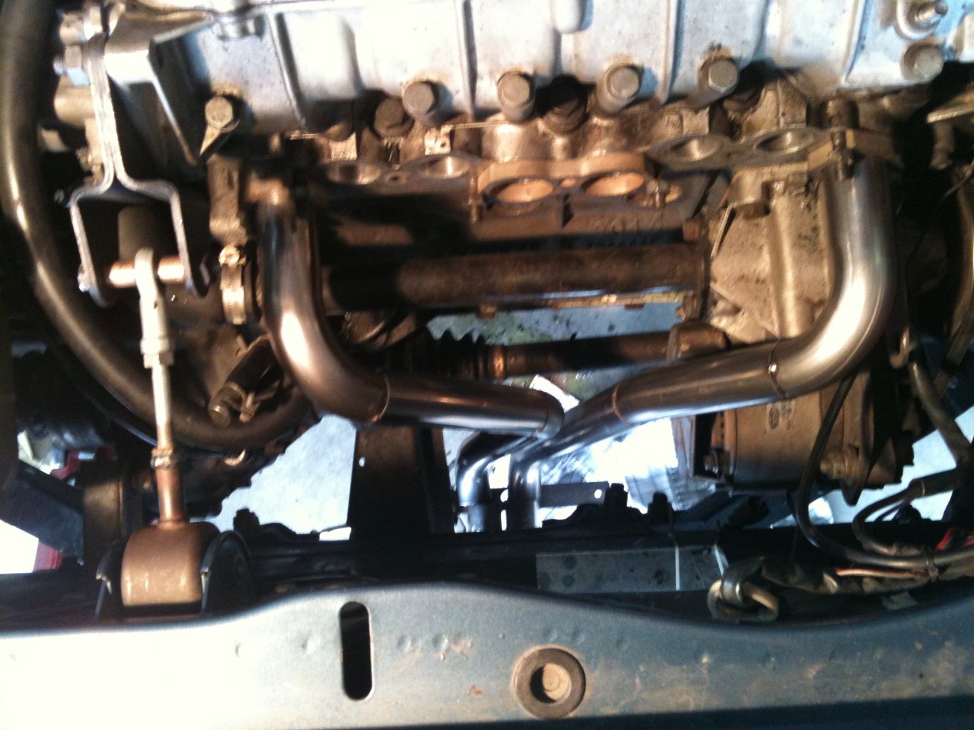

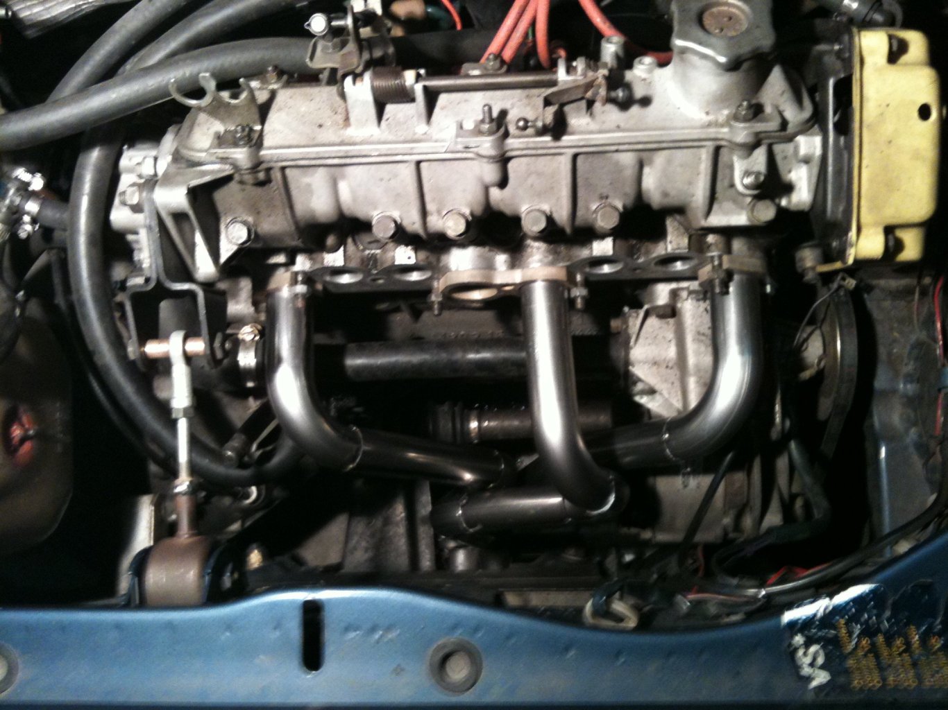

Todays effort;
Pipes should all be within 5mm of the correct length as i had to only trim minor shit to get fitment.
Also realised that I will need to take bits off the engine to actually fit the fuckers once the secondaries are on.
Basically done except for the wee lick I need to take of the head mating faces to get the heights right for the inlet manifold.
Painted them with some shithouse hi temp spray bomb, amazing how being all one colour makes shit look better.
I spent most of the time so far fighting the serious fucking wrongness that is my welder, serves me right for only spending $350 on it fuck it is a piece of shit endlessly jamming the feed, so you waste 2 meters of wire when you unjam it and then the bastard jams again while feeding it through, and then does it again. 6 meters of wire wasted for one jam. Fucking wire feed has ONE FUCKING JOB TO DO, that is to feed wire through and it fails at the one task it has been specifically designed to do. grrrrrrr aarrrgggghhhh blllluuuurrrgggghhh /rant

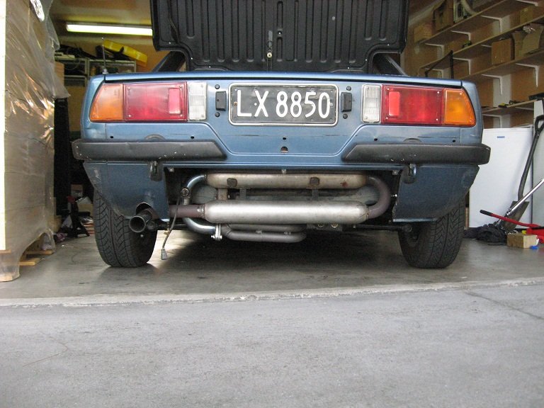

Now there is just a mega hack of the existing system to remove some uglyness/make it fit/etc - should be able to do it from what is there....

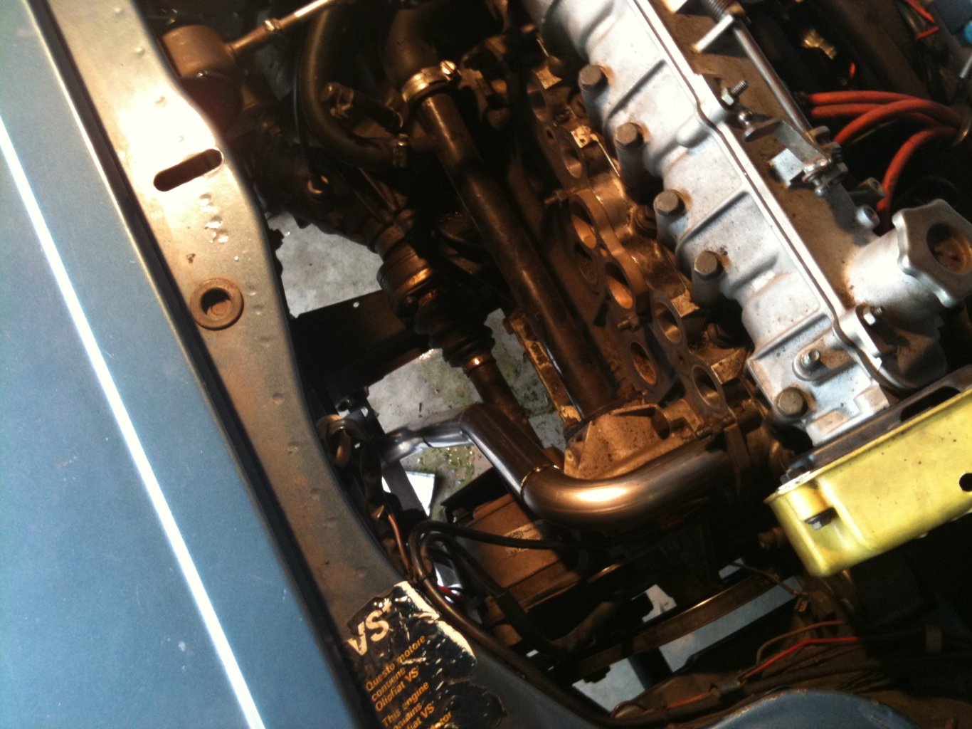

Finished sorting the rest of the system today has been a mission fitting it around the unreasonable demands of family life over the last few days.
This is the bit of ugly that has prompted all this, I imagine that this would have done nothing for the zorst flow;
Also modified the water pipe so that the rubbery bits were away from the hot bits. I like hot rubbery bits as well as any man but only in the right context.
Might have to bite the bullet and grind back the welds on the headers, boys have been giving me shit about how rangi it looks......

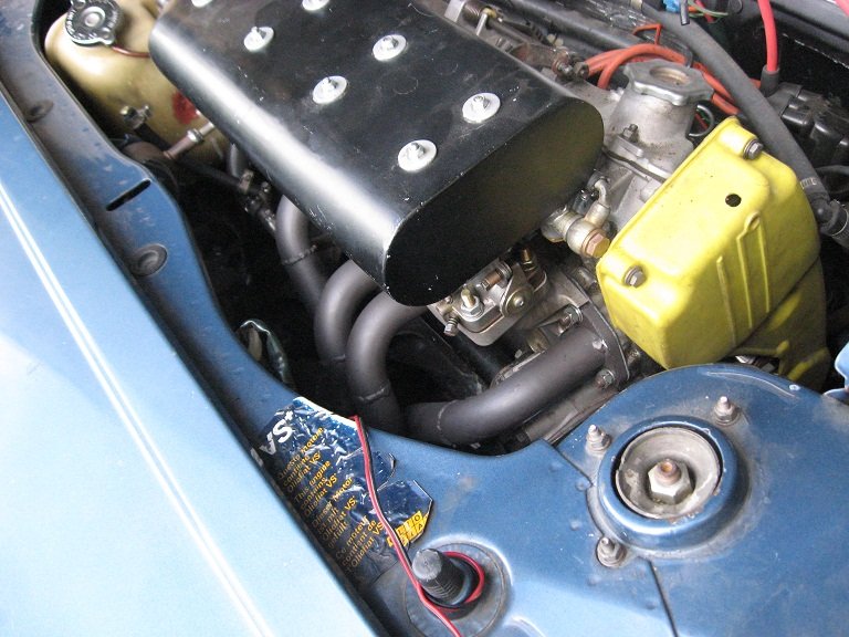

Stuck it all back together today and went for a drive, seems all good. Noise is no more or less that what it was before, maybe a little more raspy , but it feels a lot smoother and much livelier. Didn't really give it the big one as will wait until things have settled down a bit/made sure no leaks etc.
Need to extend the heat shield on the back of the alternator as the exposed wires are about 30mm from one of the pipes - also need to extend the wires for the O2 sensor as I have repositioned it to the other side of the system to make sure it was close to the exit of the headers....
The pessimist in me will not be happy for another week or two, but basically I am pleased....
All together again after doing this to the alternator heatshield so that the electrickery stays within its little pipes;
So I took it for a reasonable run to make sure shit didn't fall off/break/burn/explode/etc which it did not, but it was obvious the carbs still need some work, there was mega backfiring on the overrun and while it doesn't have the flat spot of death it does have the flat spot of painful flesh wound. Also for giggles I put a pipe to my ear and listed to each choke, it was perfectly obvious that each choke was sucking significantly different volumes, glad I paid money to acheive that shit right there.

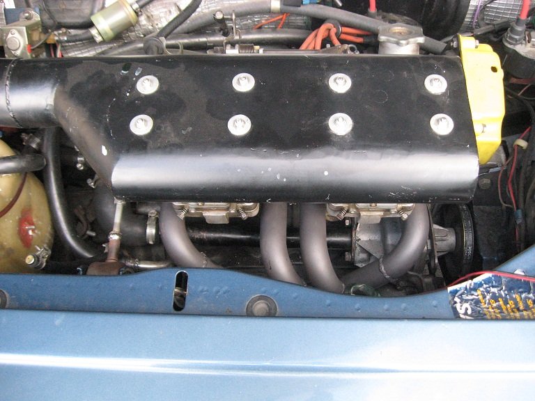

Well awesome has mostly ensued, I have balanced the carbs, the exhaust is sweet - apart from falling off after the multiclub run because I did not use split washers on the bolts at the join between the headers and the rest of the system. I have tweaked the carbs so they mostly run ok, still a wee flat spot and hefty fuel consumption but shit it goes well for all that.
Also I have scored some items of interest (to me anyway) - an early model stainless steel header tank, rare as hens teeth and 10.667 x e^24 more awesome than the shitty plastic one that mine has right now. It has a ding but quite frankly I am not the sort of boy to care too much about that;
And another engine cover;

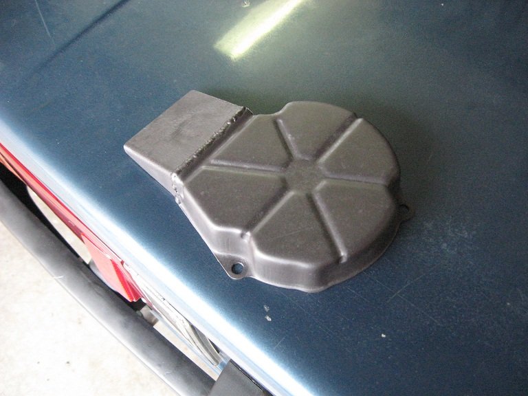

Which I will modify to get some more airflow + a cold air box for the induction as it gets extremely hot under the bonnet.
