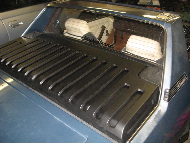

While waiting for Nick to come around I took the opportunity for an open air photo shoot, what a beauty!

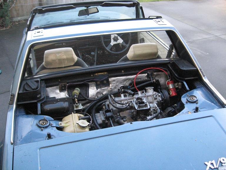

Well the old dear is fully legal now as of 8.31am this morning (the post shop opened at 8.30 :D) - I spent half the day driving around town, and it only broke down once! :lol:
It is slightly hard to start when warm, and the battery didn't quite have enough juice to get things going, the battery looks pretty new but I guess sitting without charge for a year will have an effect...
Have also discovered the joys of the secondary carburettor choke - I have been a bit careful up until now, but the effect of mashing the right foot to the floorboards is a real treat let me tell you, I didn't think it was going to be all that quick but I am surprised at how well it gets off it's arse :shock:

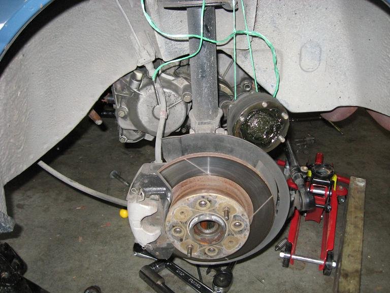

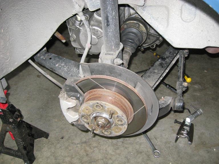

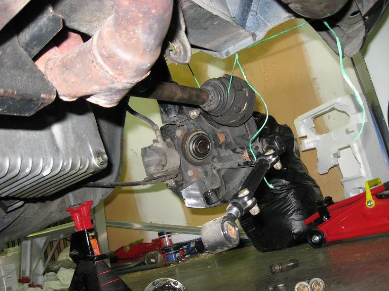

Finally got onto one of the bigger jobs left to do on the beastie.... rear suspension joints.
The WOF man had pointed out that they were very nearly shagged, and gently suggested that I should do something about it before the next warrant :doubt: ;
Wheels off (see my nicely grooved discs :D );
Off comes the driveshaft and out comes the axle;

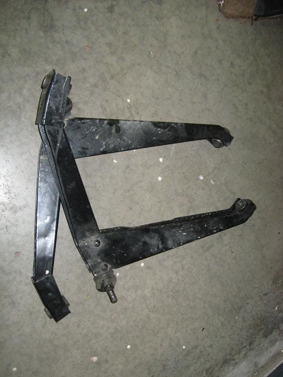

And I am left with this - not too bad a job, thought I might have to take off the exhaust but managed to lever it out of the way to get access to the LH inner bolt;
While under the car I also tried to fit a new gearshift lollipop that goes between the gearshift and the gearbox, but that was pretty obviously not a goer as the bit was way too long to fit. I guess this has the earlier solid(ish) mounted arrangement, so I made some minor modifications to the existing setup to remove a bit more slack and put it all back together - feels nice and tight now. I also discovered why I had lost 5th gear on the last drive :cry: - the nylock that I had used to provide a wee bit of slack on the mounting nut had worked itself loose and there was so much slack that the gearshift was simply not able to rotate the gearbox shaft enough to engage it...
I will drop the arms into a place called HBI engineering here in Christchurch who will reseat the balls - they have apparently done quite a few X's in the past. Not cheap though, I think he quoted me $180 a side....
Still, I reckon it will be worth the effort.

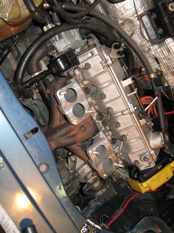

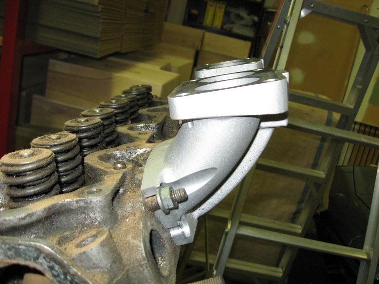

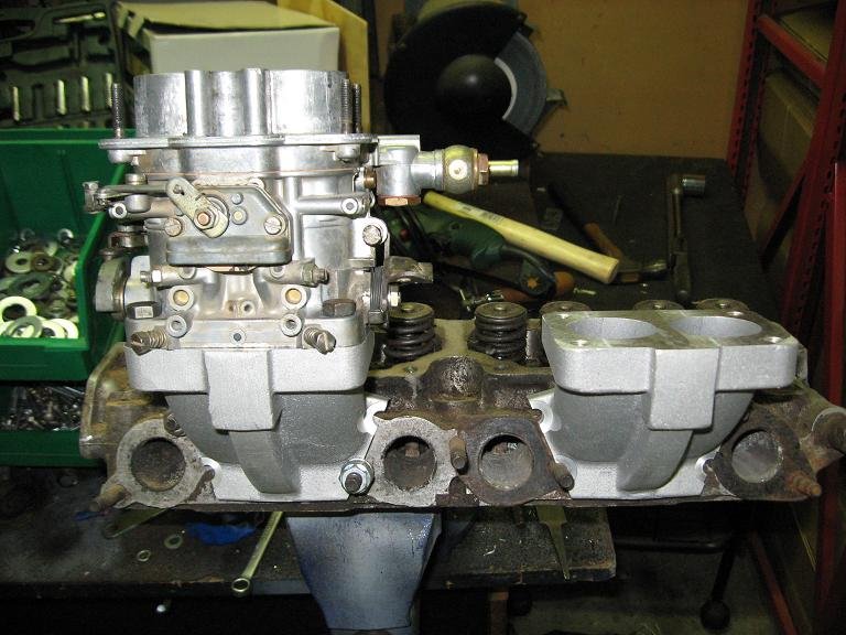

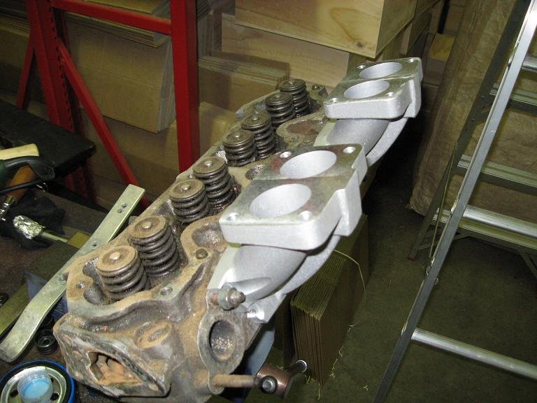

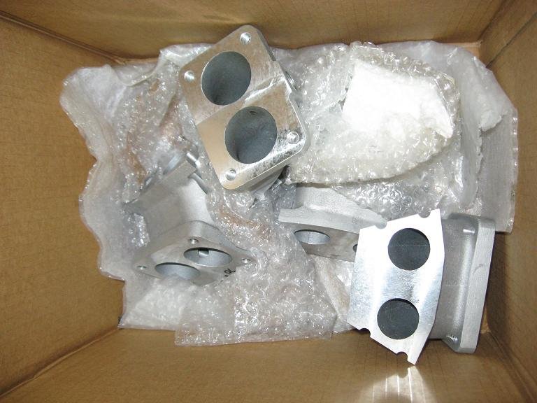

So I have designed a set of downdraft manifolds to suit the Weber 40DCNF's I got off TM, I have had the pattern made and parts machined - and the first samples finally arrived :mrgreen:
I have made them to suit a Fiat 128 as well, they are the same engine as the X1/9, just set at a different angle....
Set up on a random Fiat 1300 head that I had lying around;

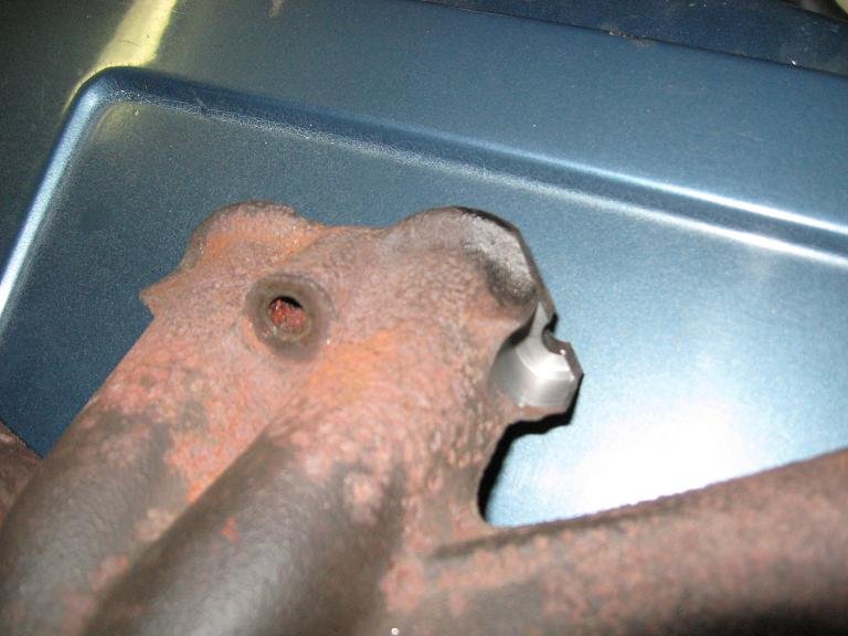

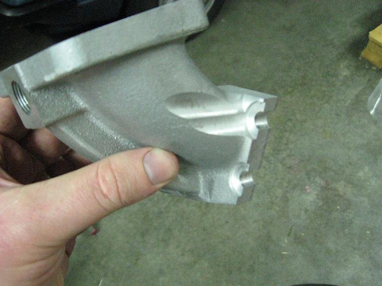

So my wee man who does the machining made some (easily rectifiable in the future) mistakes;
Extra random cut on the 128 version
Blew the vacuum hole right through instead of making it blind and drilling a couple of wee holes through to the port on the 128;
Personally I think this makes this set scrap, as this would do bad things for the flow - what do you think?
I designed the raw casting so that there was plenty of meat for machining the X1/9 and 128 versions, and I set up the angle on the bottom of the two flanges to split the difference - this is so it doesn't look too out of place on either, however he has machined the head side flange parallel, leaving a fairly thick and angled flange on the top;
There are a couple of other minor issues, but not too bad for a first cut....

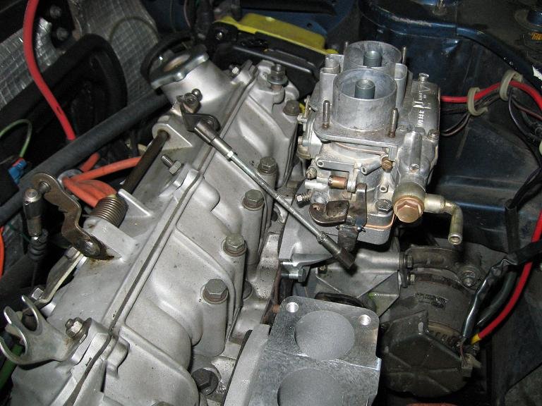

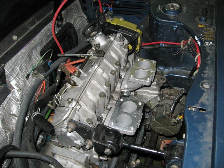

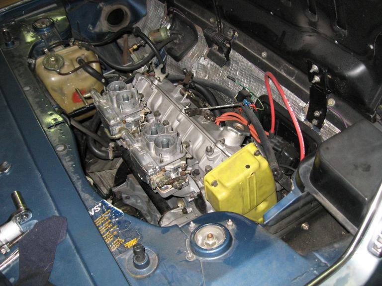

Exciting times in ladaspeedland - my 40 DCNF's are about to go on;
Looking very awesome right there;
The first hack at the linkage, which was actually pretty spot on - couple of minor tweaks and it will be sweet;
I wasn't sure whether to set them up with the fuel inlets to the front or back, but having them around this way avoids a minor clashing of the fuel inlet with the cam belt cover sheetmetal and gives significantly more room for the throttle linkage - as you can see this is very direct...
If I need to set up the choke then it is more convenient this way too as the linkages face the front.
Can someone tell me the initial setup process for the carbs? I have got the jetting that I think I need + a few sizes up and down - I am more after the air adjustment setup process. I only need enough to be able to drive it into town.....and let someone who knows what they are doing sort it out.
Slowly going back together, I have modified a spare standard manifold I have to have a consistent mount flange thickness and fitted it all up to see if there are any clearance issues;
Seems to fit up nicely :D
The standard manifold is temporary just too make sure all is well with the setup - I am looking for a nice set of headers if anyone has something....?
Have also sorted the fueling setup - I bought a holley regulator which is probably unsuitable as it has no return line - I thought it did but it just has two outlets..... :? but I set it up with a gauge to accurately adjust the pressure, only to find that the pump is putting out exactly 3psi..... So I am just going to hook this directly up to the carbs. If I can find a proper regulator I will use the bosch pump I have, although it should really be more than sufficient as it is, and much simpler. I believe the pump is a facet and has an internal pressure bypass.
Next job is the airbox, I should be able to get onto that today 8)

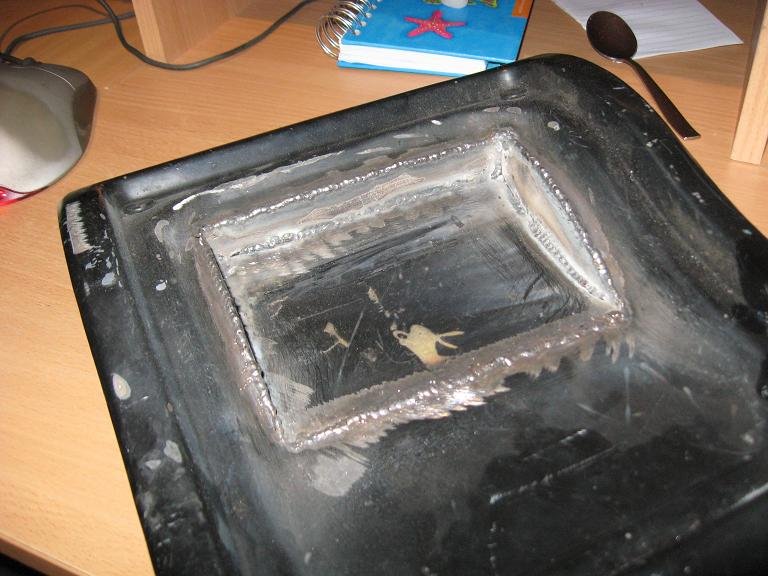

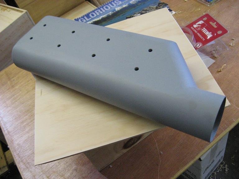

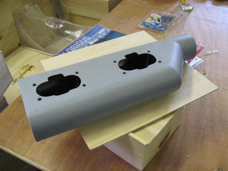

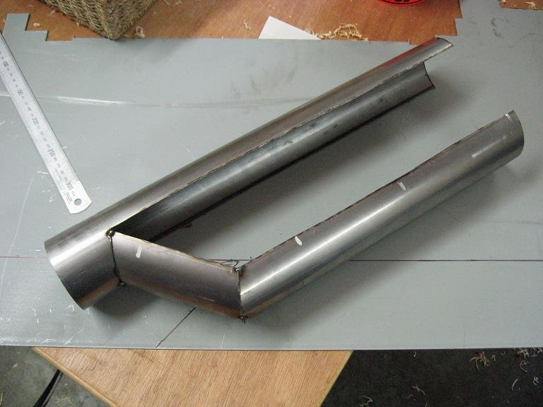

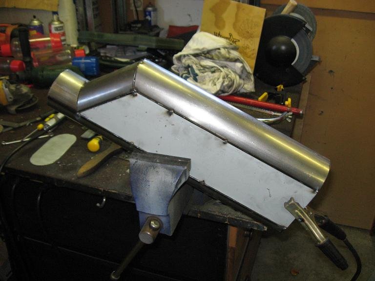

A bit of airbox action for you'all
Start with some 3" exhaust tubing and split it;
A bit of top and bottom;
***insert time delay footage of much cutting/shutting/welding/grinding/dremmelling/fitting up/swearing/cursing/sleeping/recutting/rewelding/regrinding/hole welding/regrinding etc etc***
And the result;
Probably going to weld a bit of 45 deg pipe onto the end of it and hang the pod filter right off that - was going to mess about with silicone joiners etc, but it would just mean more bracketry to hold the filter.
