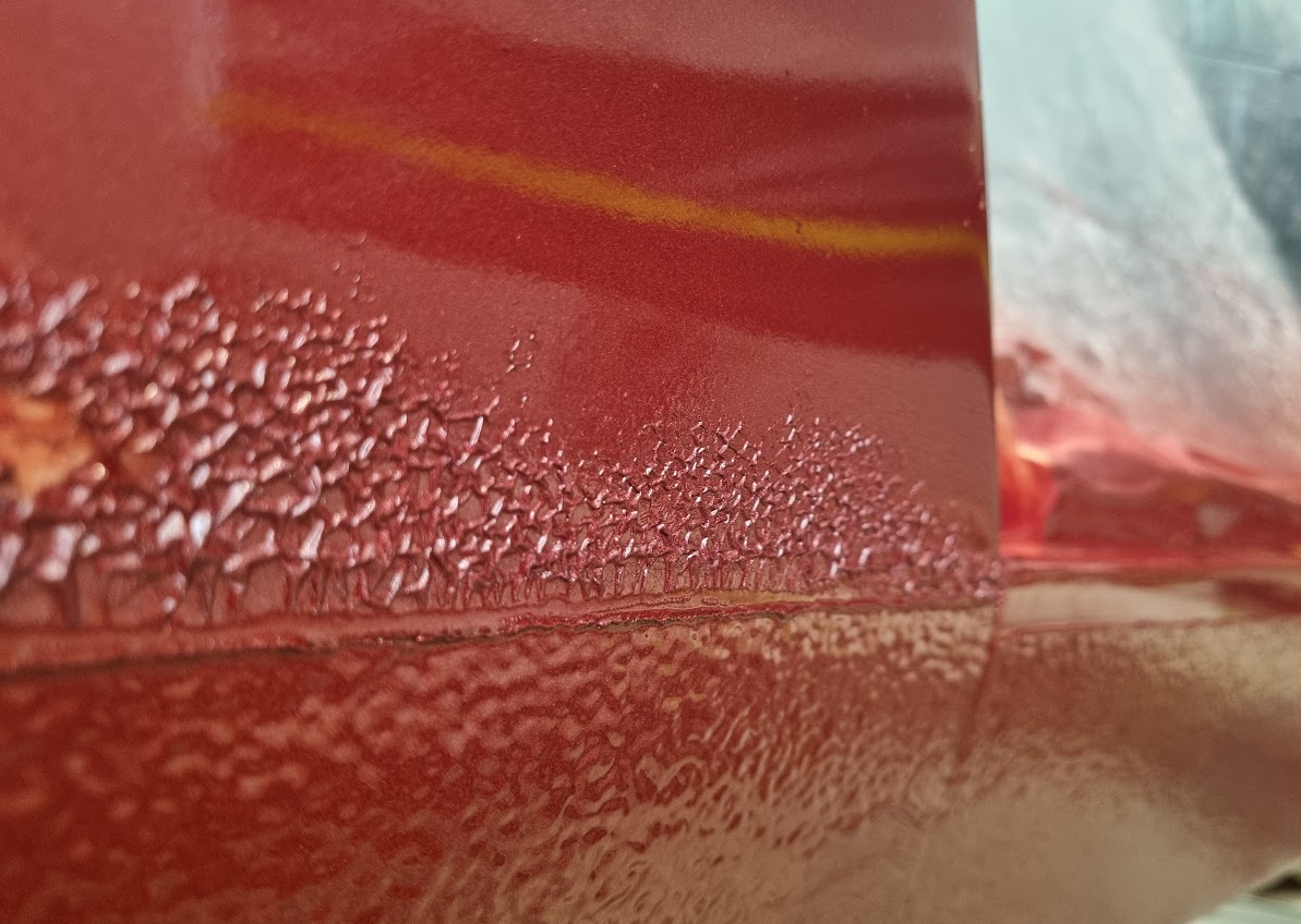

Ghost Posted October 14, 2025 Posted October 14, 2025 Well my touch up paint didn't go to plan, reacted with the original paint above the sill 1 3 Quote
