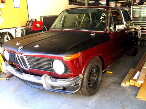

hey from sunny southern CA. i found this site on google images.. and :shock: i love the NZ and Aussie styles, it's good to see the old boso style lives outside of japan. you never see anything like this in the states :x but anyhow, here's my (almost) year and a half project. sticking an '87 325i engine into my old 2002. so far, no outside work apart from a little aluminum welding, so im tired of it :rolleyes:

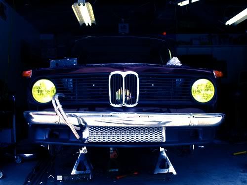

lamin-x amber headlight stoneguards

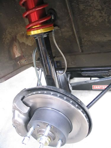

suspension/steering:
ES poly bushings at each pivot point
solid rear subframe mounts
ground control adjustable camber/castor plates
ground control front coilovers w/375lb stacks
intrax rear springs 275lb
22mm hollow fr/ 22mm solid rr antiroll bars
all new rods/joints
close ratio steering box

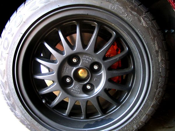

flat black pc'd Ronal R8 (15x7 ET28) fr/rr
Toyo Proxes T1-S 195/50/15

fr- volvo girling 4pots on 320i rotors
mintex pads
rr- stock drizzums
mintex shoes

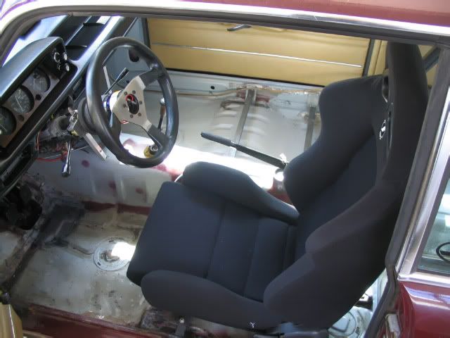

corbeau trs seats
schroth rallye-3 harnesses

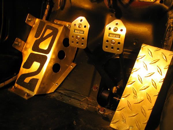

custom throttle/deadpedals

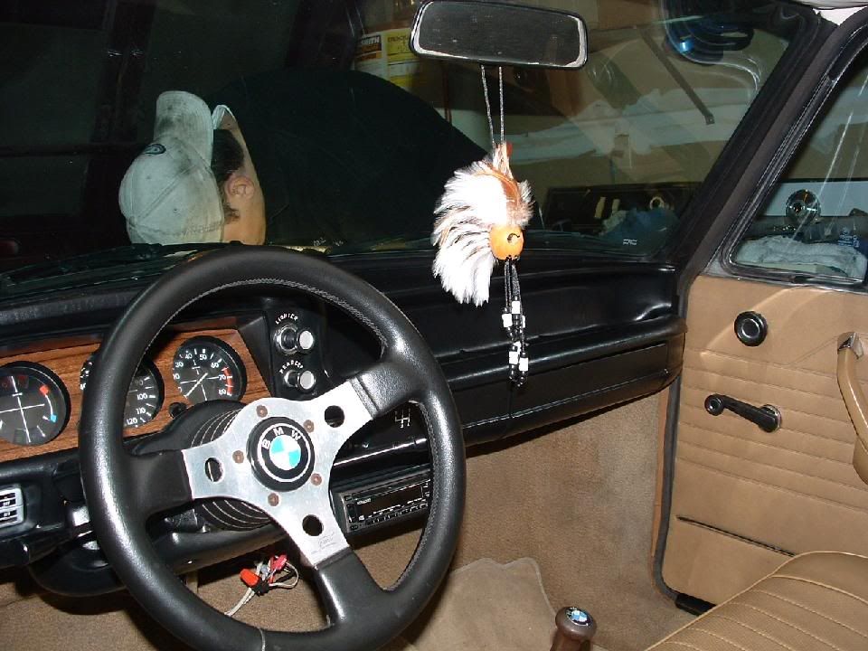

custom guage cluster w/vdo guages
momo monte carlo
innovate quick release

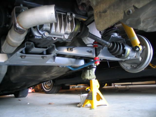

rebuilt the rearend 1st. i dont know y the hell for :?

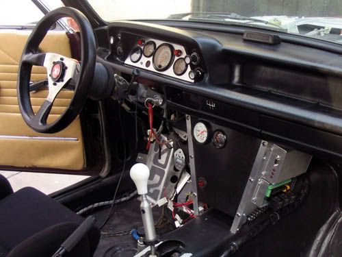

old shot of inside
after new seat mounts / stripping
newer shot of inside (minus the tangle of wires)

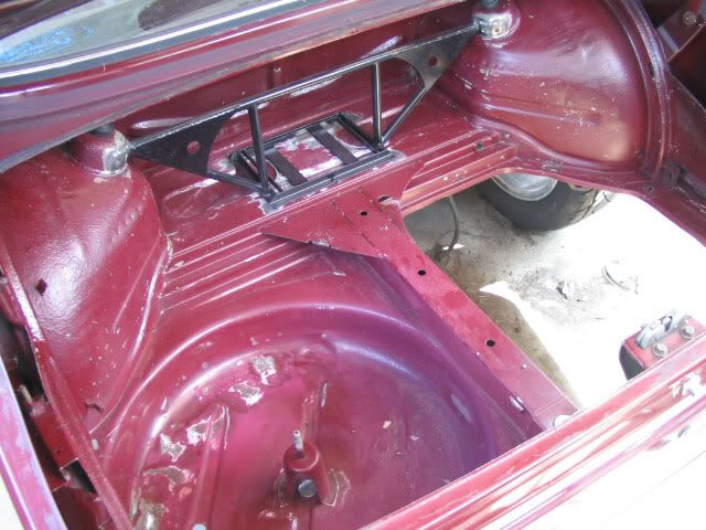

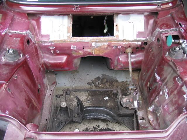

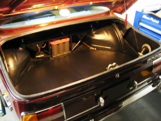

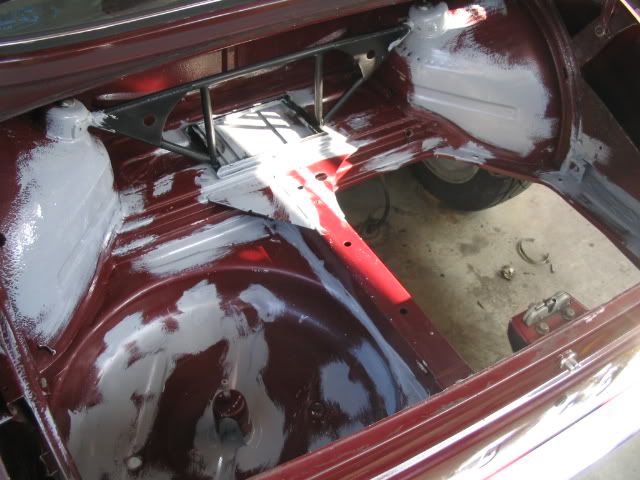

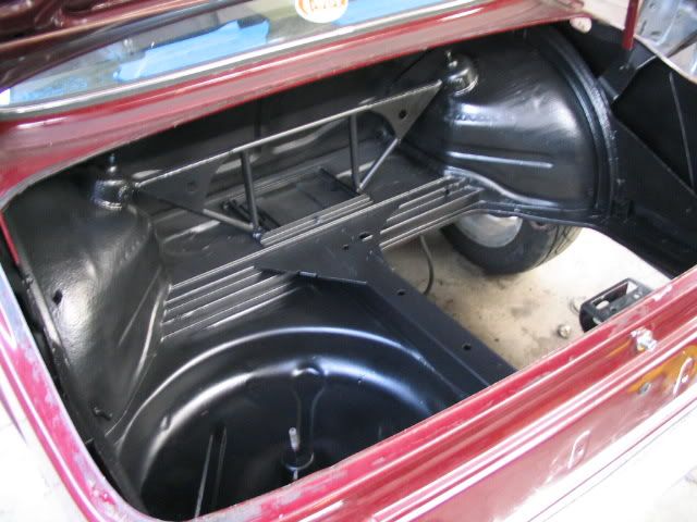

trunk after a lotta cleaning and welding in the battery holder/strutbar
exterior after 1st rebuild attempt

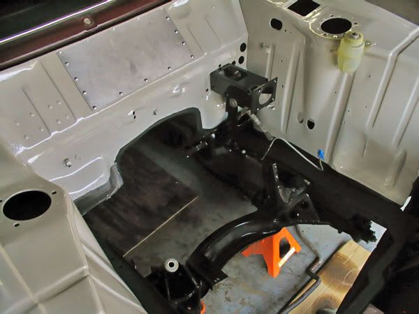

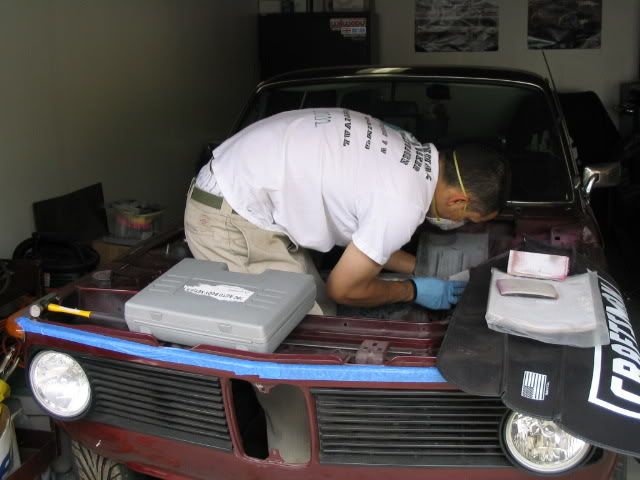

had a little fun with the saw and cut anything that wasn't need OUT..oh, and that itty bitty engine too
sanding sanding sanding sanding sanding sanding
testfit!!

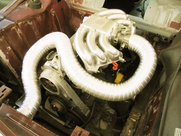

ram air!!
fits ok. painting painting painting painting

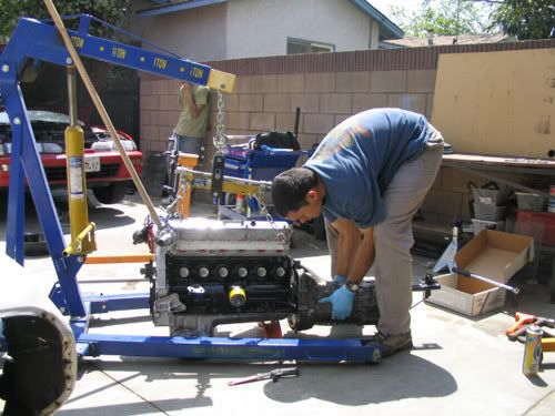

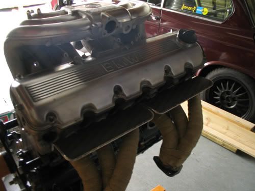

engine buildo
done whew that was fast :rolleyes:

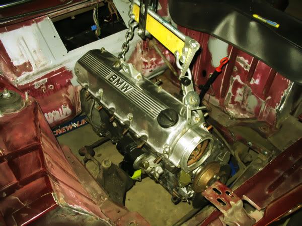

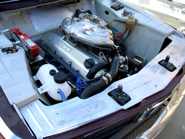

stuff it back in!
stop!
go!
stay cool
ready to go

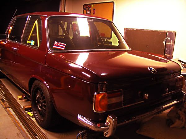

Well, the mufflers are attatched and work pretty well. I like the rumble, car alarms dont however. haha 2.5" straight through. magnaflow resonator and straight-through muffler. painted black. 0-bling

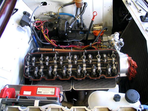

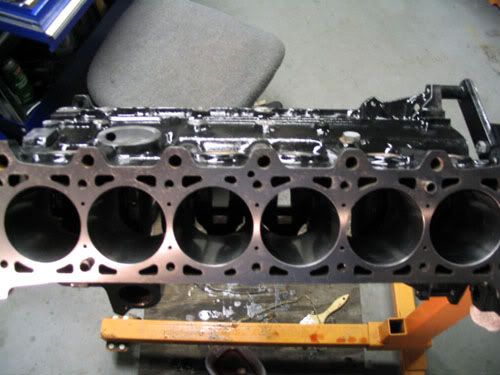

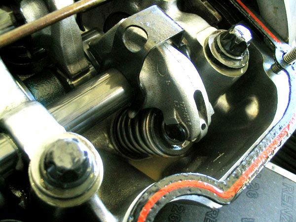

FUUHCK! :oops: i think i had a booboo toqueing down the head bolts and developed a leaking head gasket. car was overheating just a touch and found water in the oil and vice-versa.
=bad
so i ripped the dam thing off.. then someone told me i should pressure test the coolant system first. oops hedz alreddy off. o well. found a small nick on one of the pistons from the exhaust valve too. its prolly from the head and block resurfacing, so i ordered up an adjustable timing gear to get the valve timing dead zero again, and a thicker head gasket just for good measure. it should be back on the road in no time :?
what it's supposed to look like:
