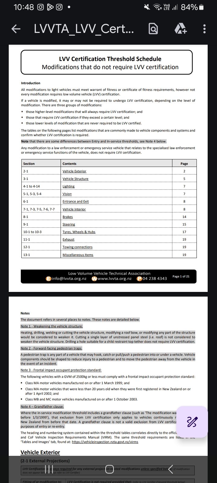

shizzl Posted October 17, 2025 Posted October 17, 2025 I’m sure I’ve read this somewhere in the CCM, but haven’t been able to find it again (tonight anyway). what is the minimum suspension travel required from normal position? is it 40mm from the bump stop to chassis? I know the rule for droop. does this also apply to the front bump stop clearance? im sure I have had this info in a screenshot somewhere. Quote
RXFORD Posted October 17, 2025 Posted October 17, 2025 Assuming its for your ute, rear is 40mm each way with a min 25mm progressive style rubber bumpstop mounted between axle and frame. Front is generally measured out at guard. So if the bumpstop is mounted halfway out on the lower arm, it will be in ~2:1 ratio meaning you can have 20mm of gap between bumpstop and still get 40mm travel out at wheel/guard. Just keep in mind the measurements are meant to factor in an average weight person in each seating position that will be certed. Plus other things like tyre rubbing inner guards when turning or radius arm hitting steering idler etc comes into play up front. 2 Quote
