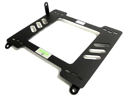

kws Posted December 15, 2018 Posted December 15, 2018 Speaking of certs, is this sort of attachment for the seatbelt OK for cert as long as the bolt meets spec? It mounts to the base that bolts to the floor of the car, and the recaro sliders mount to that base. Quote
cletus Posted December 15, 2018 Posted December 15, 2018 2 minutes ago, kws said: Speaking of certs, is this sort of attachment for the seatbelt OK for cert as long as the bolt meets spec? It mounts to the base that bolts to the floor of the car, and the recaro sliders mount to that base. sometimes. depends on the manufacturer Quote
