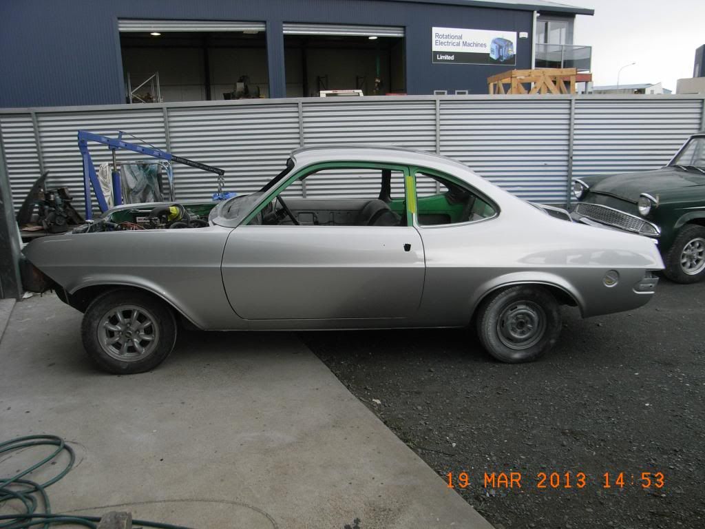

Well decided it was time to pull finger and make some progress so work has begun again on stripping the car for re-paint.
I masked all the openings and body seams to keep the paintstripper out of the shuts as I don't intend to strip those areas right back to metal.
Tomorrow I will start sanding back the edges with an orbital sander. Will focus on one panel at a time sanding off remnants of paint and filler then sealing up immediately after with expoxy sealer. Once the whole car is sealed up again I will start the fairing process.
Goal being to have it ready to spray over my Xmas break, going be busy!

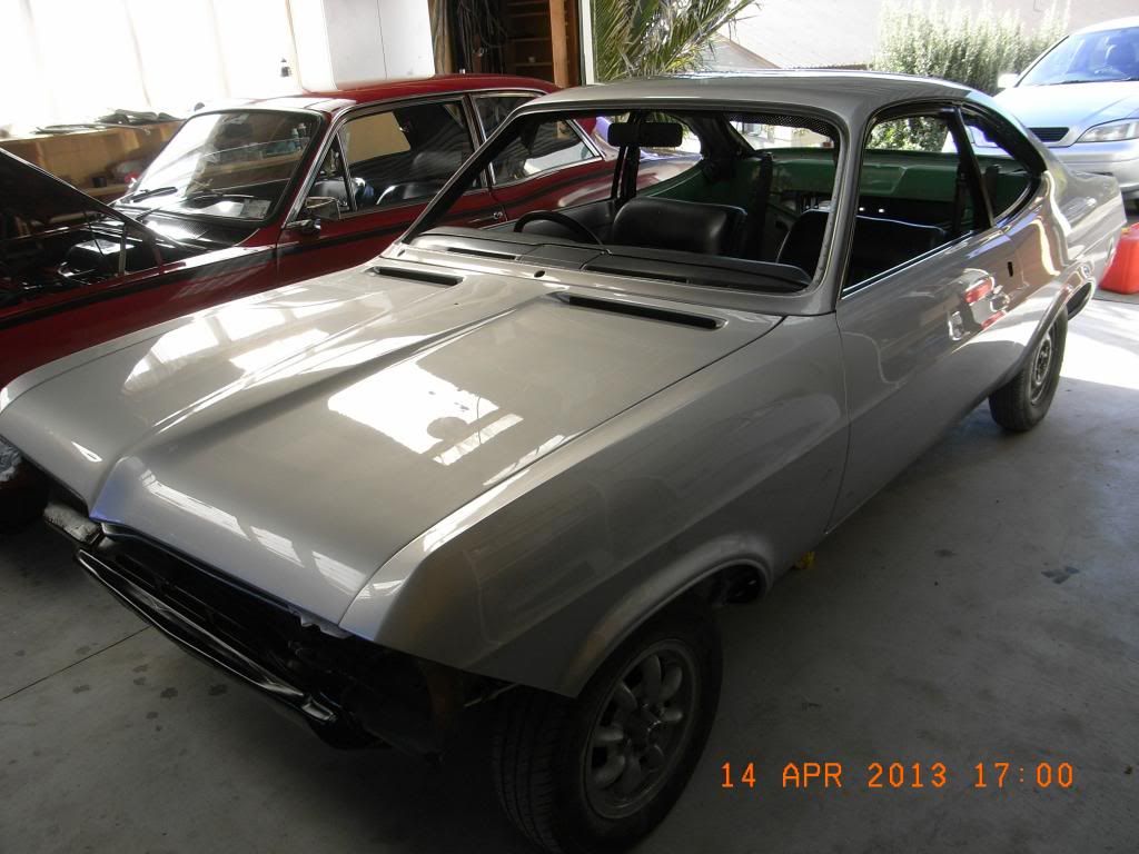

Quick pic update, progress has been slower than predicted but the old girl finally made it into the booth yesterday for a coat of "Spritzfiller". This is basically spray bog, gives a nice thick all-over coating which is easy to sand (half ends up on the floor) and smooths out all the lines.
After I have finished sanding this back it will be back in the hands of the painter for first primer coat.
I will likely remove the bonnet and bootlid this week so the undersides can be prepped, and door openings will be done at the same time.

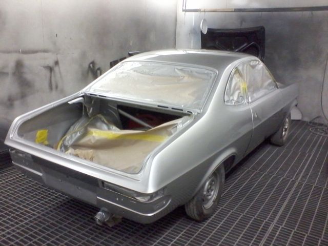

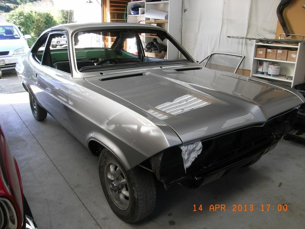

So 3 mths since my last post, slack bastard, but to be fair I have been out of the country for 1 month of that, and I have a note from my mother, so...

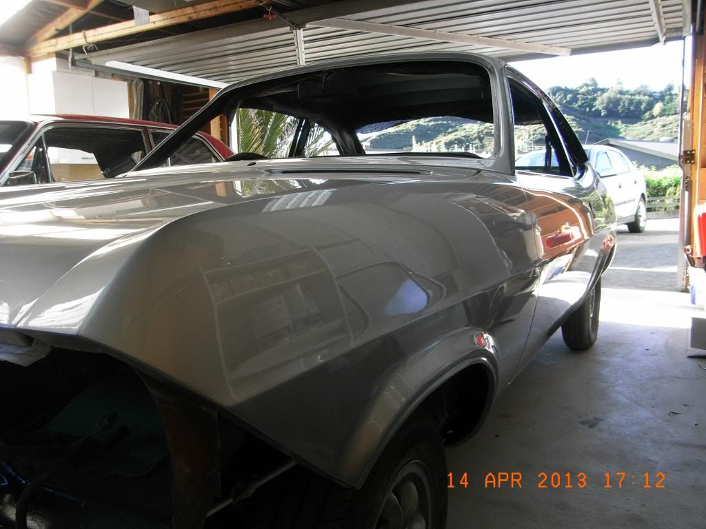

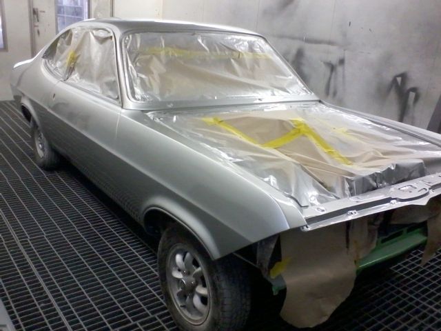

bit of a photo dump to show progress, main news..IT'S PAINTED!!
Now finally the fun part begins of putting it back together, which I have started doing over the last week or so.
Booth pics
Posted Image
Posted Image
Posted Image

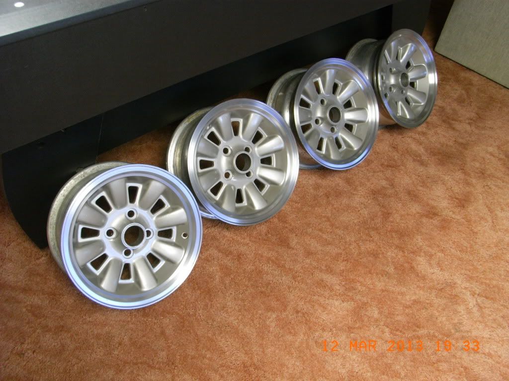

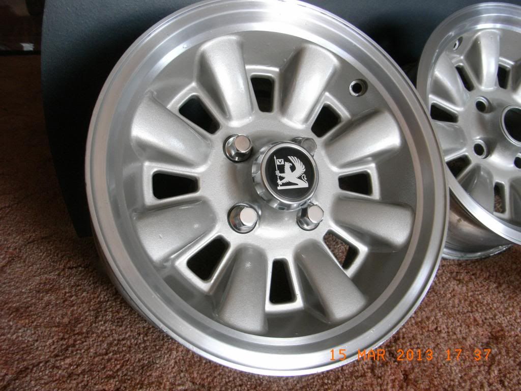

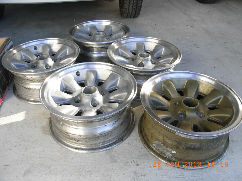

I had the rims spun to clean up the lips..
Posted Image
and the painted them...
Posted Image
and with the shiney bits on...

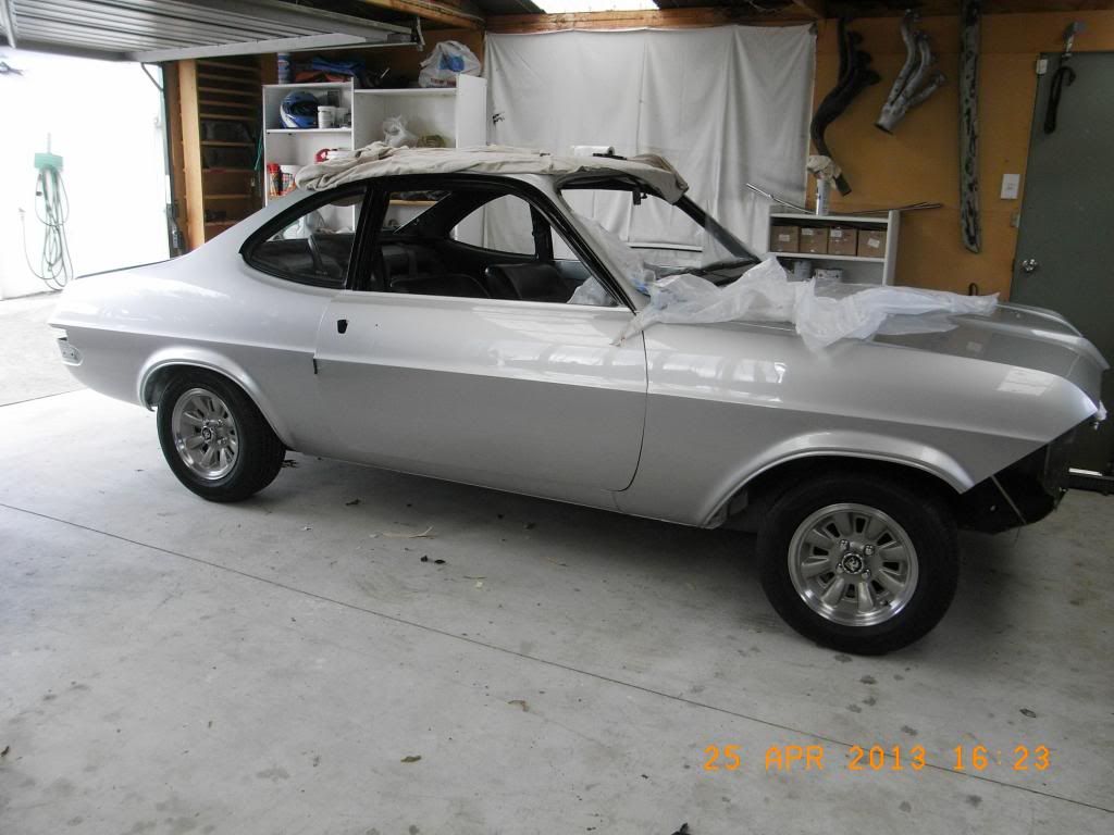

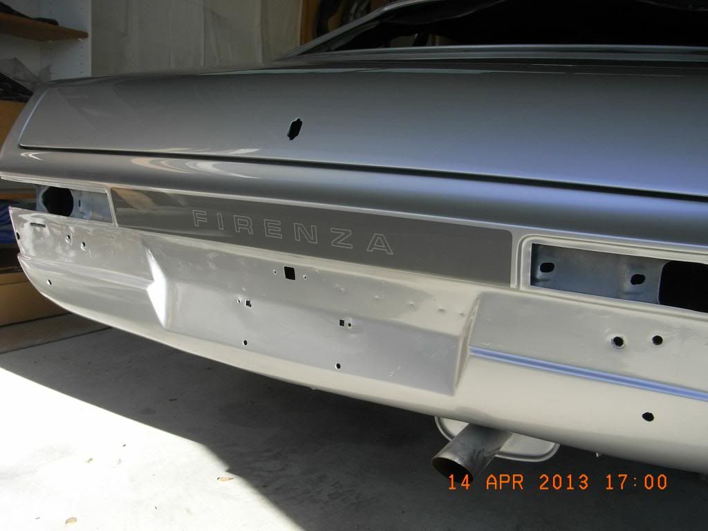

The painter was a good bugger and dropped the car back at the house for me while I was away, so good to open the garage door to this!
Posted Image
I took a few shots to try and show off the finish but a bit tricky in confined space, will get some better shots outside soon.
Posted Image
Posted Image
Posted Image
Posted Image
Posted Image
No shots with the nosecone on yet as the painter is yet to finish that, I think he must like having it around...

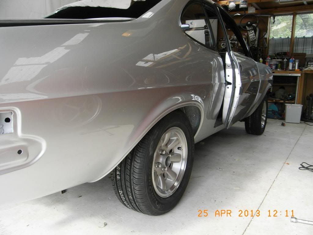

Today the rims finally went back on with new Hankook 205/60/13's. Love these wheels and make such a difference to the overall look of the car.
Posted Image
Posted Image

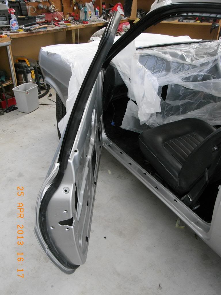

Today I installed the new door seals. There are no new ones being made for the Firenza's, but after a quick measure up of my HB GT it was obvious that the seals on that would work ok on the Firenza, which are being remade thanks to the Aussie HB Torana's having spares coming online. The top part of the door frame is perfect fit, but the pins for the bottom half didn't line up at all except for maybe 2 or 3. It's an easy task though to move these by adding holes in the rubber in the right spot to suit the door. I used a soldering iron to burn a nice clean hole, much less chance of the hole tearing when inserting the pins this way over trying to cut a hole.
Anyway, that job's done, the doors are tight on the opening but will get better as they wear in.
Posted Image

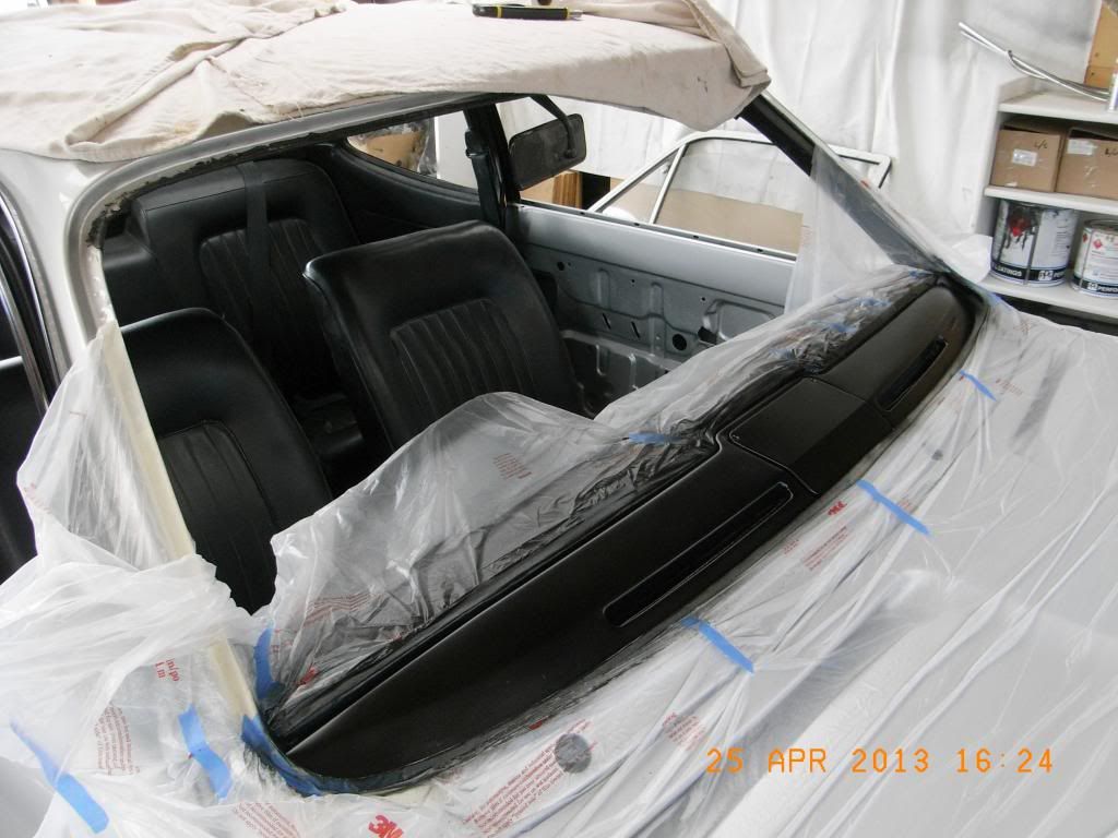

Also re-painted the metal top of the dash today in preperation for re-installing the front windscreen this weekend. Much easier to do now!
Posted Image
