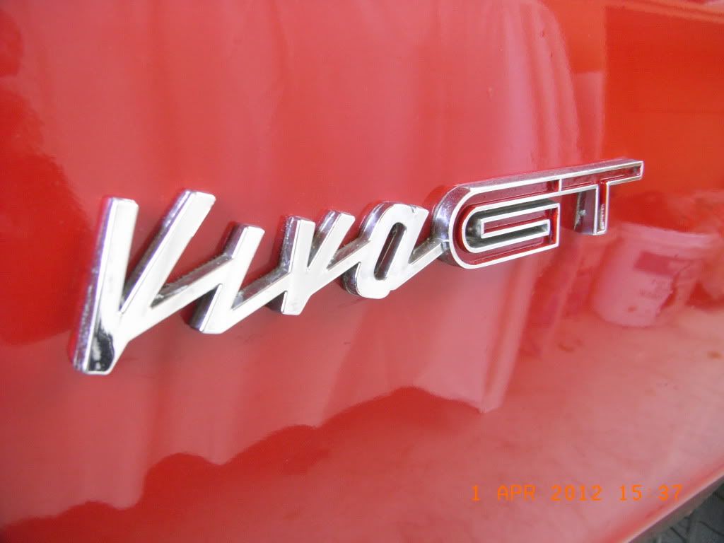

Hello all, new on here after much needling by yoeddy, will try and post some pics of my Viva. Cheers.
Discussion here: viewtopic.php?f=18&t=33554
Posted Image
Posted Image
Posted Image
Posted Image
Posted Image
