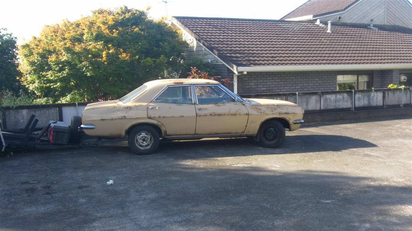

well picked up the donor car, a 3.3l victor with a 4 speed and over drive,
managed to get pulled over with in 30second of my test drive of the car, $300 fine thank you,
put the car on the trailer and got back to new plymouth safely
the body on the victor is surprisingly good,
some surface rust which has been rust treated (which makes the car look like shit)
according to all the paper work that i got with the car (from the 3 previous owners) it looks like the car has done an original 53000 miles, and was parked up in the late 70's so the rust is from just sittng,
i think the victor will make a good v8 donor car,
i'll do the velox first!!!!
pics in a bit :D
...........merc camper.....................................vauxhall velox.......................... vespa (1)50.........
build.....................discussion     build..................................discussion.....build and discussion

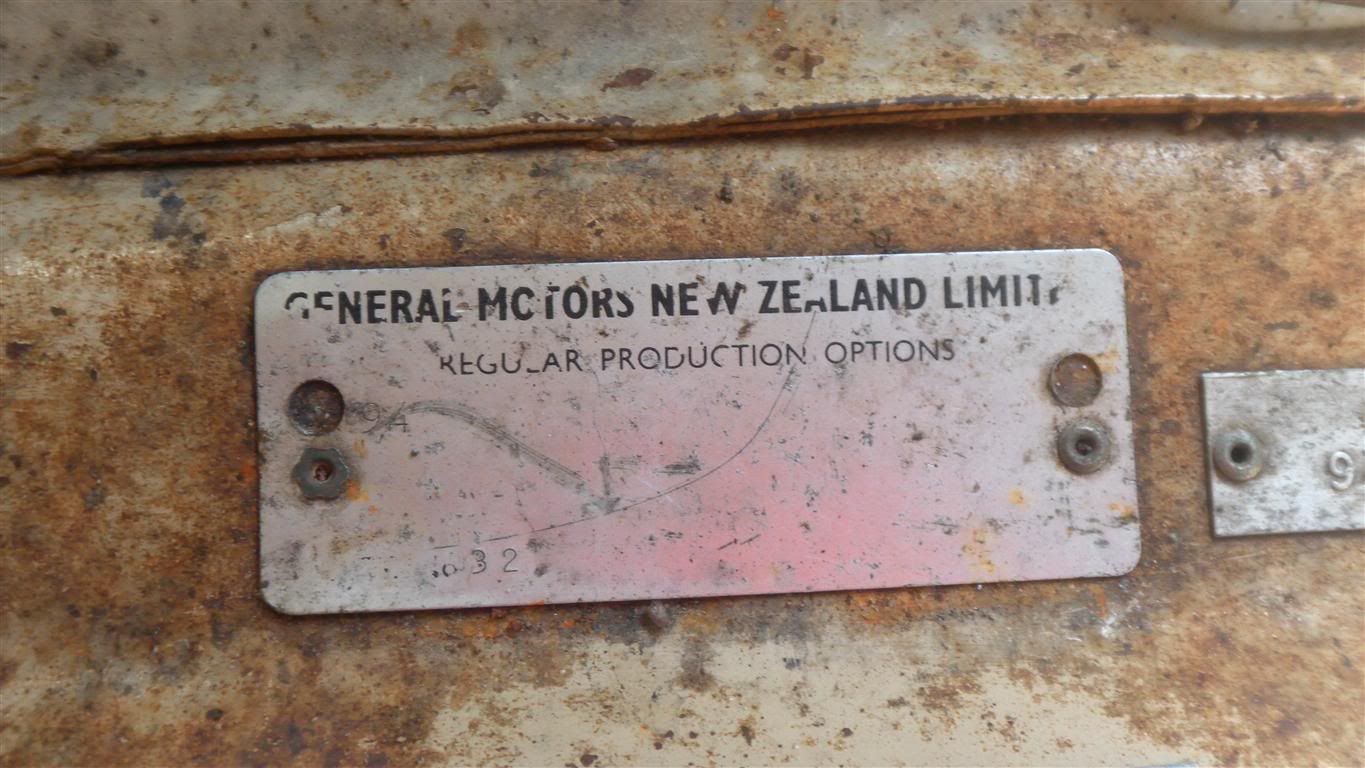

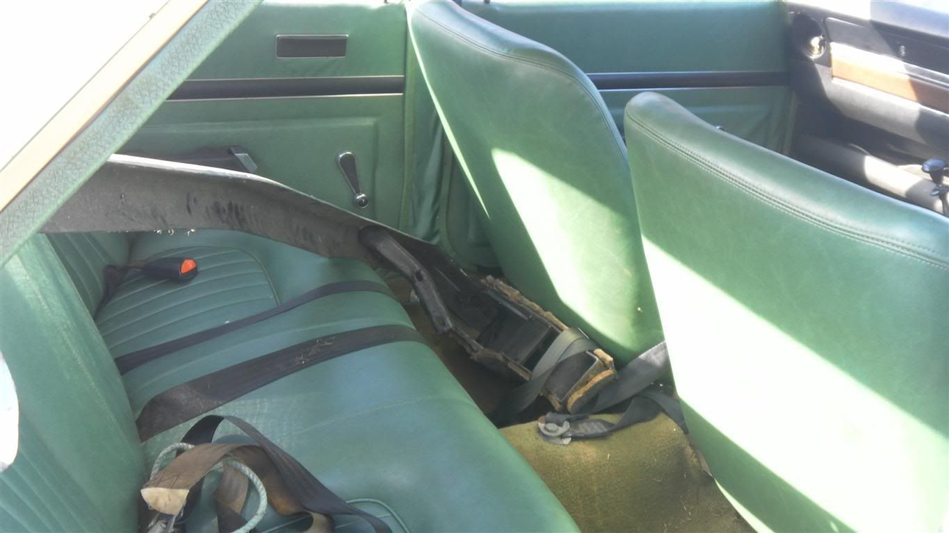

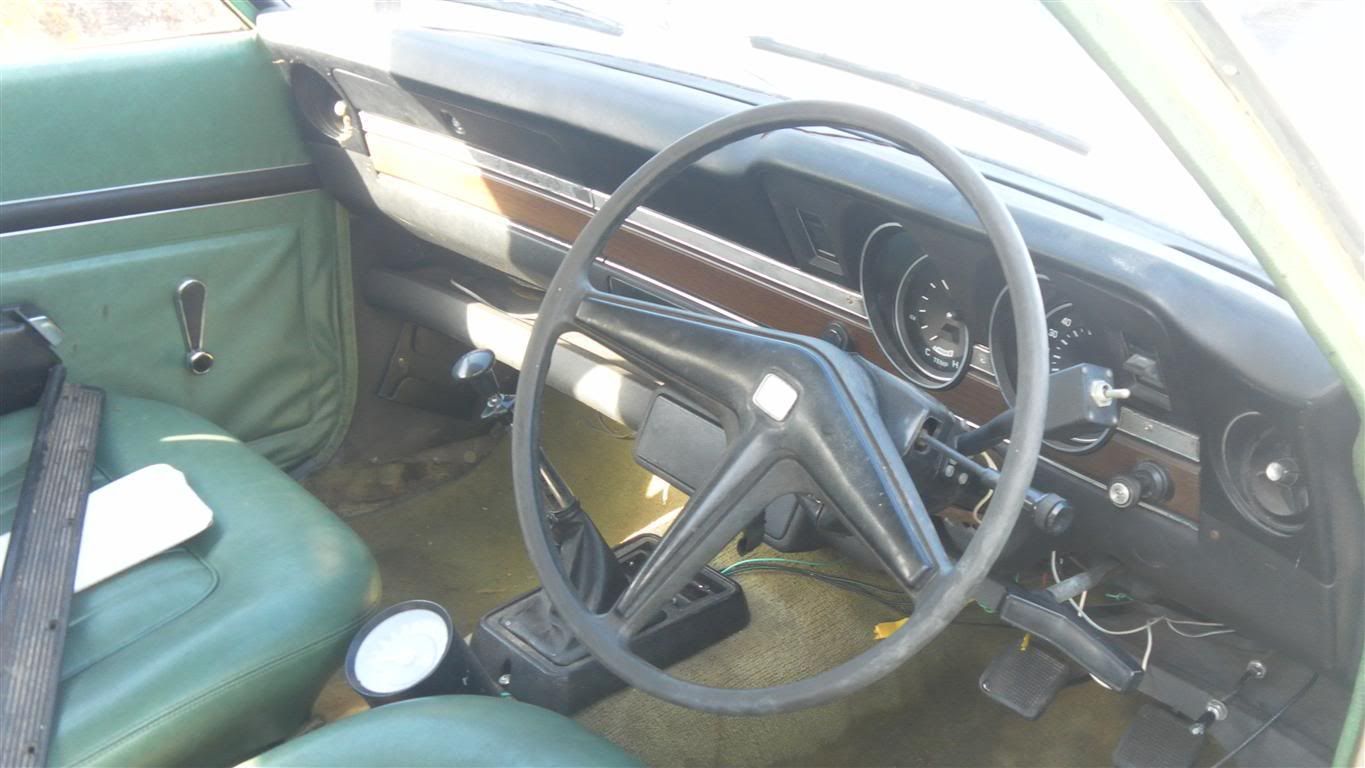

#15 hmmmnz
hmmmnz
    Advanced Member
  • Members
  • PipPipPip
  • 200 posts
Posted 19 February 2012 - 06:06 PM
ok some pics
cream and green ... always a good combo :D
Posted Image
Posted Image
Posted Image
Posted Image
looks like it was a nz assembled version.
Posted Image
although every thing is all imperial. i thought we were metric by then.

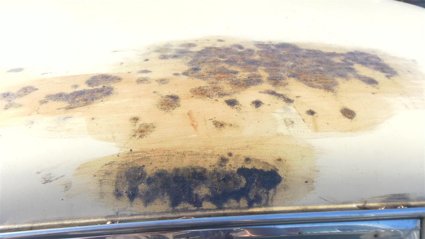

here is the general state of the rust
Posted Image
as you can see, its just surface rust, but with a rust killer on it, which makes it look far worse,
the only place where there is a rust hole, is on the back winscreen sill,
pretty easy fix really, every where else is rust fee i use that term loosely) but in over all reasonable condition,
a lick of paint and it'd be a new car
