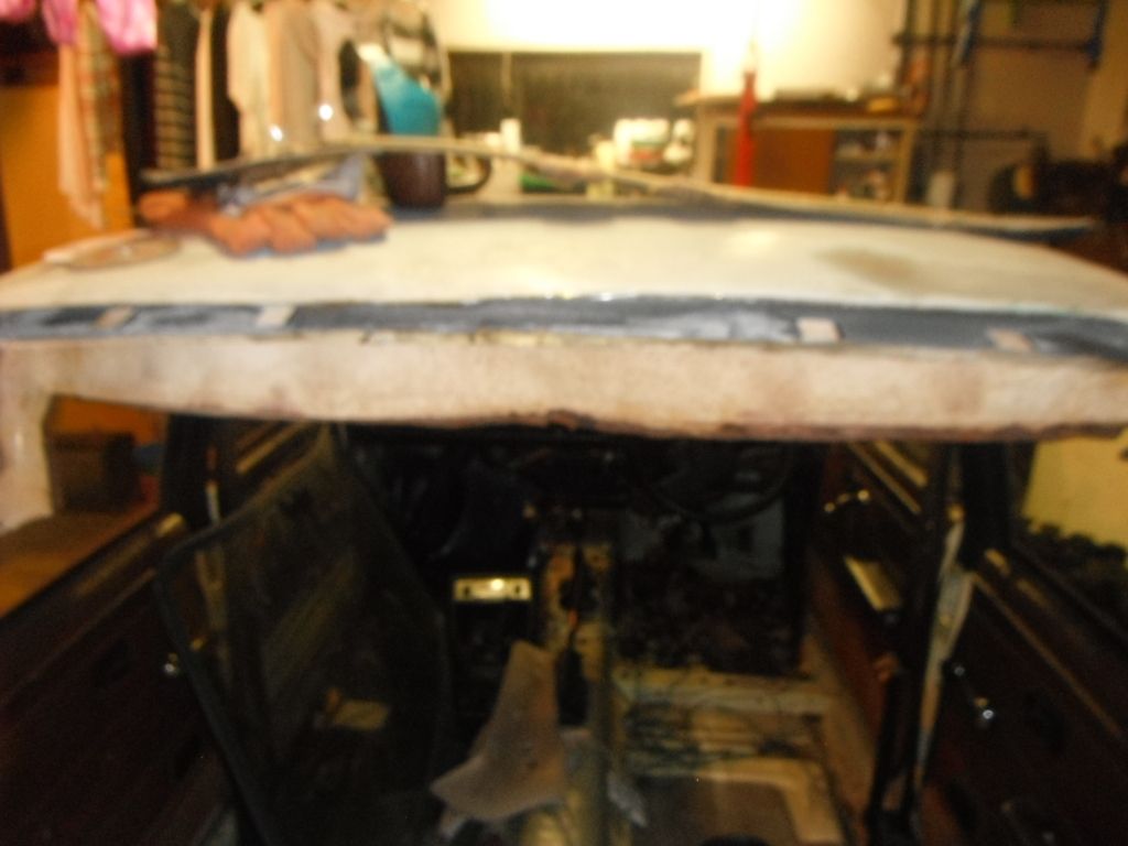

Also took off the poos Ghia vinyl roof to reveal a few dents and it smelled like shit. Its got some dents but only small minor ones
Posted Image
Posted Image

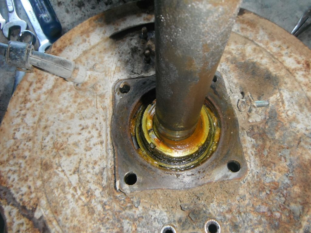

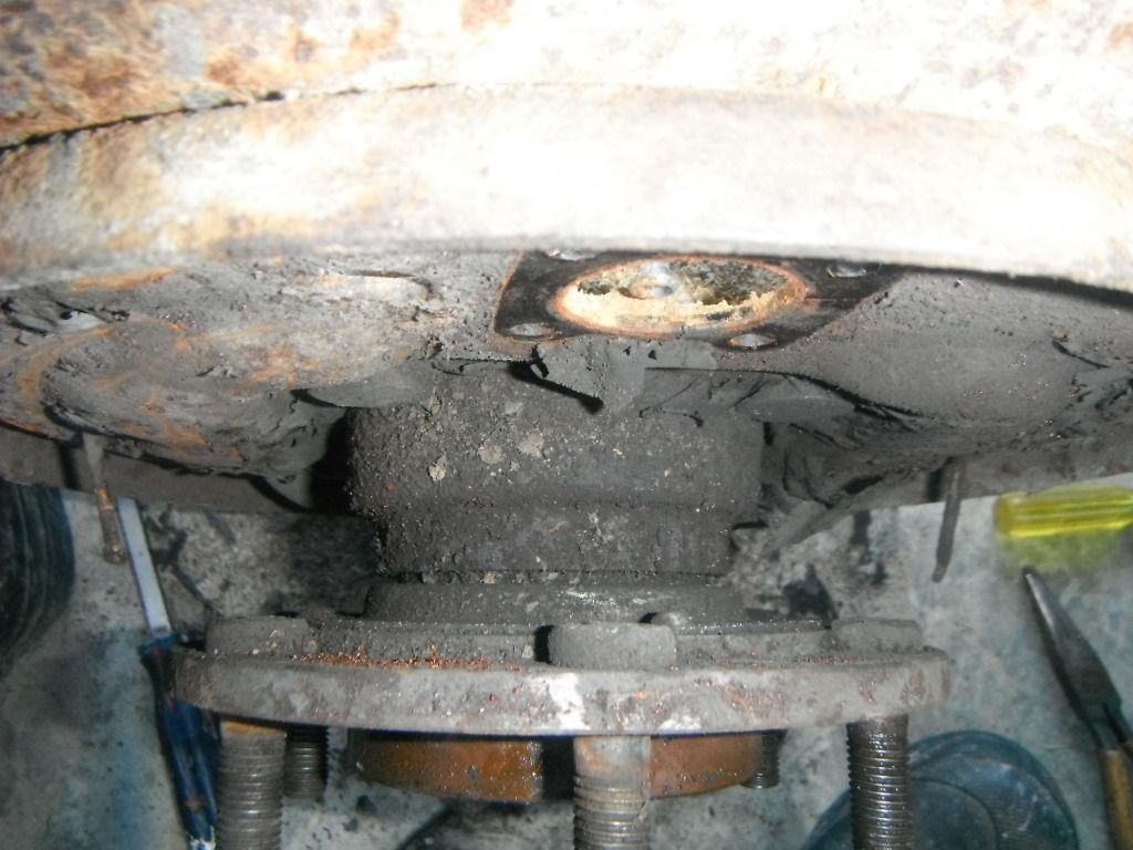

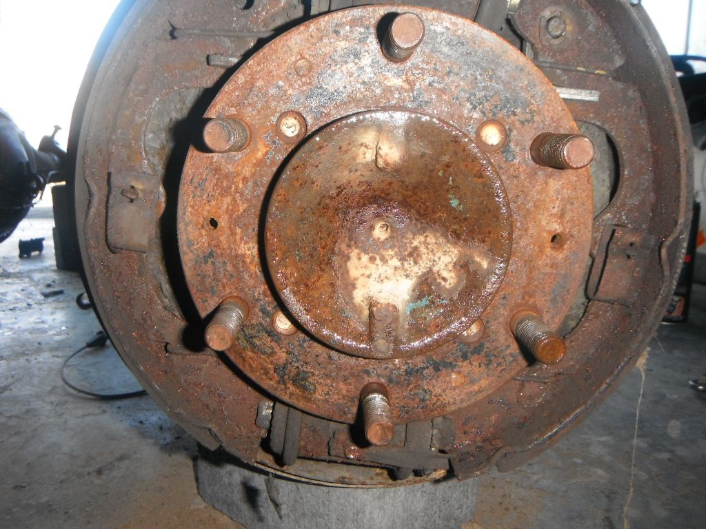

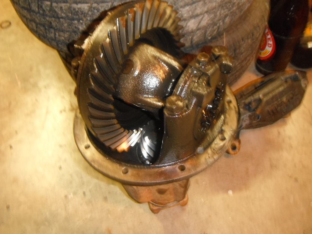

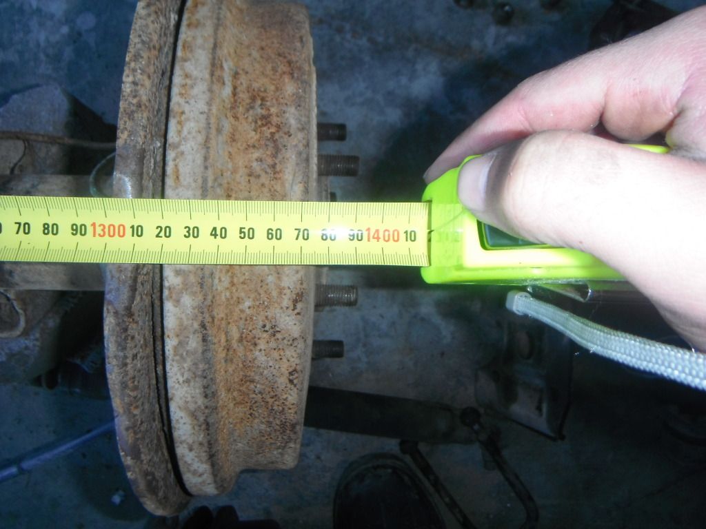

Right so ive been taking apart my b1600/Courier diff to be pleasantly surprised. I intent to do a write up of the diff change and comparison with the escort diff as its a really good change/alternative to the hilux.
First: Its nearly exactly the same length as the standard escort english live axle
Posted Image
Escort:
Posted Image
Courier/B1600
Posted Image
Also as you can see the 4 stud pattern is actually 4x108/110 just need to get the hub machined down.
Posted Image

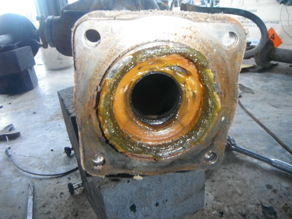

Also it has a semi floating hub setup which helps carry the weight of the vehicle on the axle shaft itself. And its held in packed grease!
Posted Image
Posted Image
Posted Image
Also has a diff head that reminds me of a hilux its massive! Pity its a 4.8 ratio :/ But it does have 31 spline axles which are very meaty
Posted Image

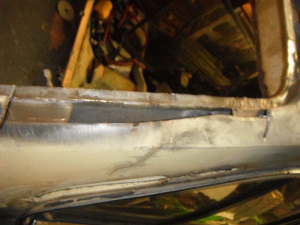

Also the Escort is now rust free!.... For now
Rust cut out in the spare wheel well
Posted Image
Rust cut out above the rear window seal
Posted Image
Last piece of rust cut out right hand side of the rear windshield
Posted Image

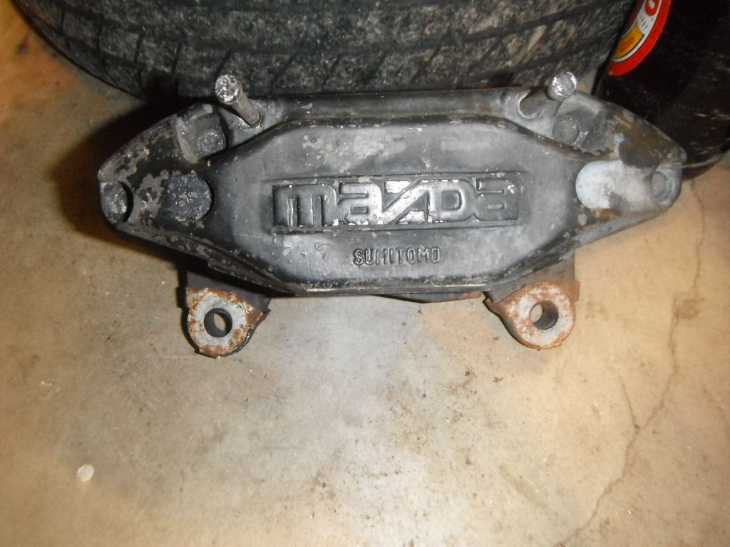

4)Also bought some AP 4pot calipers from an Austin princess with new stainless steel pistons and seal kits, should be here soon enough!

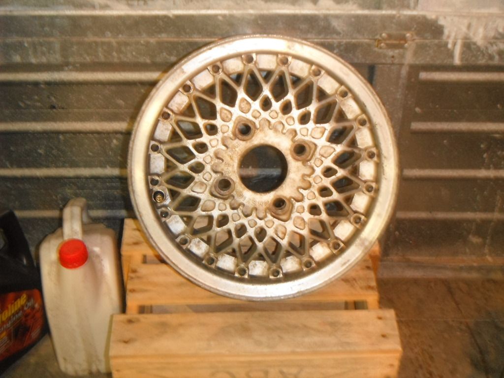

These beauties of 70's racing pedigree arrived
Posted Image
And i managed to get some original mint bathurst globes 14x6 for a small sum!

Wow so back for the weekend, thought id get into it!
So finished the bellhousing conversion from the courier box to the Mx5 box!
DSCF0653_zps60b815e8.jpgNow to sort the clutch combo.
Im thinking an FE SOHC clutch or an F2T clutch? Opinions?
And one of the things im really loving at the moment! My modified KIA sportage cam cover to look like a BDA/BDG cam cover, will wrinkle it up tomorrow.
