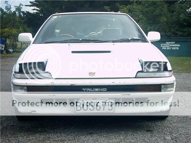

so I thought I may aswell put a project thread up . I swapped the car for my ae85 that i had it was stock as a rock on steelies
Posted Image
Posted Image
Posted Image
Posted Image

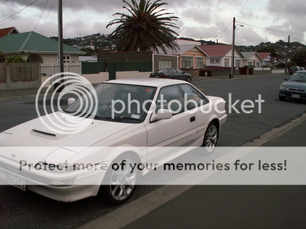

then i was like oh ill go get some 17s because big wheels are cool ( i know better now )
Posted Image
Posted Image

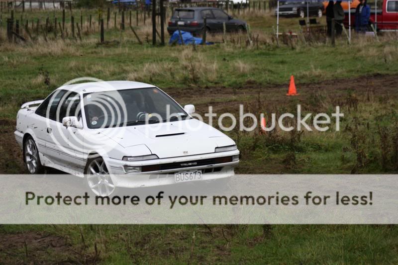

did a few events with it pretty much stock
Posted Image
Posted Image
Posted Image

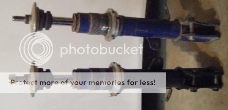

then i started fiddling with suspension by chucking a set of trd coilovers in the back with some 4kg springs
Posted Image
Posted Image

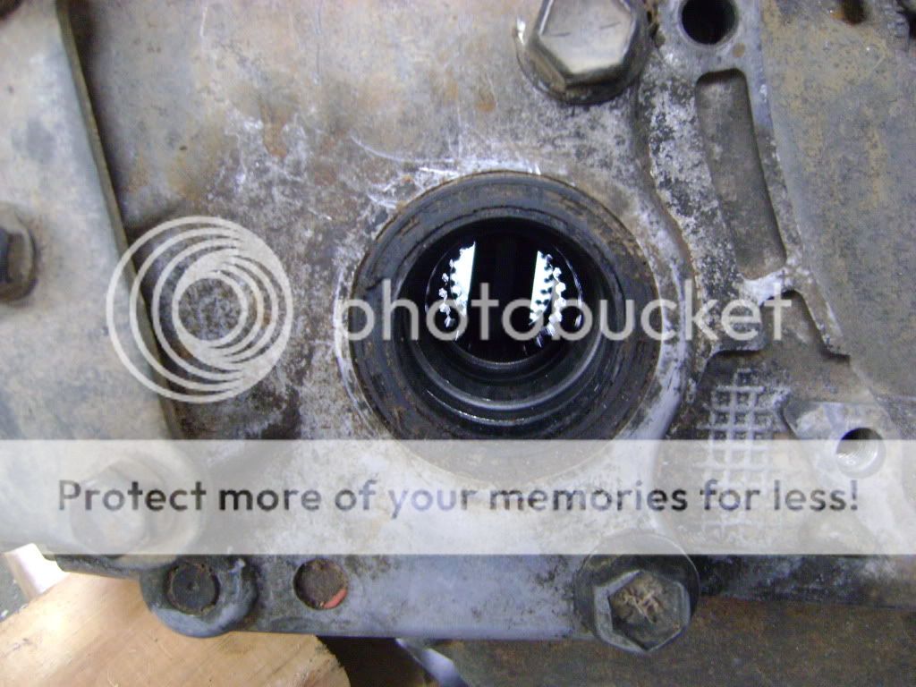

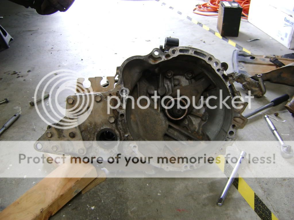

then i got really sick of having a 1 wheeler peeler and single spinning everywhere so in went the ae101 lsd box and driveshafts
Posted Image
Posted Image

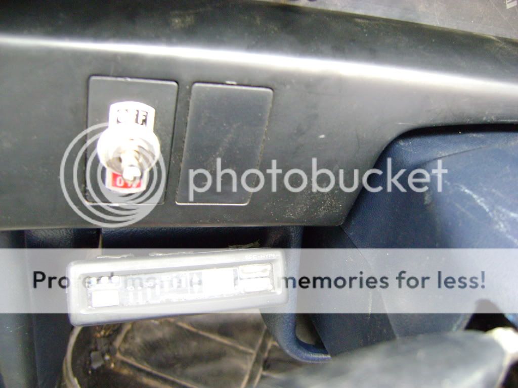

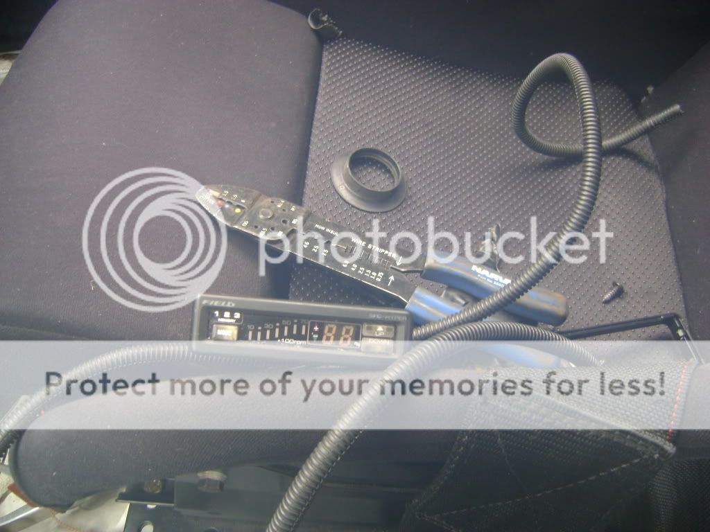

wiring was a bit of a mess behind the dash
Posted Image

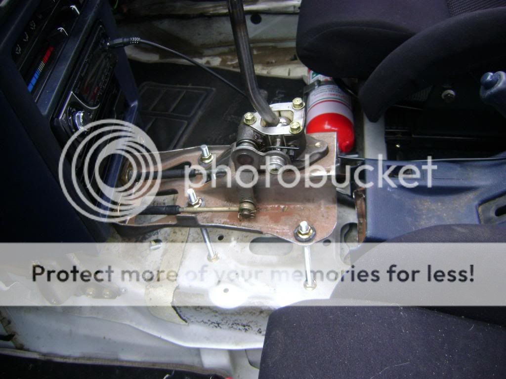

raised the gear shift up with just some threaded rod

got some front coilovers in
Posted Image

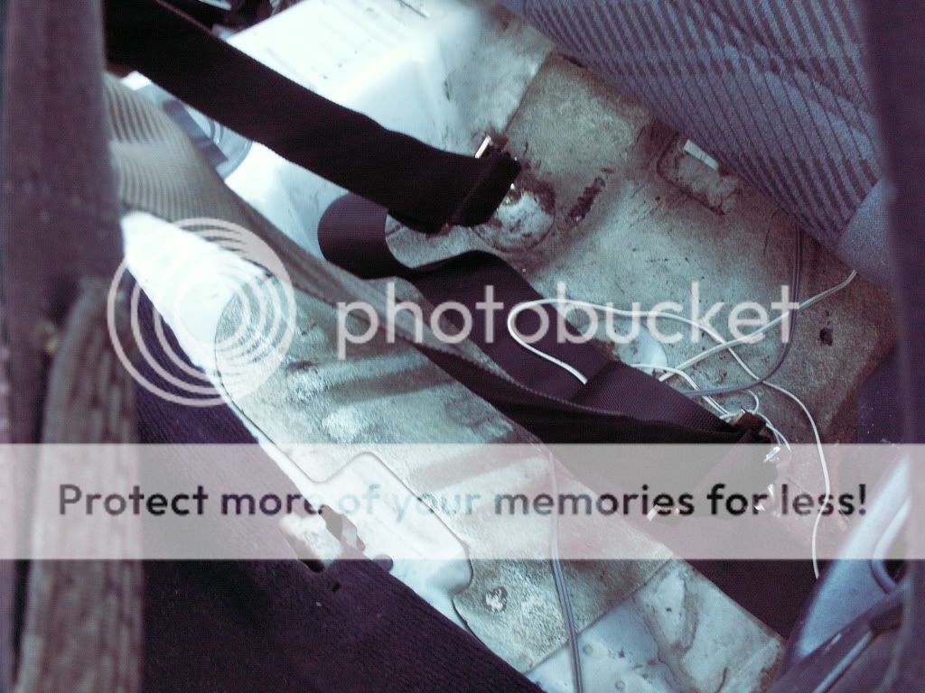

havent really done anything to it lately intsalled some toms harness pads and a windscreen banner
Posted Image
oh and its moved into a new workshop with UJ maybe ill get round to doing those jobs ive been putting off due to not having a welder ect
