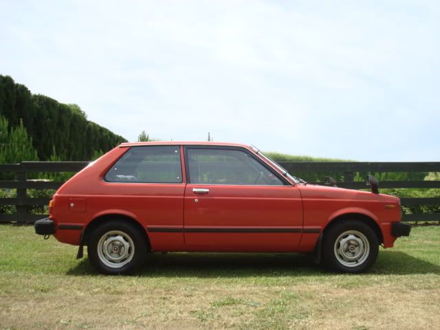

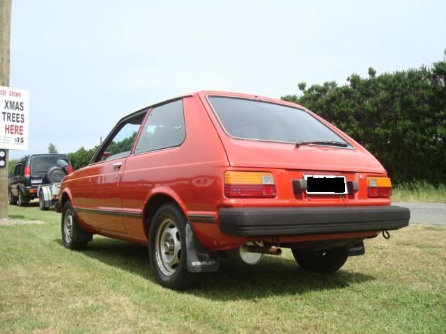

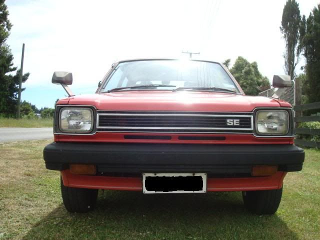

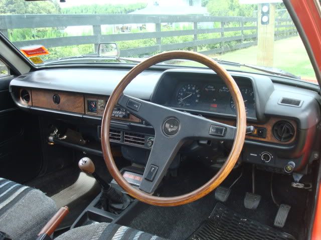

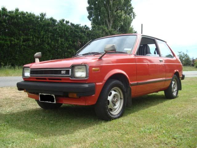

So i bought another one, Its a 1982 kp61 se. Im going to pull all the good parts off my kp60 and put them onto this, then sell the kp60.
