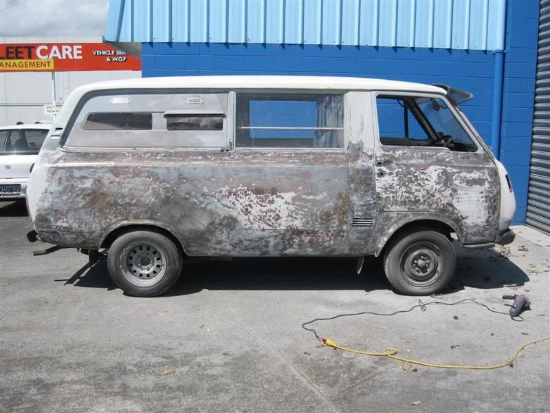

Started chipping off bog from the side of the van and found a big dent. And LOTS of bog.

started working on the subaru today but got bored pretty quickly and started exploring under the hiace paint.
seems the whole lower drivers side has had a lot of damage, there is (was) a pretty thick layer of bog:
Posted Image
and I also found a couple of nice body panel joins, which explains why there was something that didn't look quite right before.
Posted Image

[*:2qz64y7q]Fixing rust and painting.
Plan is some sort of slick two tone ensemble. Can't quite decide but it will either be grey, white, or tan and maybe some sort of red.
Will probably just do the rust part and leave the paint till later. Will rock primer/bare metal for labour weekend.
