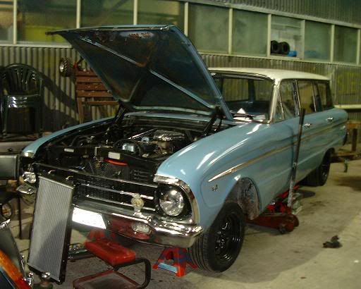

my XM falcon wagon:
- x-flow 4.1
- C4 box, recently changed to column from nasty floor shift
- 14" valiant rims, steel of course, 185/55s
- lowered on compressed coils and blocks, ass is still in the clouds at the mo
- XF disc brakes front, remote booster.
- XW (?.. not sure) diff and drums
- sounds, front & rear plus tweets and sub.. due for overhaul
- just got rid of 'noisy boy' exhaust cut, was great fun.
- elec. fan, the 4.1s too long for a fan with current radiator
- alloy jappa radiator waiting to go in
- more rust and crash repairs than original metal
plans are for ex-aircraft hydraulic suspension, though progress is slow.
thats all i can think of, here are some pics.. please excuse the photo quality, i only have access to average cameras and own a ford so i cant afford one of my own
as i bought it - wow nice cragars :oops:
Posted Image
as it sits now:
Posted Image
Posted Image
as it was: (*sigh*)
Posted Image
Posted Image
Posted Image
^^pesco hydraulic pump, ex DC3
chur!

dusted the hydro parts off and put together the final pump system setup, no sealant yet. new reservoir - old swedish propane bottle. theres a pair of grunty bus solenoids to switch the pump power too, jeah. such a drawn out project.

have taken drastic measures and started cutting etc for hydraulic gear install, she's sitting on lowered bumps in front, and on bumps in rear ie 10mm off frame rail. this gives me 20ish mm from gearbox x-member to ground with noone inside.
thus we have the conclusion i need to find another 25mm of lowerage. but happy at present. 8)

battery/electrics box, pump, valves, reservoir - all on rack to go in on top of wag fuel tank.

okay that big jumble of parts posted earlier have formed like voltron into my rear cylinder/arm assemblies ala:
Posted Image
view is from the rear of wag , Alloy bar is where the other arm will be, only showing left side.
grand total of weight added to car will be around fifty hundred million poundograms.

sucks how the guts hang lower than the sills. will need to put cans under sump or exhaust to achive full crush!
looks a tad lower from standing height of course but TBH on the bumps it looks about as low as CDL's crown on the tiny wheels. damn you slam friendly toyota
- reservoir finished at last, just need to add valve gear supports and mounting tags, then pump system is ready to throw in.
- made wedge shaped 1" blocks to add to new blocks shown above. pinion angle at full sack was atrocious due to gammy leaf setup.
- stroke limiters in rear rams, ie ready to flush and bolt in
- hydraulic hose guru booked for next week
- switches wired
- it started the other day - bonus/unusual
- tea strainer from japan city makes a perfect carb filter
