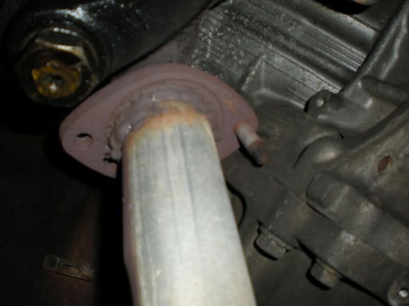

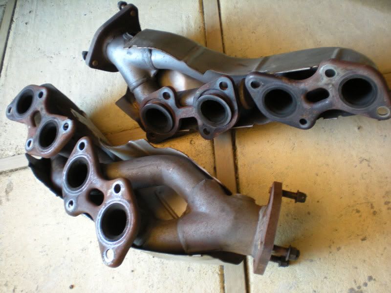

Got some new free flow headers that should fit. I've had a rogh measure up and look as thought they should fit in nice.
Posted Image
I gotta swap them with the headers with the existing ones that look like this..
Posted Image
The dude that put the engine in decided it would be a good idea to (badly) weld the exhaust to the headers. They've now got weak etc. and have holes n shit.

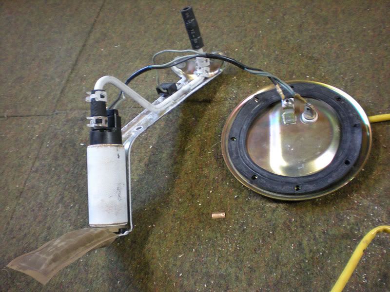

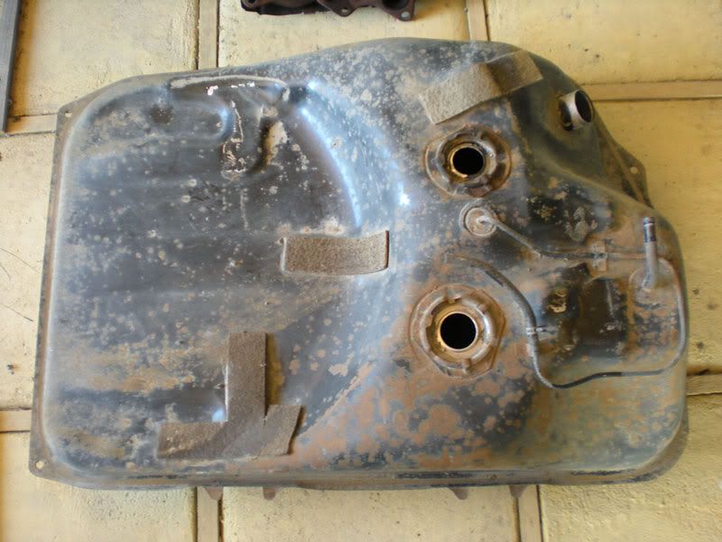

I now have a spare gastank that I'm going to get cut open so I can get my soarer 1uz fuel pump in there so there won't be no mega annoying external fuel pump noise no more.
Posted Image
Posted Image
Anyone else done anything like this before?
So plan is to take engine out one weekend, swap the headers over, take car to some GC that can make up a sweet exhaust in similar style to simon's (uterus) soarer and get some boso ends made up like the above post. Going to also swap the leaky steering box with a spare I have at same time. Will hopefully have new gas tank ready to swap over too.

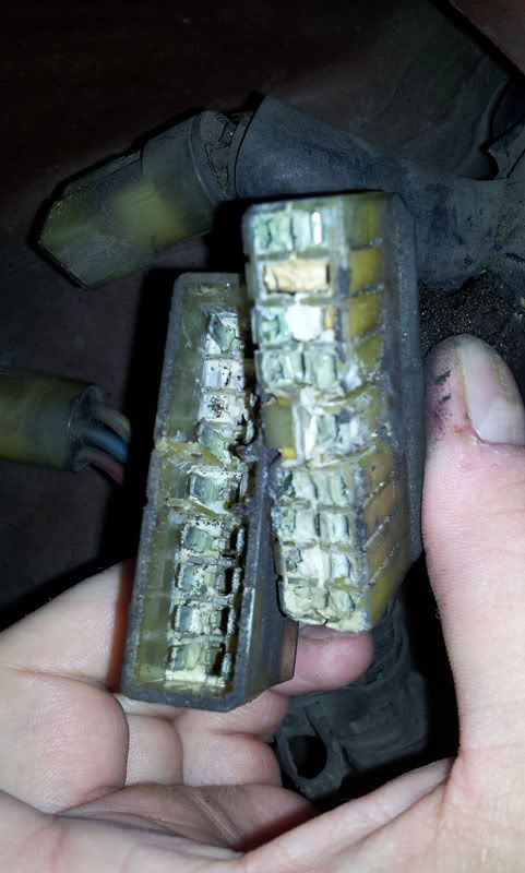

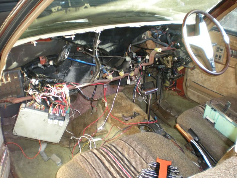

Dived into the car today with my trusty multimeter to work out why the dash fan wasn't getting power. Traced it back to some plugs mounted either side of the engine bay..
Posted Image
So got 2x 18pin plugs to cut and swap over. Anyone know where I can easily get them from? Jaycar?

* Changed over those massive plugs and now there's no drop in voltage on the other side. High five!
* Got that fuel pump stuck in only to find it's pumping piss all fuel to the engine - voltage at the fuel pump plug is 12v, then drops to approx 6v after it's plugged in. Guessing it's a fucked pump so am thinking of getting Walbro pump (which is what I shoulda done all along..)
And I've done some other fixes like cosmetic things eg. make some dents less obvious.. Then have also stood and stare at it with a beer thinking if I can be bothered sanding the whole thing back, getting rid of rust, bogging it all up and paint it..
Will update when I have the pump going! chur

New fuel pump installed and working! Shit me I'm lovin this thing again. Time for WOF. Wish me luck ladies
