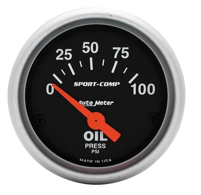

Autogauge 3 1/4" tachometer
Autogauge 2" boost gauge
Autogauge 2" oil pressure gauge
Autogauge 2" water temperature gauge
(all mounted in gearbox console)
