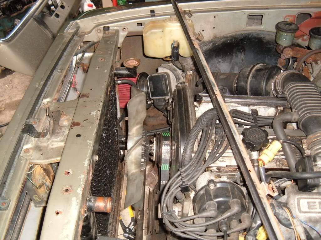

Various bits I've had to do is modify the alternator pulley to fit my Bosch alternator on, hunt down a longer fan belt to fit it (why the the fuck does it need a 7 ribbed belt???), sus out the shitload of wires and narrow it down to the ones I need, find places to mount all the electrics and so on and so forth (too hot to type, get off my back!)

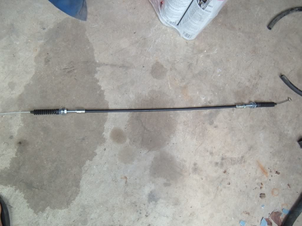

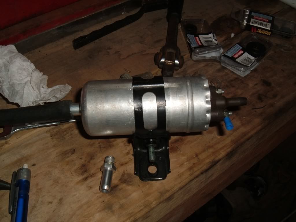

Got a new accelerator cable made up, ideally it could have been a few cm longer but too bad
Posted Image

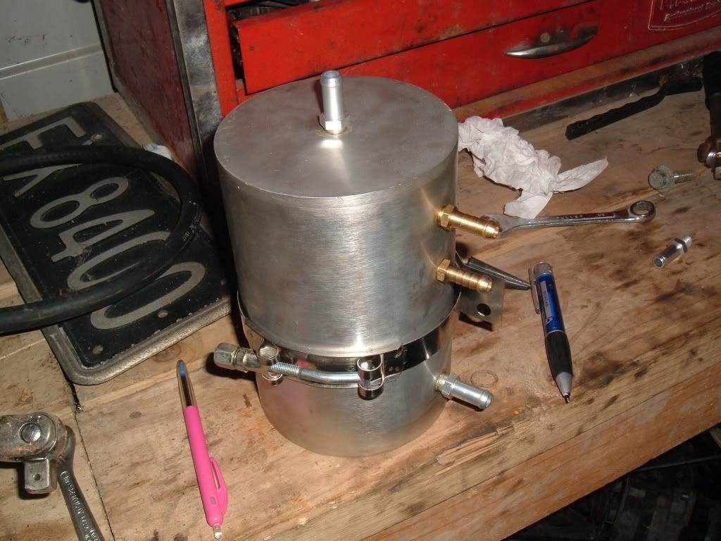

Surge tank and fuel pump (yet to be installed)
Posted Image
Posted Image

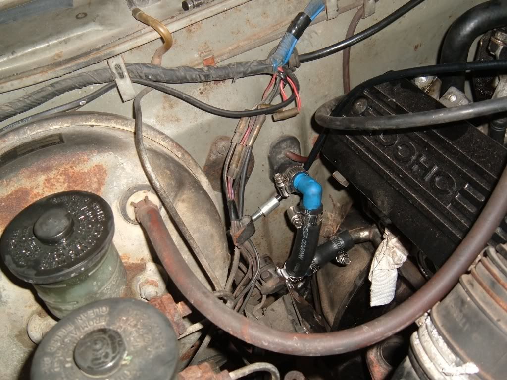

The heater hose was a bit of a bastard to pipe up, so I had to find some elbow bends (took me ages to find a place that sold them). This is the result.
Posted Image
Posted Image
8 more places to leak from! Woohoo!

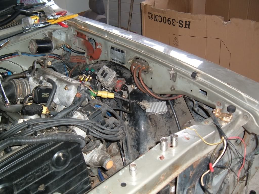

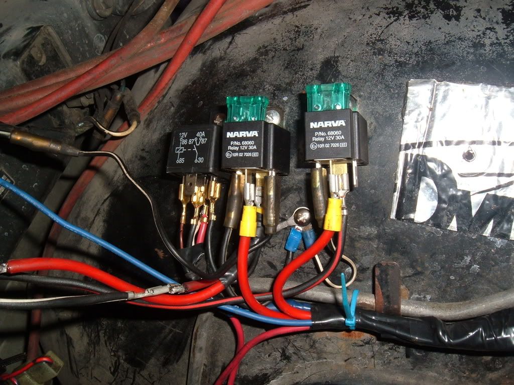

My rangitastic electrics mounted to the guard. I'm pretty confident I did it correctly, I'm just hoping the ECU agrees and doesn't mind that it's missing a few things.
Posted Image
Posted Image

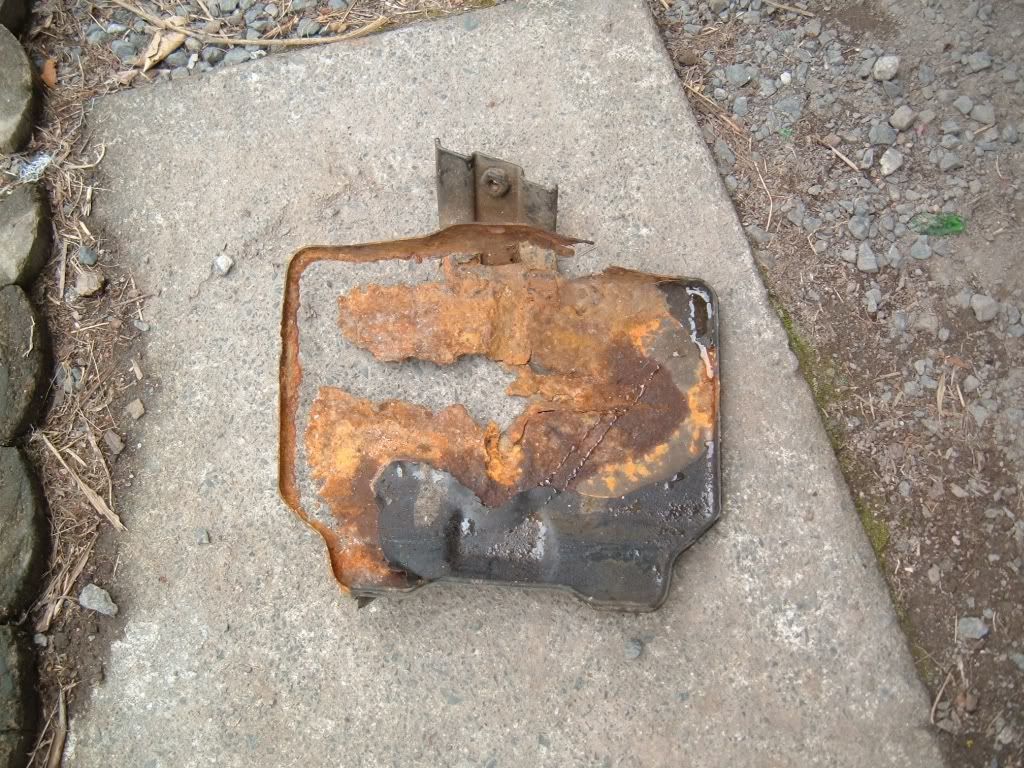

The remains of my battery stand. It's kinda fucked, but it still supports the battery. For now anyway :?
Posted Image
Posted Image
Posted Image
Posted Image
Posted Image

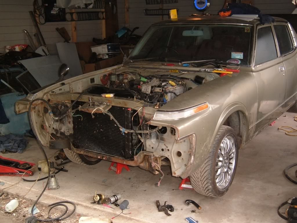

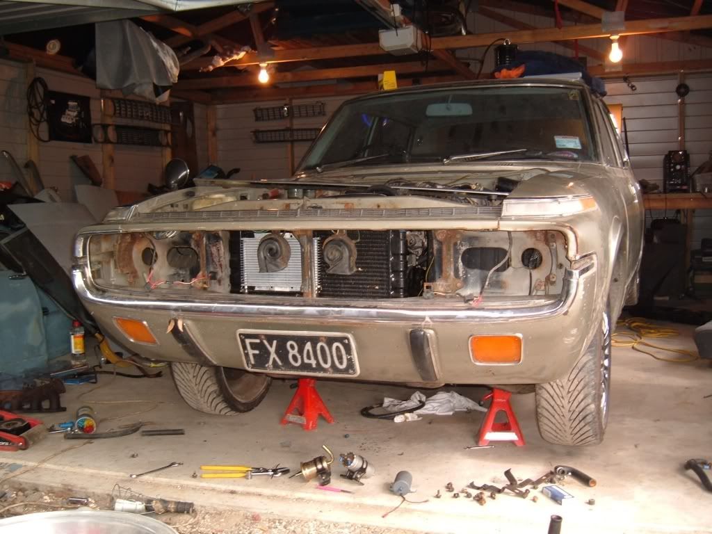

The fuel system is done, the tank is back in, headlights are on, the last of the electrics are sorted and the car is 99.6% complete.
Unfortunally, the last 0.4 % consists of a cracked thermostat housing and a cable mount. Oh well, there's still tomorrow. Still a few bits of trim / bumper that needs attaching too.
Posted Image
Cheap surge tank.
Posted Image
Yep, it's screwed to wood. Lushtastic MDF.
Posted Image
There it is, all piped up and ready to go. Just need fuel.
