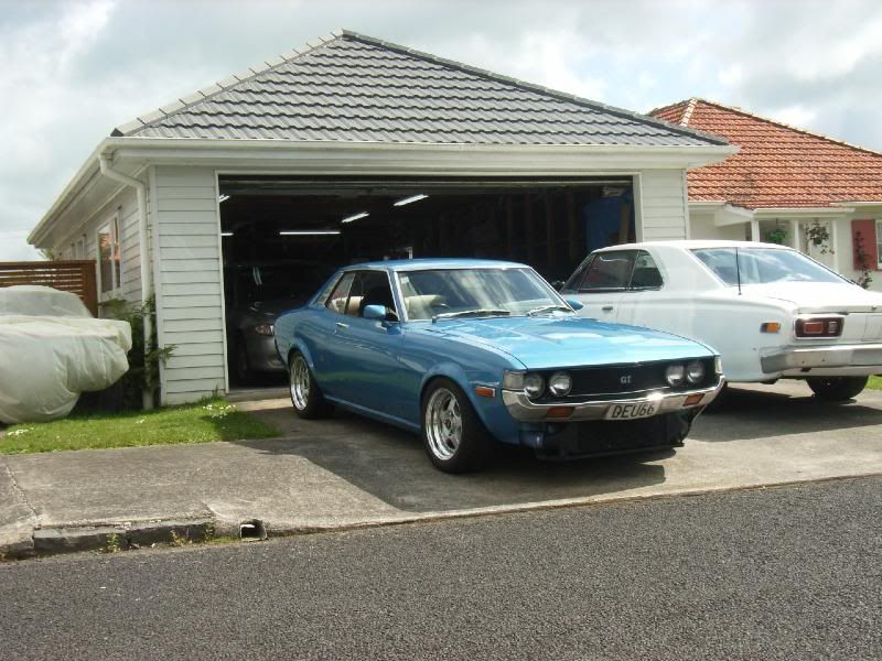

these are the only pics i have with it clean, still not polished yet so the paint is straight off the gun.
Posted Image
Posted Image
Posted Image
Posted Image
