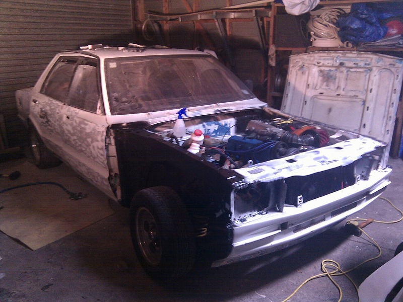

Here is my annual update:
Decided that before I moved out my last flat that I would give her the once over while I still had a double garage to work in.
Fixed the majority of the rust and sealed the usual areas with a coat of por15.
Dug out a shit load of suspect looking bog jobs/fixed surface rust beneath and redone.
Pulled off the rest of my fibreglassed on front lip (got munted putting car into a trailer once, putting mk5 sport one on instead)
Gave her a fresh lick of paint.
Turned to shit so sanded/flattened said fresh lick of paint off with 400 to make it look marginally better.
Moral of the story - Dont use paint which has been sitting on the shelf for 5 years as it WILL ruin all your hard prep work.

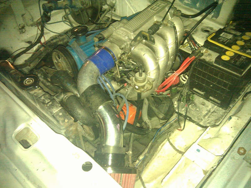

Pieced together a shiney intake pipe with old bits of piping
Posted Image

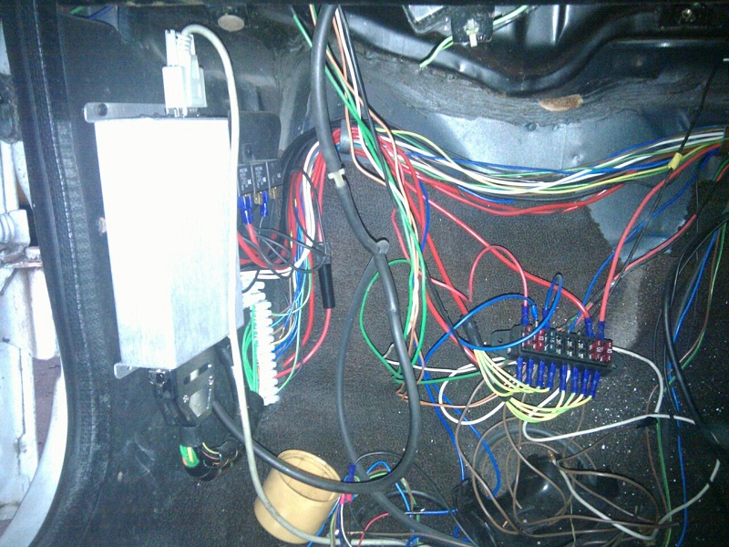

Finally got my act together to try get her tuned right with the megasquirt
-Replaced original fuel reg with a aftermarket adjustable one with guage
-Set fuel pressure lower than it probably was with old fuel reg (running vr4 450cc injectors which are a tad too large while im still NA so set fuel pressure @ 32psi so I could get a decent injector PW)
-Changed injector timing to 4 pulses/alternating rather than what was working best before 2 pulses/simulatenous (think i still might try 2 pulses/alternating and raising fuel pressure)
-Purchased TunerStudio to make use of their useful built in calculators as a good starting point (VE table and target afr)
-After much screwing around and recalibration of the wideband o2 sensor, took her for a drive while running VE analyse live and it seemed to do an awesome job and resulted in a pretty decent afr throughout the range.

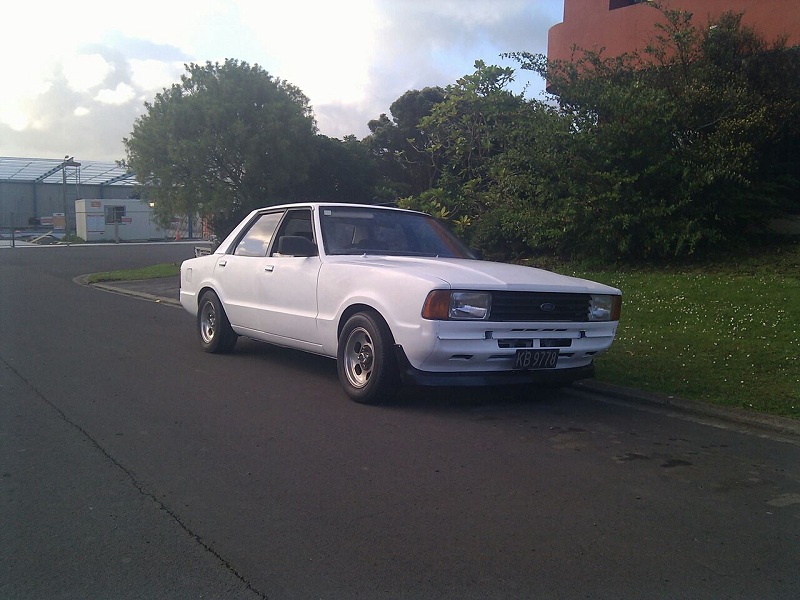

Get wof and put lower springs back in the front
Repaint or perhaps vinyl wrap
Drive it over summer like a boss
